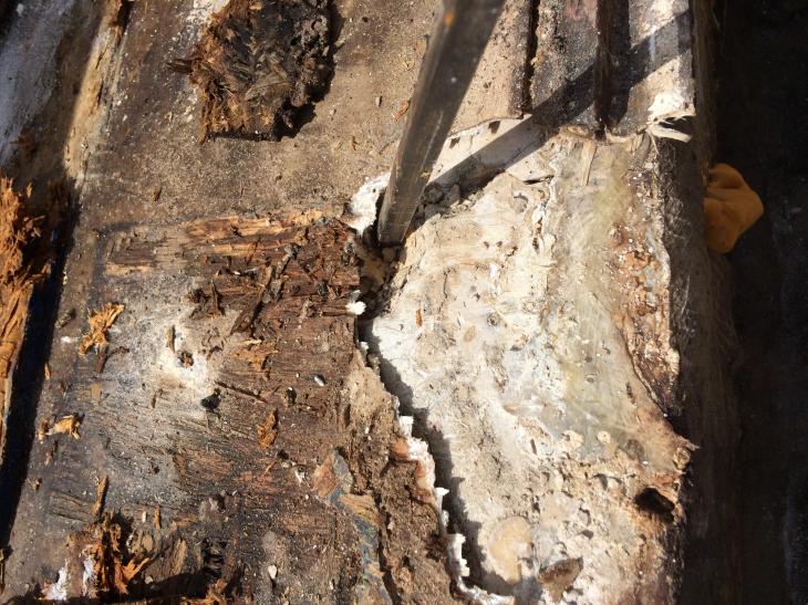

-I also cracked a Stringer and the sound is Comparable to Lightning
Hitting a tree. (Was Heading out of Boynton on a Rough day and Hit a wave the wrong way)
My theory on it was the amount of weight in the front and the back off the Boat along with bracket a merc 225 and a ridiculously thick transom, Ballyhoo
Box seat loaded with ice and myself, Coffin box in the front and Two fat boys.

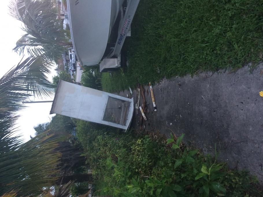

Good evening to all.

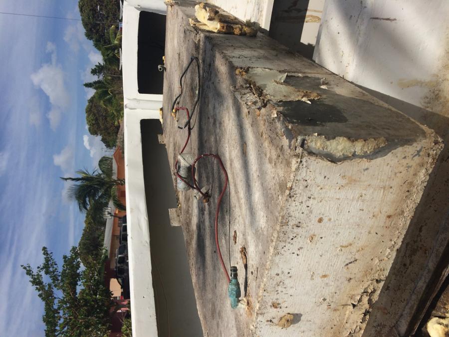

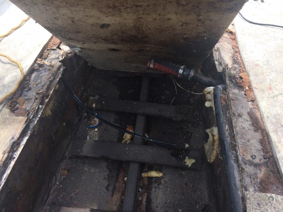

I got the tank out. As everyone can see the thickness
Of the old deck. I can't remember how many layers of matte and Biaxyl I installed quite a number of years ago but it was a lot! Lol

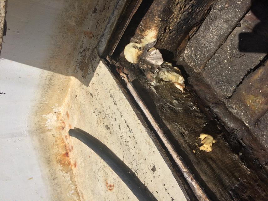

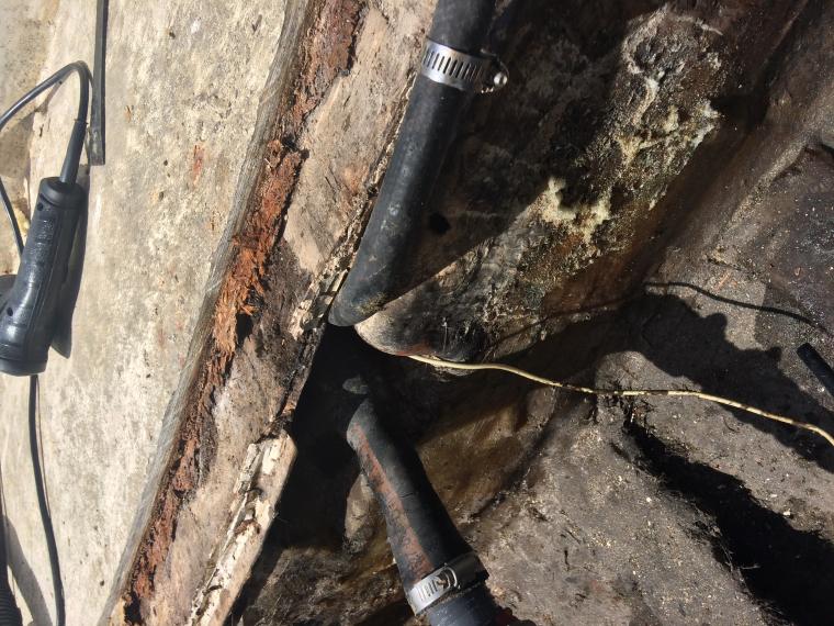

More Progress Photos

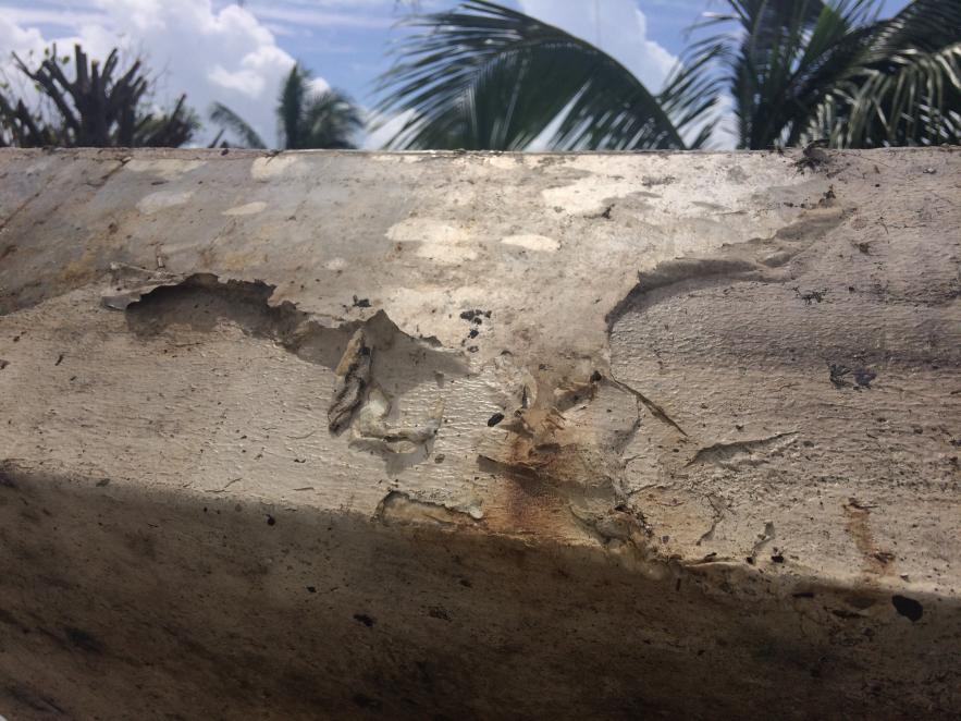

More Photos!!!!!!

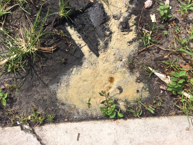

The green stuff is what was in my tank. The boat has sat for a few years now.
---No, I Did not empty my tank onto the ground. Lol
I emptied it into a drum and It got kicked over by accident..

Where I Cracked my stringer.

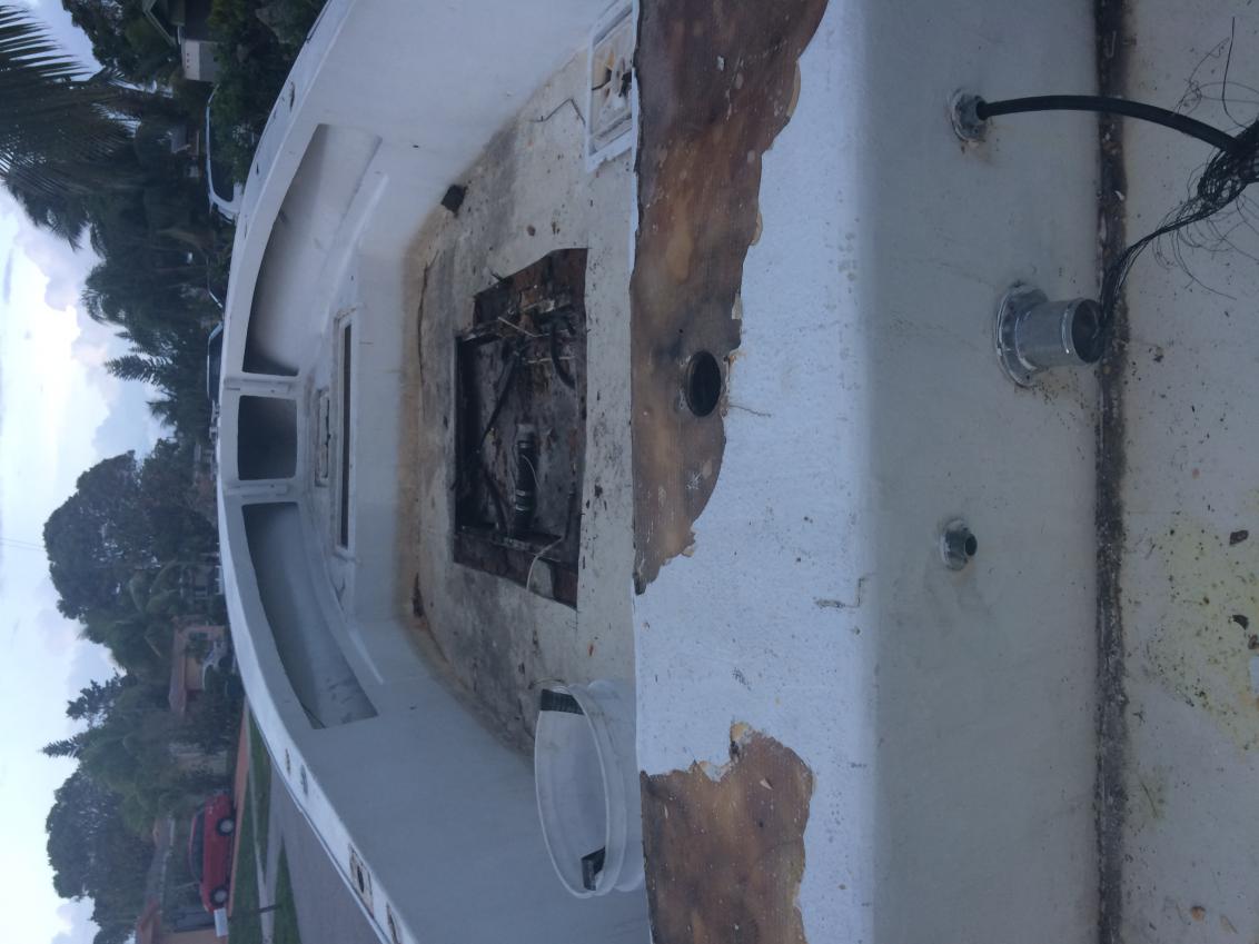

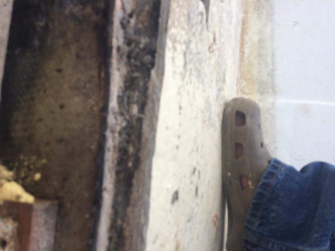

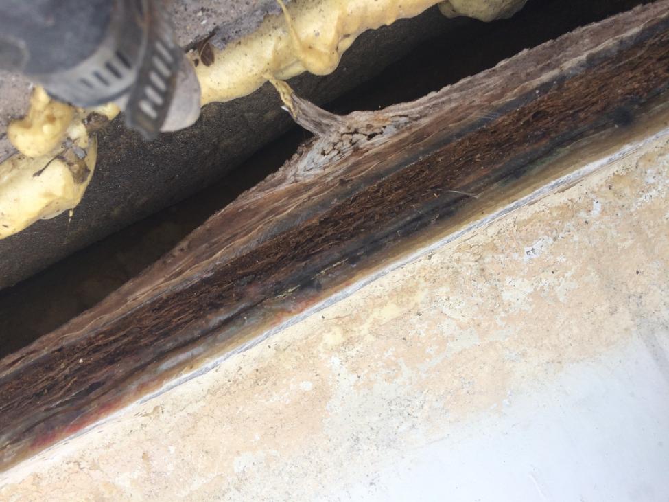

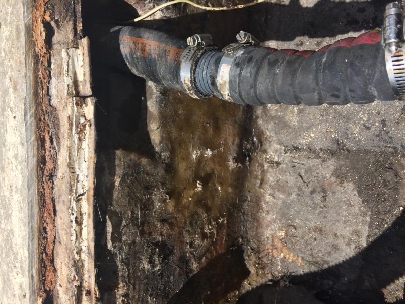

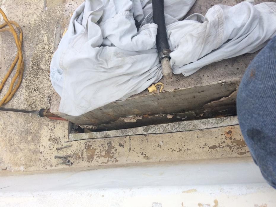

Top of Port stringer......
Got a break from the rain after a week of it...
-Started cutting decks and found the the top of my port stringer
About two foot back from casting deck was cracked and worn away...
-Foam was surprisingly dry.
