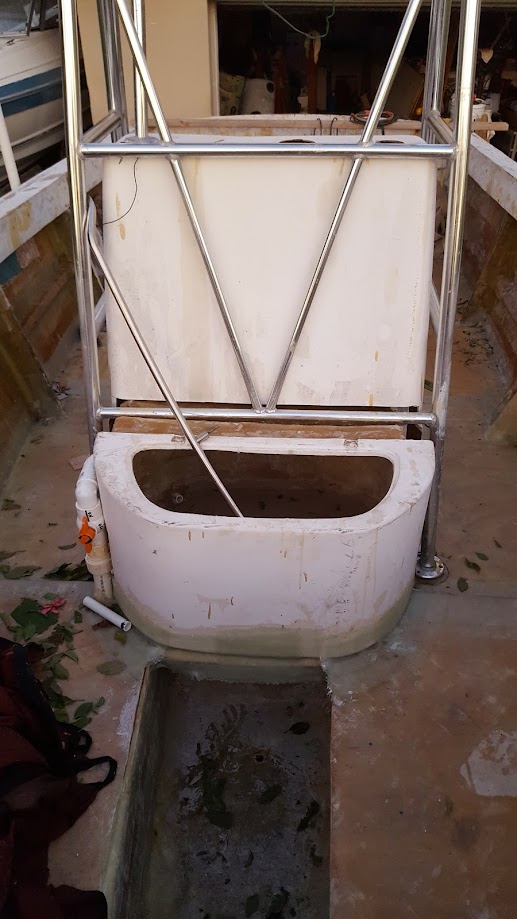

this is my live well in my console 45gal +/- drain under the deck (had deck out) to over board at that point. glassed pvc under the deck in case it broke.

the over flow

ahhh great idea for the over flow. looks clean. a lot easier with the floor already up. thanks for your input. going to take another look at it today and see. dont want to take floor up etc. just dont want to be taking on and off my portable live well. maybe i can use a removable hose and run it to the thu hull in the forward hatch under the casting plkatform
