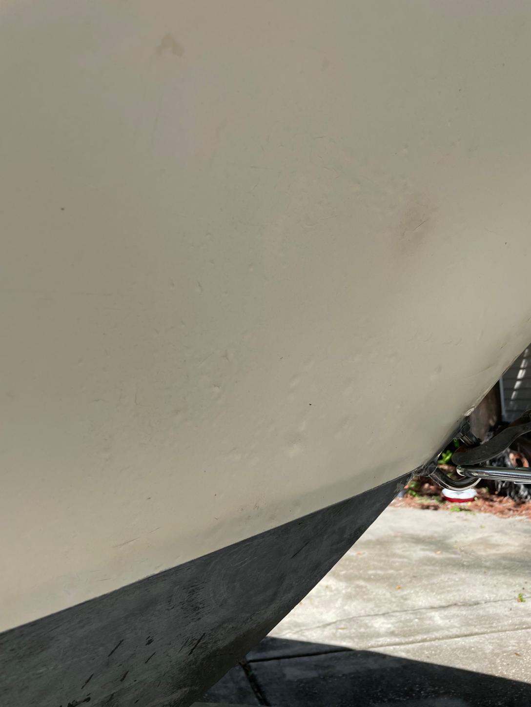

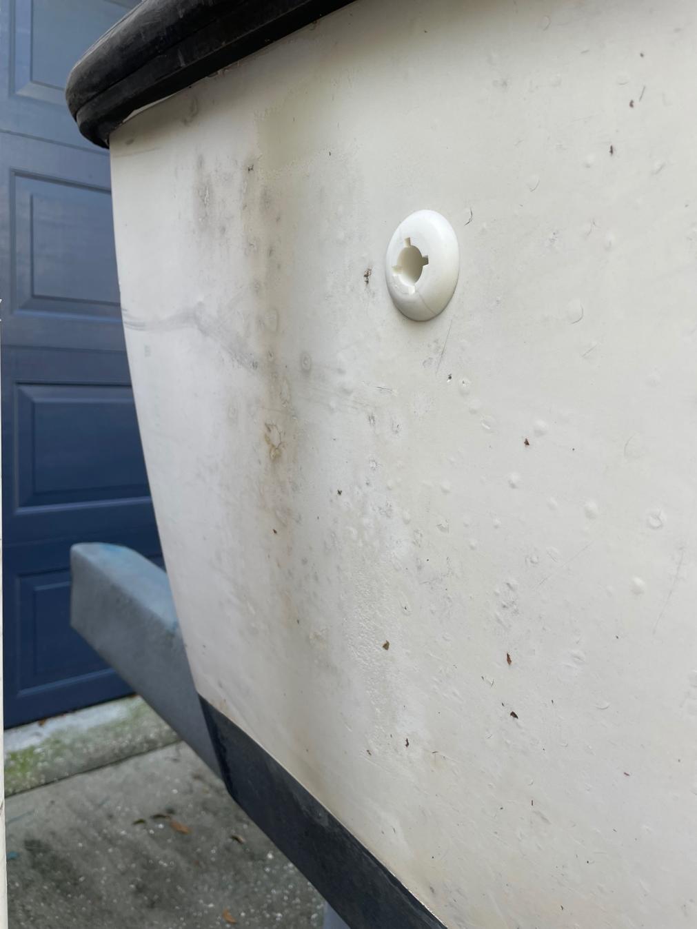

The hull has visible osmosis in so many places both below and WAY above the waterline, the gelcoat from the transom repair is failing where it meets up with the existing gelcoat and all the seacocks were poorly patched. So in short, the entire boat needs sanded, repaired and faired back to her original glory. I plan to paint the hull once done with the restoration at this time.
With this I'm considering of removing all of the gelcoat (via GelPeel) from the hull down to glass. This is fairly standard with sailboat restorations taking the gelcoat down to glass but I cannot find much online where folks are doing this with smaller sport fishing boats. THE QUESTION: AM I CRAZY TO DO THIS TO MY SC?
I'm aware and excited about all the additional fairing and sanding needed to bring the hull back, I'm just looking for some honest opinions on whether or not I should remove all the gelcoat to prevent any future osmosis on the hull once restored?
