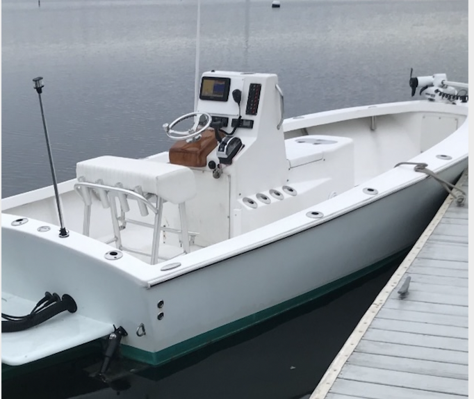

Went through the process of adding a doghouse over the past year. Have a lot of pictures and thought it would be worthwhile to document if anyone else is considering doing it. I love how it came out - shoutout to Todd at brewstercustomboats. This project suited my needs and gave me basically ability for 2 people to be fully out of the elements which is necessary for what I plan to do with the boat - fish it hard from April to November in Cape Cod. Also now have the ability to add a radar - a must in Chatham.
The boat before:

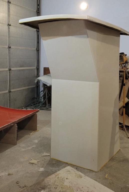

Doghouse being built. 3/8" solid fiberglass. Hard top popped out of a mold as well with coring.

Windows cut out and hardtop popped out of mold. Has Coosa mounting deck for radar.

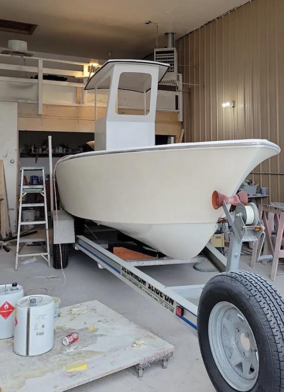

doghouse glassed into the deck. can't figure out how to do multiple photos per post so breaking it up

Old 09-29-2022, 11:23 AM
TMala TMala is offline
Join Date: Nov 2019
Posts: 82
Love it! How solid is the top, any flex when pushing side to side or pretty stable? Gonna put rocket launchers on or no? Will you use the u lock trim stuff to get the windows in? Looks like they kept the radius big enough to use window lock trim. I like the angles seems to fit the boat pretty nice.
