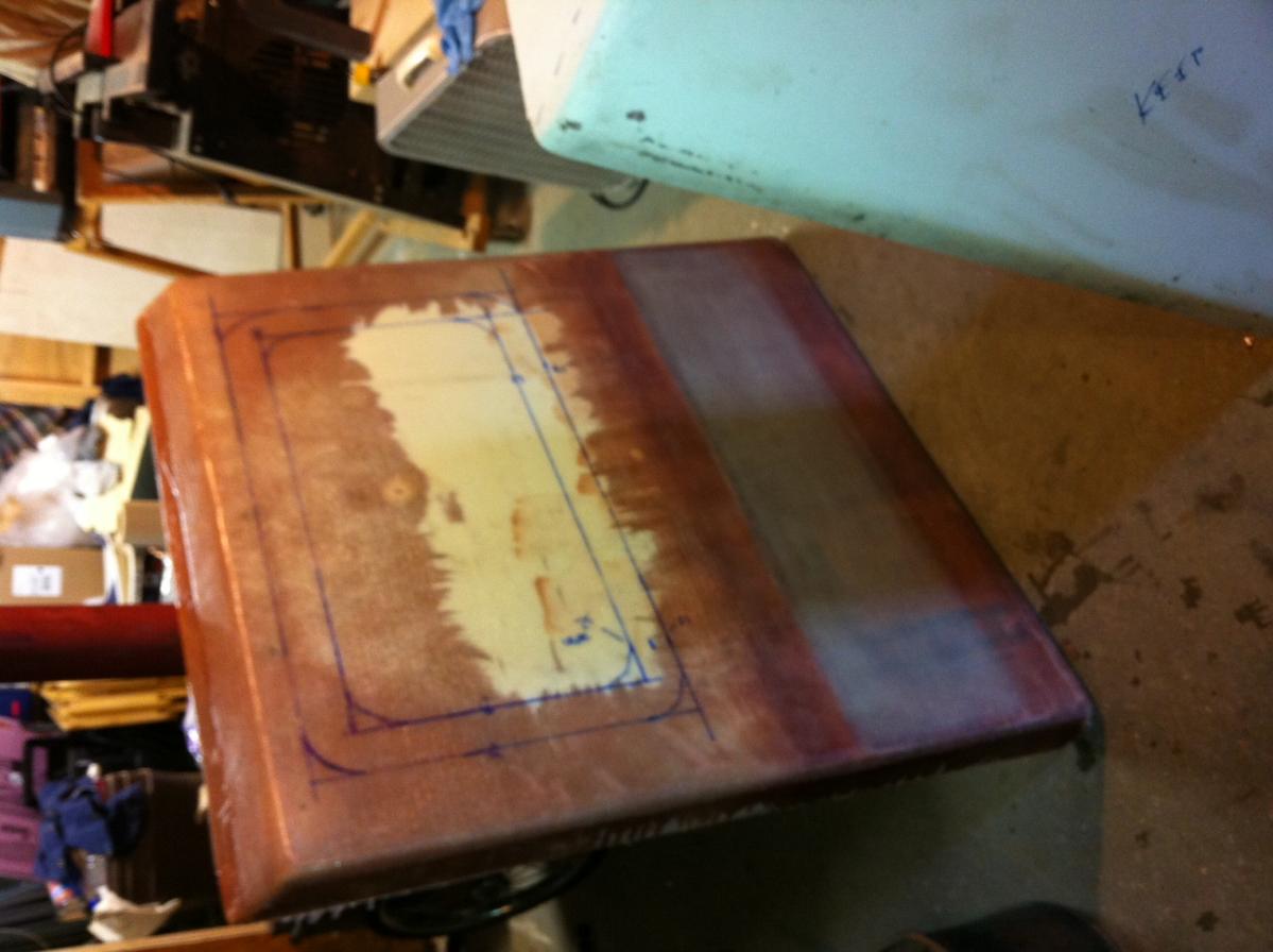

I read that it shouldn't be done, then I read from West system that it can be done. Anyone ever done it? I am rather heavily modifying my console and the patches will be epoxy. I don't want to spray a urethane like Awlgrip. Doesn't mean I won't, but I prefer to try gelcoat here. Especially as I will probably use it later on a molded part.
Basically I cut off the seat on the center console door and epoxy/glassed over it. A hack job, but I didn't have the luxury of time to do it nicely. And the epoxy allowed me to use XPS polystyrene to fill the hole and prop up the epoxy/glass during cure without dissolving, like if I used polyester.

It is a high blush epoxy. Anyway. No matter which epoxy you use. You can still gelcoat. If it is a blushing epoxy like west then make it blush, That means forcing the amine solution out rather then it coming to the top later and lifting the gel coat. I used to gel coat west system all the time. Then lightly sand and gelcoat. Now I use much cheaper USComposites epoxy and have never seen it blush in 10 years.

Well, the hardener is ancient (but free, along with the resin- which is nice) so I mixed it 10% hot on hardener, so there is even more amine than usual. But the next layer I will mix correctly.
Good to know. It is just a door, so it is a great place to experiment. I plan or brushing on the gel coat. Along with the touch up on the console proper.

If it has not blushed on its own? It usually happens very quickly in spring weather conditions. To mimmic that I think I warm it a bit with a heat gun or quartz light. then spray it with some water and let it cool and sit over night. Then warm one more time the next day if it has not blushed. sometimes it takes a second try to get it out. Just wipe with clean rags and let dry and then sand a little bit.

gelcoat/polyester WILL cure over some epoxies. You have to make certain its compatible. The epoxy has to be completely cured too.
Do not mix epoxy outside of its designed ratio (hot), all your doing there is introducing more hardener molecules than needed and the epoxy will not cure fully or even at all. The hardener in epoxy is not just a "catalyst" like in polyester, its actually part of the combined epoxy molecule. Catalyst for poly basically "tells" the polyester molecules its time to become hard. Epoxy resin and hardener are more like couples at a dance, mix in too many males or females and you end up with leftover resin or hardener with no where to go = soft epoxy.
