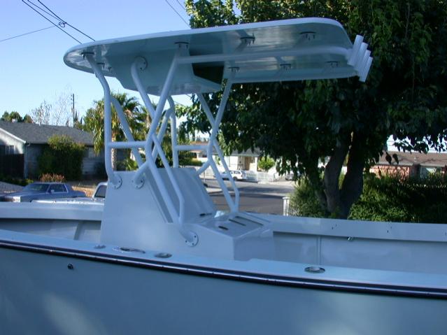

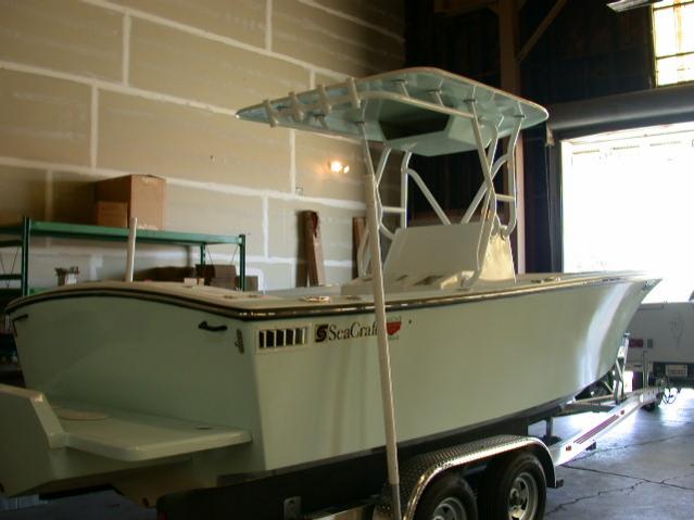

Corecell works great for a hard top. I built this one several years ago. Click on the link and there are a few pic's of the build.
http://www.casdvm.com/photos/Hardtop/index.htm

Can't wait to see this one. I used a foam core on mine it is very light and strong. Was made in a mold though (chop gun etc.)

You need to go and check out the various foam core's and see for your self. I see no need to mount metal backing plates where the Radar and antenna's will mount. Now if you were putting a crows nest in then that would be different......To be honest I don't really remember what kind of fiberglass I used that was so long ago.
http://www.casdvm.com/photos/1975%2023cc%20sale/
