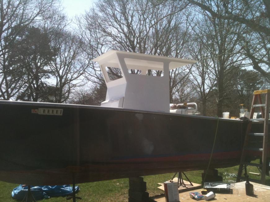

Got back from vacation and started filling blisters. There has to be over 700 of the little bastards. Many of these need two fillings. Since i needed a break i started working on the pilot house and a scupper solution that fits my needs. If any one who has barrier coated has any tips regarding application I would love to hear from you. A couple pics of the pilot house and the first part of my scuppers

Pretty cool dog house

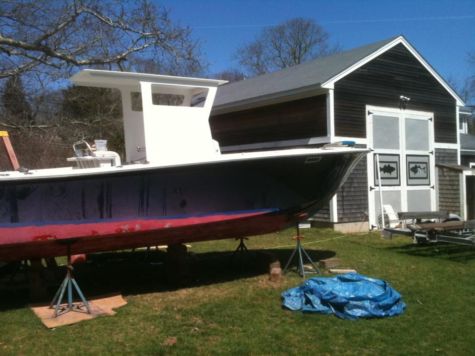

You wouldn't mind if I copy the same doghouse ; imitation is the best form of flattery. Two lookalike 23' SeaCrafts plowing the waters of Vineyard sound. "Birddog"

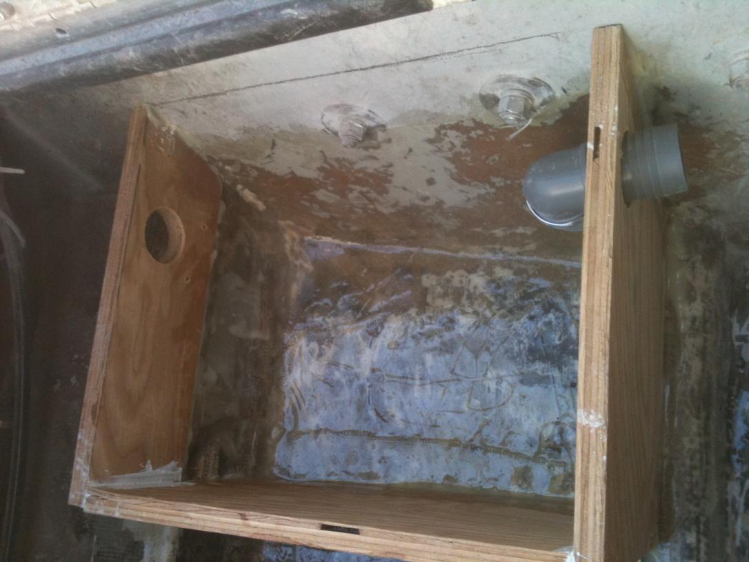

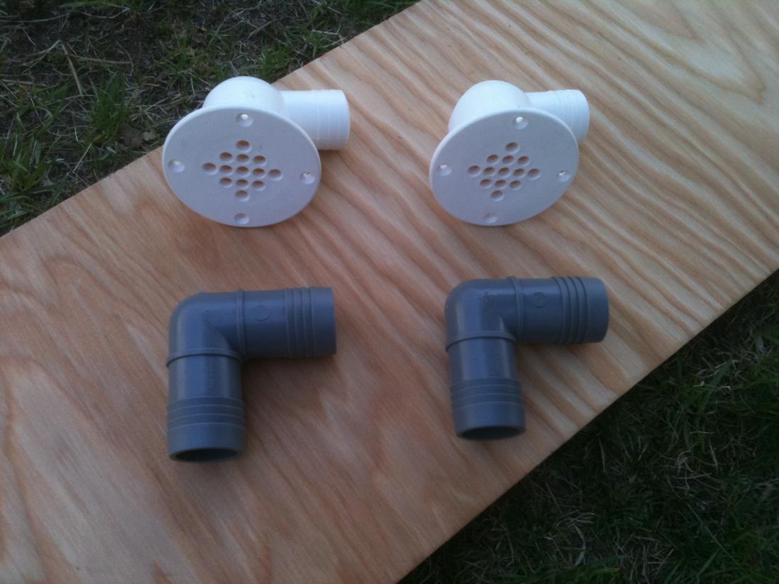

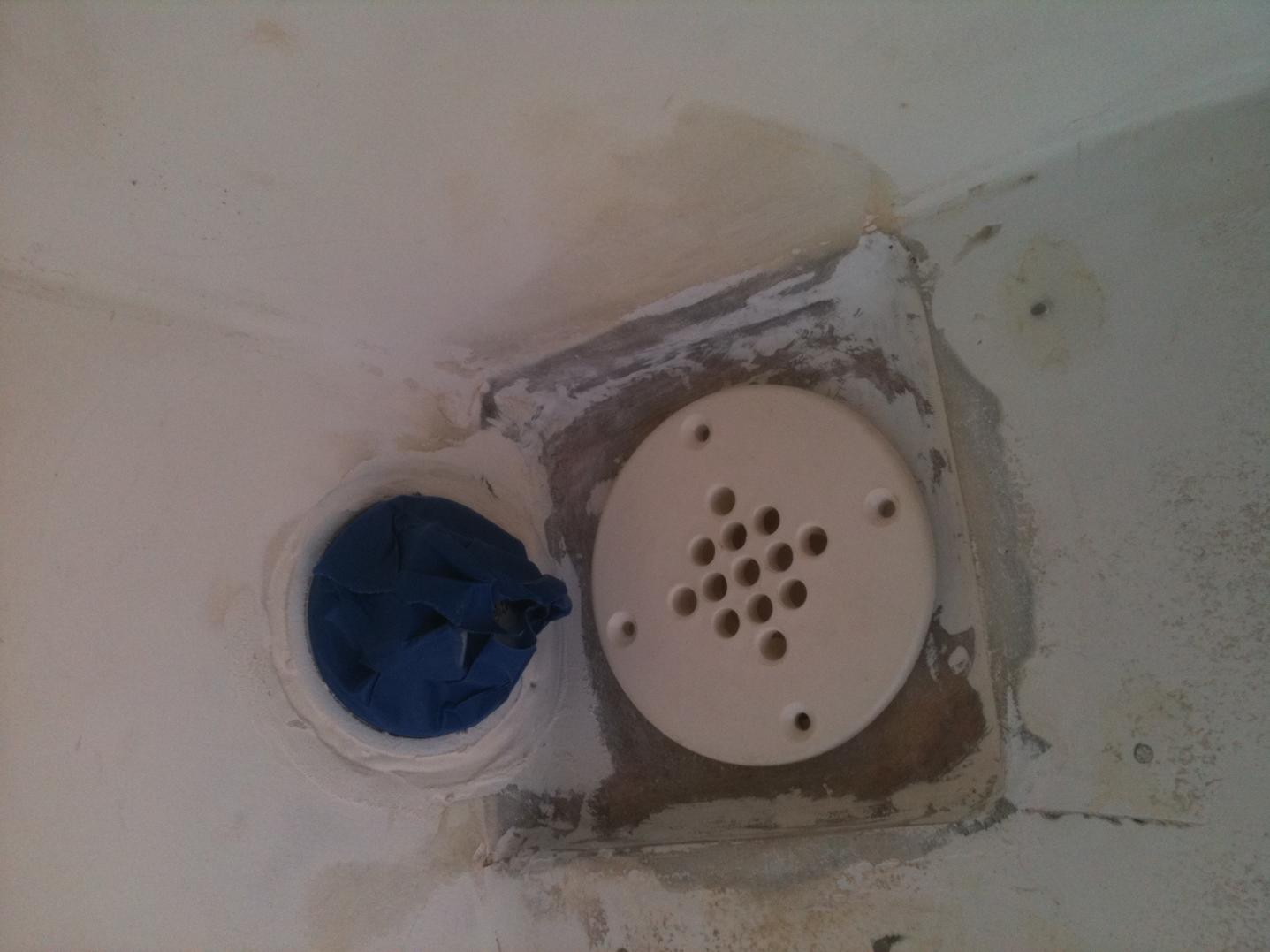

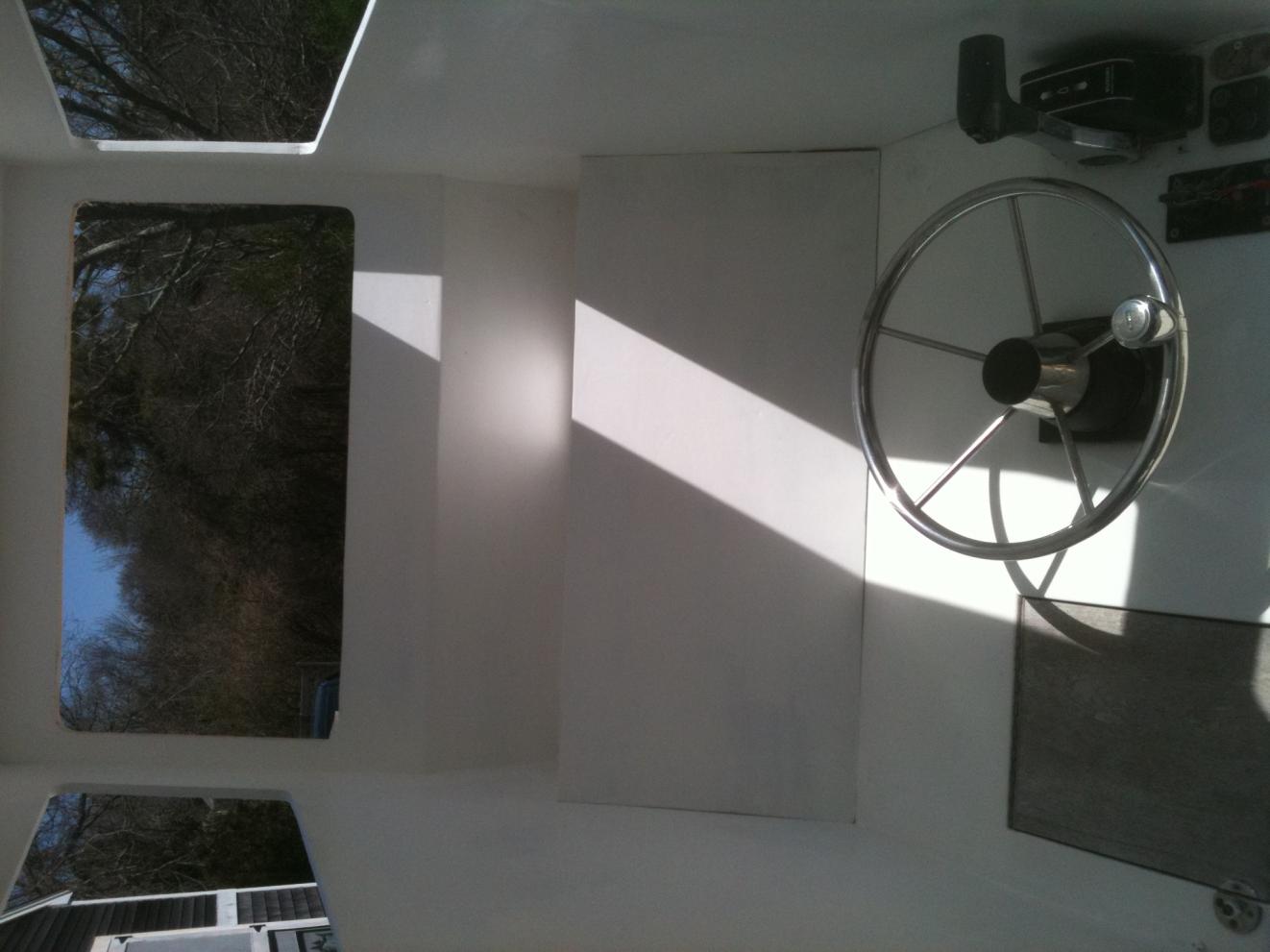

Got a little work done. The wheel house is primed but needs a little more fairing. Also made some progress with my scuppers. Being a commercial rod and realer I felt the current set up was not practical so i went with two extra scuppers on top of the factory thru deck. My first scupper is thru the deck to a catch basin in the hull. In the catch basin there will be a 1500 bilge. This scupper has a strainer and will used to discharge spray water rain water and hose wash down. My second scupper is 3" thru the transom. It is threaded so a stopper can be put in or taken out when needed. During the day big chunks of bait and other fish parts wind up on the deck. Now all i have to due is pull the plug and under a slow speed 5 galllon bucket the deck Got my windows today so i now need to make some frames.

Lookin good "THUMPER" . You using the same windows as in the Contender?

No,the ones going on the sea craft are bigger. Also these will be made out of plexiglass. The side windows will fold down and the front will slide open, up and down
