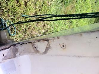

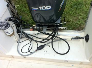

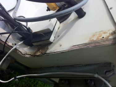

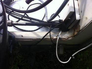

A little bit of nautical forensic sleuthing (looking at the semi-filled holes in the transom) told me that my 37 year young 20 foot Master Angler was equipped with twin engines at one time. Easy to tell when I can pop the dowels out of the transom like that. After pulling the aluminum trim and drilling the dowels, I found a mulch sandwich. No surprise, the top of the O/B cutout was less rigid than I would like, and out of flat by about 1/2 inch over 38 inches from years of outboards tugging on it.

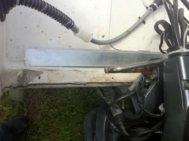

The temporary repair was to fill the crack with 5200, brace it with aluminum C channel, essentially from the top of one stringer to another. The bolts draw the "glue joint" together and seals up the transom a bit better. Enough for this season. But a new transom is in my future.
Gory pictures below. The first is the installed band-aid. The rest are the carnage. If you look closely you can see the transition from ~3/8" thick laminate to ~1/8" at about the top of the cutout.

Well, I sealed it all up with 5200 and added aluminum C channel. will take it out tomorrow and see how it goes. It made it 10 miles offshore before any fixing, so this has to be better.

In case anyone is interested, this worked great. 3 feet of channel topsides and 2 feet in the bilge. It isn't terribly ugly and makes for a nice wire trough. And it is quite rigid, tested while bottom fishing in 4 footers, and trailering with a heavy four stroke 60 miles each way.
