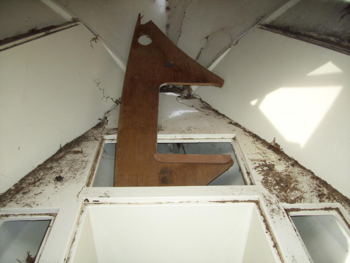

Default Anchor locker on Sceptre
I need to make a new one. Can I remove this as one piece? It doesn't look like it. I just want trace it out and reinstall it. It's just falling out at the moment and fishing season is 3 weeks away. I still have a lot to do!!
Old 01-28-2014, 10:10 PM
Join Date: Nov 2002
Location: Massachusetts
Posts: 222
Jeff,
You can make a new one fairly easily. I did mine from teak-veneered marine plywood (3/4" if I remember correctly). I recommend using the old one as a template. The hard part is getting the old one out and the new one in in one piece. To do this, I removed the hull- to-deck joint fasteners back to approx. amidships in order to raise the foredeck enough (approx. 2-3", I used a bottle jack with some 2x4 stock to raise it just enough). I thoroughly coated the new bulkhead with epoxy on the edges and sides facing the anchor locker and used Epifanes rubbed-effect varnish on the teak veneer facing the cabin. Good luck and please post pictures of the project.
Old 01-29-2014, 12:32 AM
Join Date: Jun 2013
Posts: 203
Holy crap that's a lot if work. Maybe I'll find a way to put 2 pieces in there.
Old 01-29-2014, 12:49 AM
I'm with Water Rat on this one. I don't think you can remove the anchor locker faux Teak bulkhead in one piece without removing or significantly jacking up the fore cap. It is wedged in there good. If you find a way to get it out and back in without the PITA procedure, I'm sure other would be interested in you method.
Old 01-29-2014, 12:55 AM
Of course you could take a 10# sledge hammer and get it out!!
Old 01-29-2014, 03:09 PM
Join Date: Jun 2013
Posts: 203
It's cold and icy here now. Rare weather for SC. It pretty much fell out so removal was real easy. All I did today was program #'s into the gps. I'll resume this weekend as the temp goes back into the 70's.

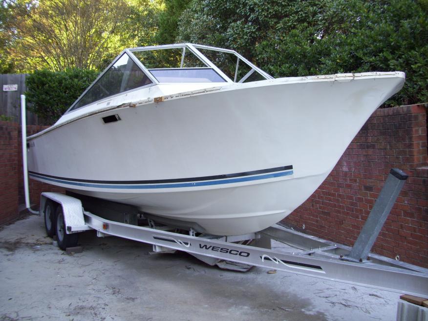

Old 01-30-2014, 03:22 PM
Holy Cow, Did somebody run that Sceptre into a bridge piling? I don't think you could do that kind of liner damage with a sledge hammer!
Old 01-30-2014, 04:32 PM
That was the 23 that I picked up after "Katrina" had tossed her
around in Louisiana......
I gave it to Jim for $1.00 2 or 3 years ago.....
http://www.classicseacraft.com/commu...ad.php?t=22215
Old 01-30-2014, 05:33 PM
No shit, I saw all those cracks and thought it might of been your old boat. I remember yours was cracked on the nose just like that one. I said what are the chances of that thoe. Purity good I guess....
Old 01-30-2014, 07:11 PM
HaHa!!
I was waiting for someone to call me out on those outragous pics!! That boat took WAY MORE hits than a simple sledge hammer could dish out!!...
P.S. Sorry to hijack the thread. Just a few pics for the old crowd. :0
