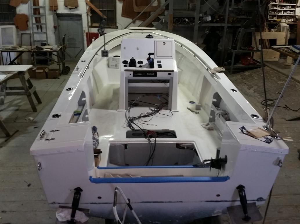

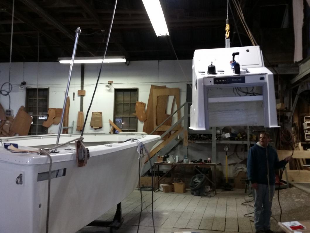

Tank floor cover is on and it's time to install the console so we can keep moving on with the wiring and the hydraulics, etc.
