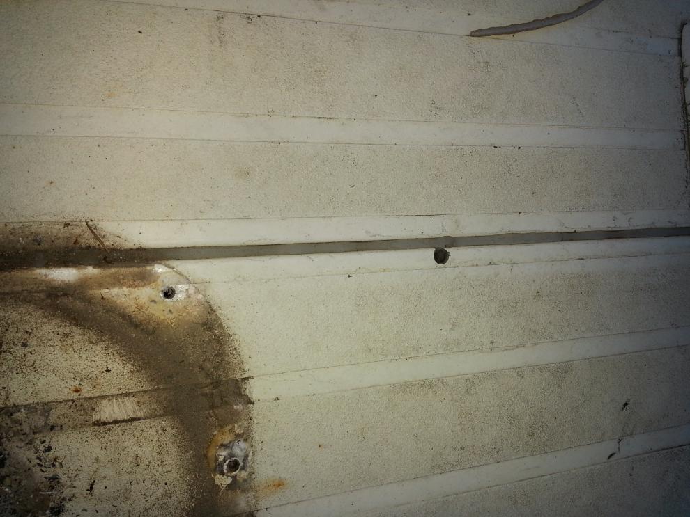

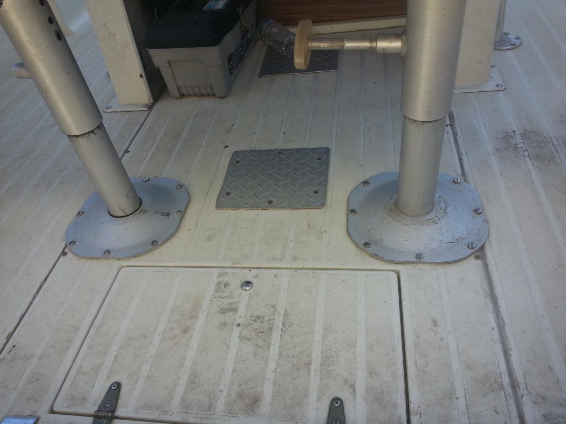

Hi All,
I'm in the middle of rewiring my 23SF and I took the fuel tank cover off to try to find places to run wires (which didn't work out). The previous owner sealed the cover down with silicone, lots of silicone. Since it is a possible intrusion point that would lead directly to the fuel tank I wanted to seal it again but with something besides silicone. Any suggestions?
