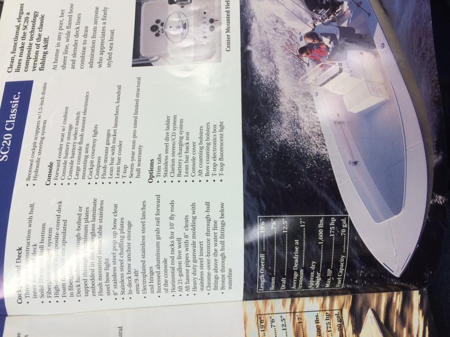

I have a bunch of older brochures- attached is pic for the 20- it holds 70 gallons of fuel- both the 20 Master Angler & Classic have same fuel capacity

My 89 20 sf is 47 usable. Think 70 was optional

Yeah, In my brochures from the late 70's the 20's fuel capacity is listed as 47 gallons but in the newer boats all my info/brochures state it's 70 gallons so things changed from 89 to 2000. the pic I attached is the 2003 brochure but the info is the same for the 2000 brochure I have.

My '89 SF20 was 70 gallons as well.
