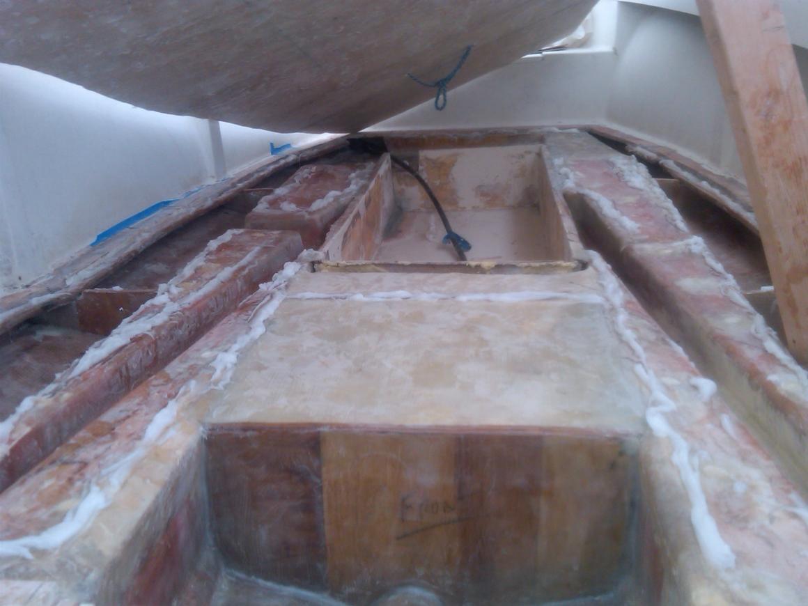

The guy I bought my 18 from had replaced the screws that hold the center console down with non stainless screws that are narrow and now rusting. While it still seems solid, already a few of the heads have popped off and I don't want to find myself in rough seas with the console sliding around the deck. So... Any thoughts on the best way to re attach my CC?
Should I just move the CC forward a bit or backward a bit and re-screw with stainless? I thought about cutting a piece of HDPE to attach it to and then attach to the deck.
Thanks for any suggestions.
Rob

Without a picture I say you try to get them all out. Any where the heads break off drill them out or if they are very rusty use a punch and tap them through. Since you will want to re-seal the console at that point I would slide the console to the side where your wire chase is (Mine was starboard side) and lean it over. Then go ahead and pull all the the screws on the deck plat over your fuel tank. Clean everything up. Fill all holes then re drill and use the correct screws. Follow that up with sealant in the deck plate seams followed by the same when you put the console back. Should take you less that a day or two unless you run into trouble. But on the flip side it will give you time to look at your fuel tank and hoses and see if there will be trouble down the road.

Thanks CaptnMick. Sounds like a good plan. Do you know if when the fuel tank cover is off if I can reach to through bolt the CC?

Not on mine. Search the rebuild threads and you should be able to find a picture of an 18 with the deck removed.

Posts: 428
Mine neither.
Solid glass coffin box
Zachary

Posts: 260
Picture's worth a thousand words. Thanks.

Beaver
This is my 1st time trying to upload picture to show you what it looks like with deck removed
Ed
