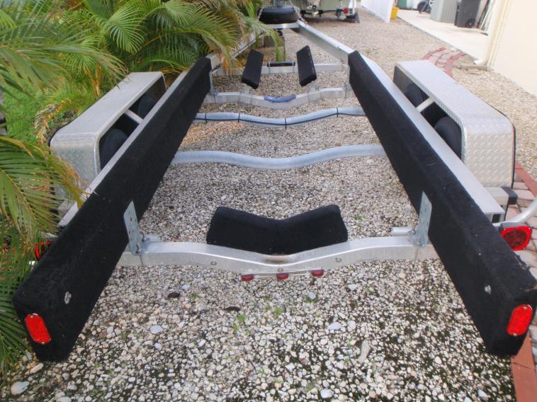

I believe my bunks are made of cypress (23 years old now). They taper down from front to rear. They were re-carpeted a couple of times and I kind of experimented on the carpeting the last time and the gray that I used is working better. Excuse the nasty bottom paint,I was hoping that it would eventually wear off by now.
I was wondering if you were winching the boat up on the trailer or trying to float it on the rollers. Personally, I hate rollers.

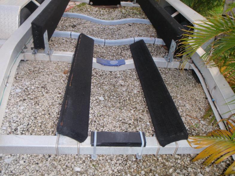

Kind of but the v itself was adjustable in height. I think I'm going to like the new centering boards on new trailer. I'll get some pics today of my new set up. The trailer is a Rocket and I am very impressed with how well made the trailer is. The I beams are twice a big as the ones on my Continental. In fact, the reason I had to buy a new one is due to one of my I beams cracking. Certainly won't be an issue on this one.
