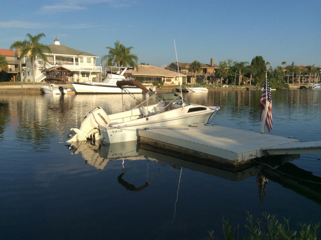

Thanks Sandy. She sits well at rest...no plumbing issues? Oh, and the anti-ventilation plate is flush with bottom!!!

Nice! She's a beauty alright! Dang it, I want my own dock.
Now raise that motor a couple of holes and hang on!
What prop are you using?
More pics please! & include some pics of the electrical, too. I'm really curious of the numbers.
