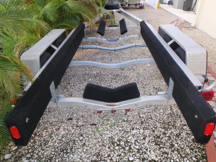

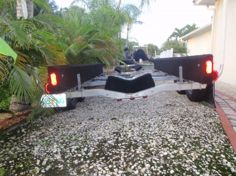

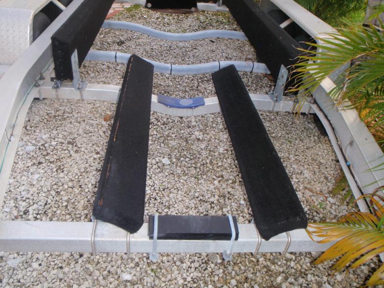

I would dump that forward V/PVC guide and go with a pair of forward bunks. You can raise them enough to get that keel off those forward cross members. Added small 1" starboard pieces adhered to those cross members for protection.
Also notice I made a custom "V" Center Transom Rest Bunk that forces the stern to settle in perfectly each time.
any questions PM me

Thanks, Capt Chuck. I love my Hitchhiker tandem axle that I bought in 1979 because it avoids the trailer rash than I was getting with the previous trailer. However, I like your idea of the forward bunks as they would start guiding the bow sooner. Things go well unless my driver is coming on too hot and tries reverse to slow down; although the boat stays within the perimeter of the trailer, it goes misaligned at the bow requiring me to grab it to straighten it out. I will consider a modification.

Thanks for the response. I have already added forward bunks and she is plenty free and clear of the cross supports now. Those are old pictures before the trailer mod. The forward bunks I have now block me from being able to get a picture of the repairs I want to make on the boat.

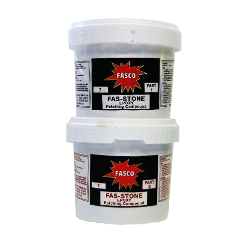

It appears not structual as mentioned above. Therefore, I would try this simple inexpensive repair first.
Try this 2-part Epoxy @ 50/50 mix.
http://fiberglasssupplydepot.com/Fas...-Compound.html
Clean the area first with acetone. Use the mix and spread with putty knife. It hardens and sands like your gel coat / fiberglass. Most likely, you will need a 2ND application after the first sanding to get it smooth. Use 150 grit then 220 then 400. Dries white and can be topped off with paint. Easier than laying glass upside down

fas-stone fasco is awesome stuff! For sure. I just love that stuff.
