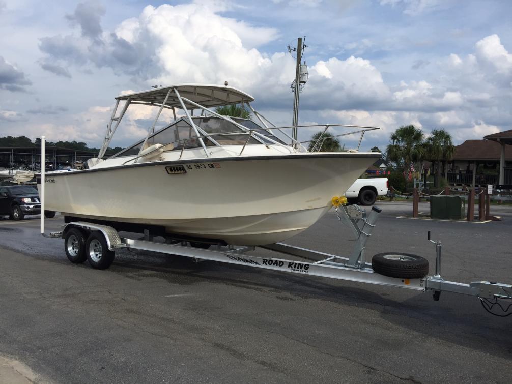

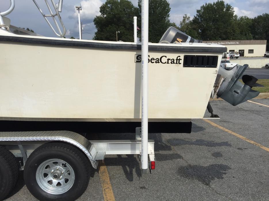

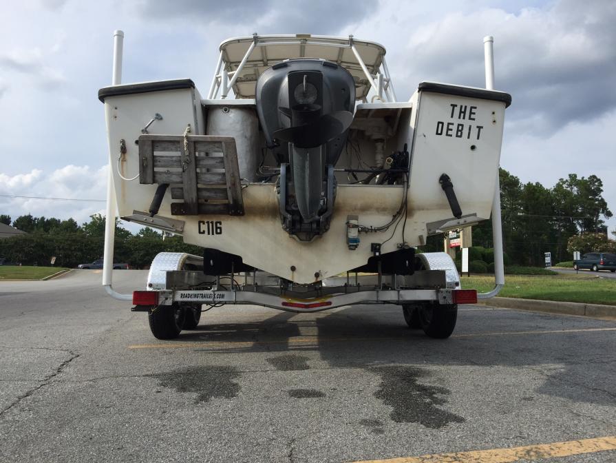

My back bunk stops right at the transom. But my trailer is made for a 24' boat. See below pics.
Jim

My new trailer is indeed a 5 lug, 14" wheel design and has a GVWR of 7,400#. The trailer weighs 1,100#, so the carrying capacity is 6,300#. I believe my outboard version of the 23' Sceptre weighs in at approx 4,500#
Jim
