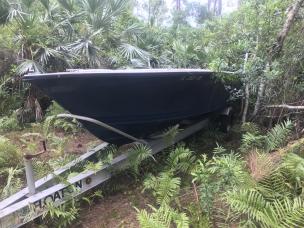

The previous owner bought it new in 86, used it a handful of times for the first few years and then it sat in a barn for over 20 years and slowly parts were removed and sold. Last fall when hurricane Irma was lined up for what looked like a direct strike here, barn space to store other more important items was at a premium. The boat was drug into the trees with a bobcat and tied off to them to ride out the storm, and there it still sat when I came along.
Anyway, it has a soft deck that needs to be addressed before refitting it, which will result in a new paint job at least from the rub rail in. The goal is to build a respectable looking fishing boat on a budget, not looking for high end finishes or a show stopper but will do my best to make it mine. Here goes.

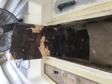

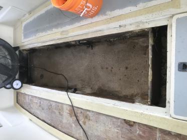

Pulled up the center of the floor to have a look at the condition of the 70 gallon fuel tank. It’s coming out at some point to check for pitting all around and pressure test, but am going to leave it in for now so I have something to kneel on while I’m working on the floors. The top of the tank is in decent shape, maybe i’ll Get lucky and it’s reusable.
Will be hanging a late 90’s carbed Mercury 150 more than likely, will be cutting a few feet off it and keeping it all the way forward to bring capacity closer to 50 gallons and keep more weight towards the bow.

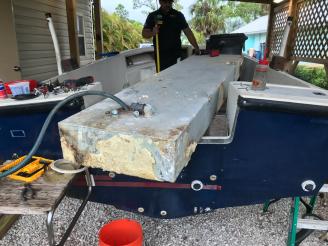

Got the tank out, it has a concerning amount of pitting from sitting in the waterlogged and rotten compartment it lived in. I’ll have to make a new one, going to shorten it length wise from 93” down to 70” and mount it all the way forward. This will bring capacity from 70 gallons down to just under 53.

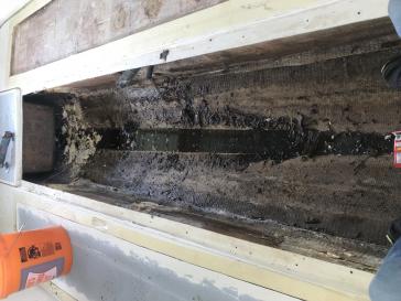

The fiberglass encapsulated wood under the tank was all rotten, cut it all out. Will be replacing with just fiberglass slats and 5200 bonded strips of starboard on the bottom of the tank for it to sit on. Should help it breathe and not trap moisture against it. At this point going to shift back over to the floors now that I have some access to some foam underneath them that was causing a noticeable high spot.

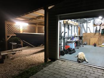

Visit to US composites to pick up the first load of supplies, and so it begins. The ceremonious first piece of wet fiberglass in my makeshift composite shop in the shed is to glass over the holes in the bottom skin of the floor where the console was held down. Most of the floor rot spread out from these holes, although I’m sure water on the deck came in through the top skin mostly.
