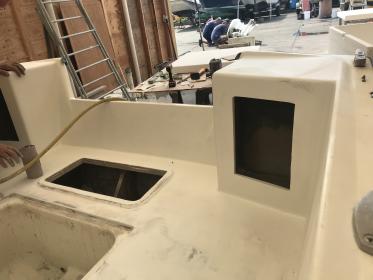

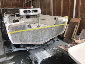

Hello All,
I’ve had this boat for around 9yrs. The time has come to redo transom, I’m also having a new fuel tank made. My plan is to make the transom 27” then hang a new Etec 135HO on it. May also put the motor on a 6” setback hydraulic jack plate.
I would also like to do away with the the transom well and make the seats next to it about 1/2 the size and bring them up to gunnel height. Port side would be for tackle box storage, stbd side for rigging and filter.
Also looking into deleting the thru floor drains and moving them out the transom with ping pong scuppers.
I’ll try to post up some pics.

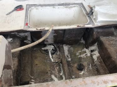

Default More pics
Anyone know where I can get that Pathfinder console I posted a pic of ?

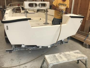

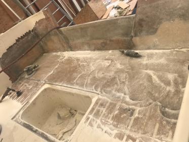

Default More pics
More pics

Default More pics
Happy with the progress so far

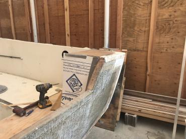

Picked up a hydraulic jack plate. 5.5” setback around 6” up/ down adjustment.
Anyone have any experience using jack plates on a 20’ SF?
Old 08-30-2018, 04:23 AM
I think that's the right way. Looks good!

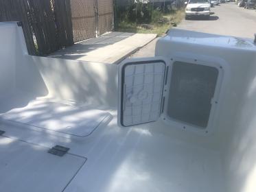

Location: Jamaica Bay, NY
Posts: 40

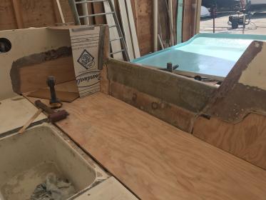

Default More pics
Just about ready to start rewiring and rigging
