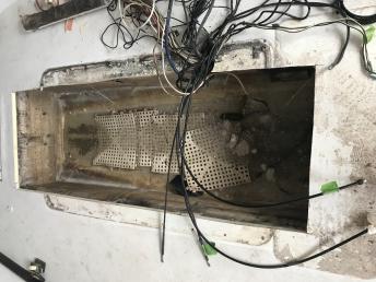

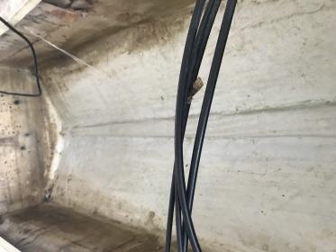

So needing to replace the fuel tank in my 1968 19ft and have a few questions. Where the tank was mounted is full of about 3-5 inches of water in a supposedly sealed area. Is this probably from just intrusion through the console or something else? Also it was just on top of the plastic mats in the picture which I assume is not standard?
Any recommendations on where to source a new tank? Also a little concerned about other parts of the floor, is it probably better to replace it before going back with the new tank etc? It appears as though the floor is some sort of sandwiched foam product but not quite divinycell...hard to tell.
Below are the pictures of where the tank was and the tank itself. Any insight and advice would be very helpful.

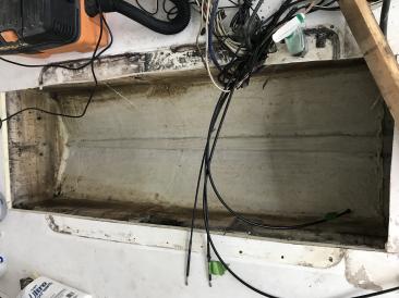

I included some pictures of the floor material. It seems like foam sandwiched between fiberglass. While the site was down I posted over on THT as well and they weren’t sure what it was either. The floor seems spongy in places and it makes me wonder if the structure underneath is either missing or too far apart. I am trying to understand what the floor support should look like.
Also, not sure what to replace the floor with should I get to that. Marine ply or something like carbon core sandwiched with fiberglass? One camp certainly thinks the composites are better while others think properly sealed ply is just fine too.
I am concerned about the weight overall but unsure if it really is that significant. I need to work out the CG calculation using the worksheet in earlier threads to make sure I put the tank and the console back in the best place because mine has a bracket.

Those pics are deceiving. Is this a CC? I thought all fuel tanks were above deck and located in the console. You have what appears to be a fiberglass molded “fuel hold” similar to my 79 MA? But yours also seems to not have a floor. Is the bottom side of your tank bellied to contour the shape of the hull?
Cannot beat Sunshine Tanks Of South Florida, who built almost all SeaCraft tanks of that era, and may still have the plans. Also RDS Of Perry, Florida is more than qualified. Just call for two quotes. Some use the old adage of “ten bucks/gallon”, and I just took it in the ARSE, believing the new tariffs doubled the price!?! Please learn from my mistakes!

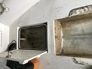

Well this boat is a bit of a mystery. It’s a 1968 and some thought it was originally a bow rider that had been converted while others thought it was just an early CC. Whatever the case, something is different as today while I was cleaning up I noticed that the cap appeared to be different sizes between port and aft. I thought it was just an illusion so I put a tape measure to it and sure enough...not the same. Not sure how that can be?
Thanks for the tips on sourcing the fuel tank, and yes, the tank is contoured to the bottom. No drains though so it was full of water and I cleaned it up. Same with the fish box..no drains and retains water.
