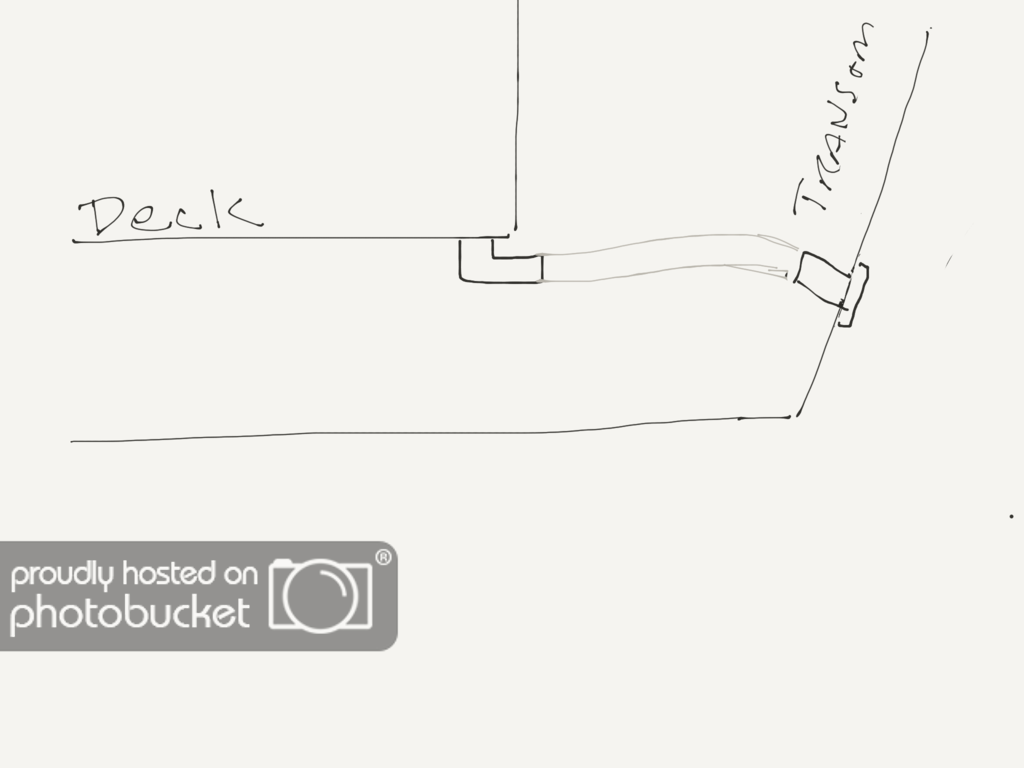

I am debating the exact same thing now for my 23 rebuild. I purchased a set of the Gemlux thruhulls with the duckbill inserts for my boat. I was going to install them but noticed that I would have to mount them almost below the water line, in-order to get them to work at my stock floor height. The problem is the 14 degree transom angle, You have to mount the thruhull lower in order to insure the barbed tail is level with the floor height. I was not sure how effective they were going to be with keeping water out and started looking at other options. Also make sure to check for trim tab clearance.
I attached a picture of a diagram someone else draw to help explain. I purchased the longer 4.5in model. Looking back the shorter 2.5in model would have been better to help keep the fitting higher above the water. The barbed tail end has to be floor level for it to drain properly.

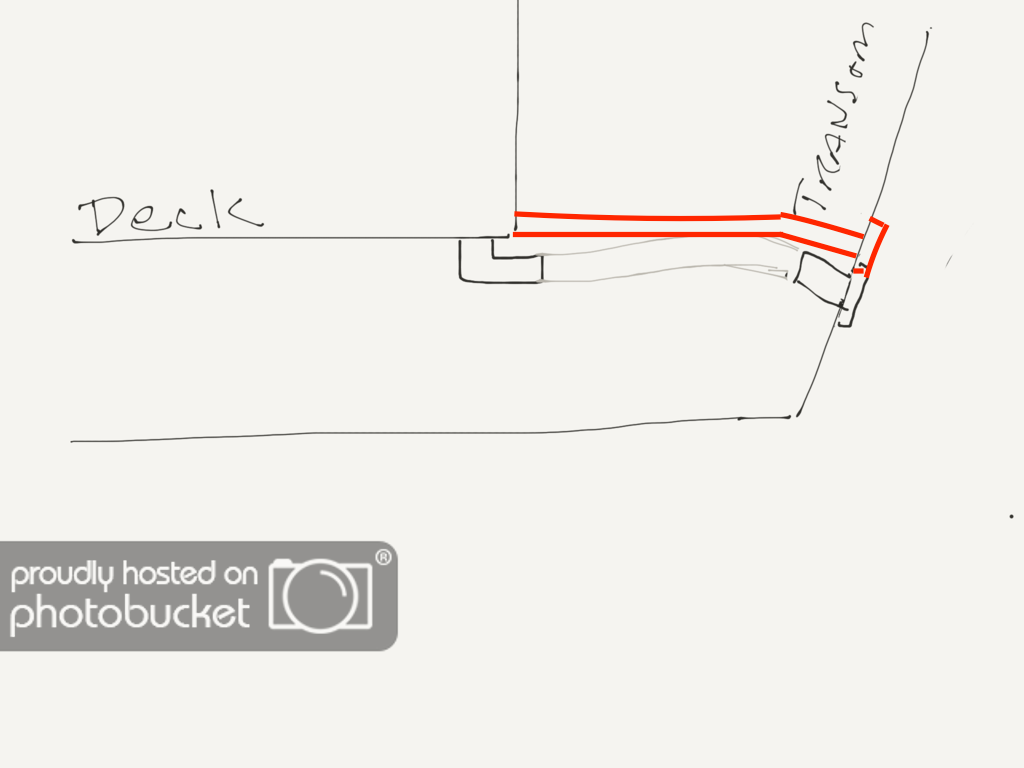

What if you did it this way?

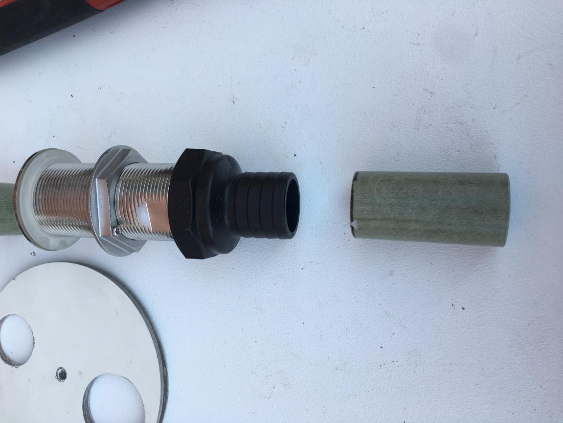

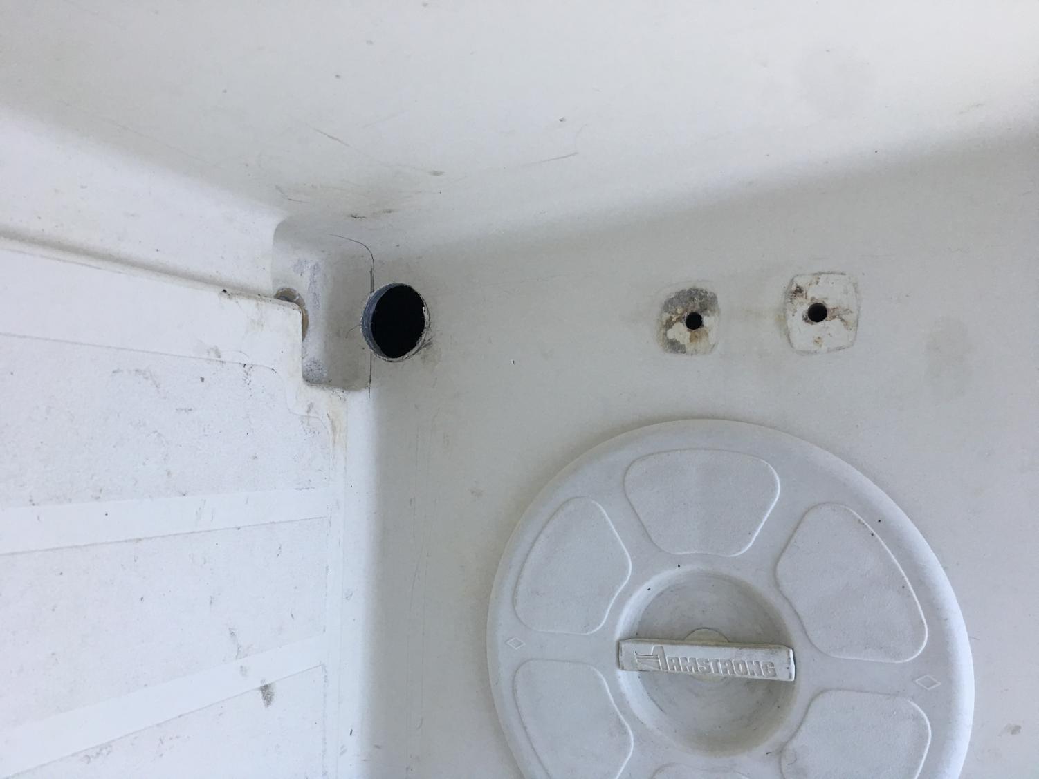

Here are a couple pictures that may help show how I plan to do this. I'm going to glass a piece of 1-1/2" fiberglass tube to the rear pocket and connect that to the thruhull with a short piece of hose.
I thought about using the shorter 2-1/2 thruhull but I didn't think it would be long enough by the time you put the nut and pipe connector on it.
My center console has twin I/O's so it's a bit stern heavy. I dont hate the thru deck scuppers but it sure would be nice to be able to use the boat without the plugs in and not have water coming in the boat.
