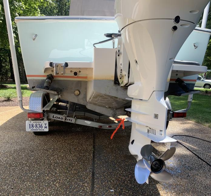

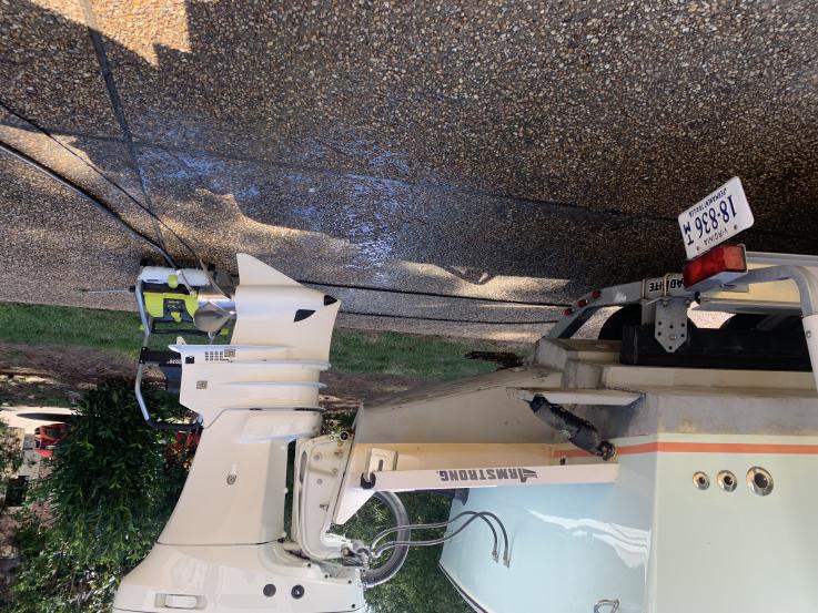

Can we see pics of the transom/bracket in a few different views? I am also confused on the Suzuki prop size. My Tsunami is no lightweight but will spin a Zuke 3 blade 20’ pitch to 6000 loaded.

Here you go. I can barely see 5900 with the 18.5 and a light load. The boat sits good in the water, so I don't think its a weight issue. No water in the bracket.

Well, that is your problem right there.
Your boat is upside down!

My observations on the 4blade prop are inline with Kmouse’s. Lost a couple mph but gained in lift and sea keeping. I also was able to raise the engine up all the way . In your picture is the motor tucked down completely or can it go more? As it looks trimmed up( might need wedges ?) Have you tried lifting the motor higher ?
