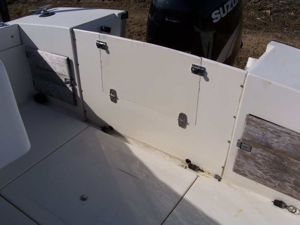

Here is the back of my 69 Seacraft that has a modified splashwell. It was like this when I bought it. The height has come in handy a number of times keeping rollers out of the boat. The only thing is I can not fully tilt the motor out of the water as you can see in the second photo.

Cut it, seal it and put some hardware on it. It'll work just fine.

Mentalfloss, with all due respect, you (and anyone else running a similar motor, or even a V-6 E-Tec or Optimax on a 20 sf or Seafari) should seriously consider adding a raised splashwell. The one in picture below in Kevin's 78 20sf would be a MAJOR safety improvement! This is the OEM raised splashwell option that Potter came out with in the late 70’s. Suggest you send a PM to Pianewman (Ed Newman) who is looking at having Don Herman build a batch of them. Check out this thread (http://www.classicseacraft.com/commu...ad.php?t=23137) that Ed started for more pictures. The more guys that sign up, the cheaper they’ll be!
Regarding the safety issue of low transoms and splashwells, anyone that hasn’t seen it should checkout this thread (http://www.classicseacraft.com/commu...ad.php?t=23037) about Mitchman’s 20 sf that went down suddenly off Martha’s Vineyard a couple of months ago! Mitch’s boat had enough water in the bilge that the stern went under when he opened the throttle, so I don’t know if this raised splashwell would have saved his boat, but I can’t help but wonder if it would have kept lots of water out of the boat long enough for it to accelerate away from the stern wave and maybe have bought him some time to start pumping the bilge with a manual pump!
When Carl Moesly designed the 19/20’ hulls in the mid 60’s, the biggest outboards were less than 300 lbs and the boats were easily self bailing with those motors. I believe he actually designed them for the I-6 Merc, which was very light (weighing something like 260 lbs?!) The much heavier V-6 motors came out in the late 70’s, and Potter raised the decks and came out with this raised splashwell accessory about the same time. He deserves credit for evidently recognizing the potential problems with the heavier motors! However I believe those early V-6’s were still under 400 lbs, and folks are now installing motors weighing 450-500 lbs, so the self-bailing issue is changing to one of self-sinking! Notice that all the 18's, 20 MA's, and O/B 23's which Potter designed in the 70's also have a full height splashwell!

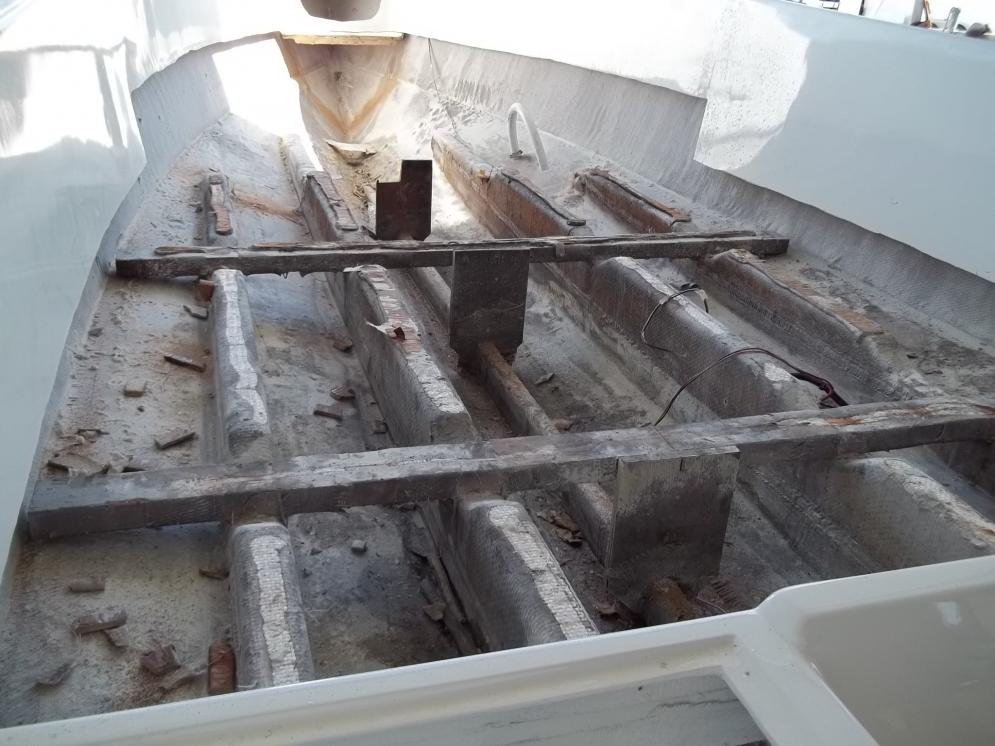

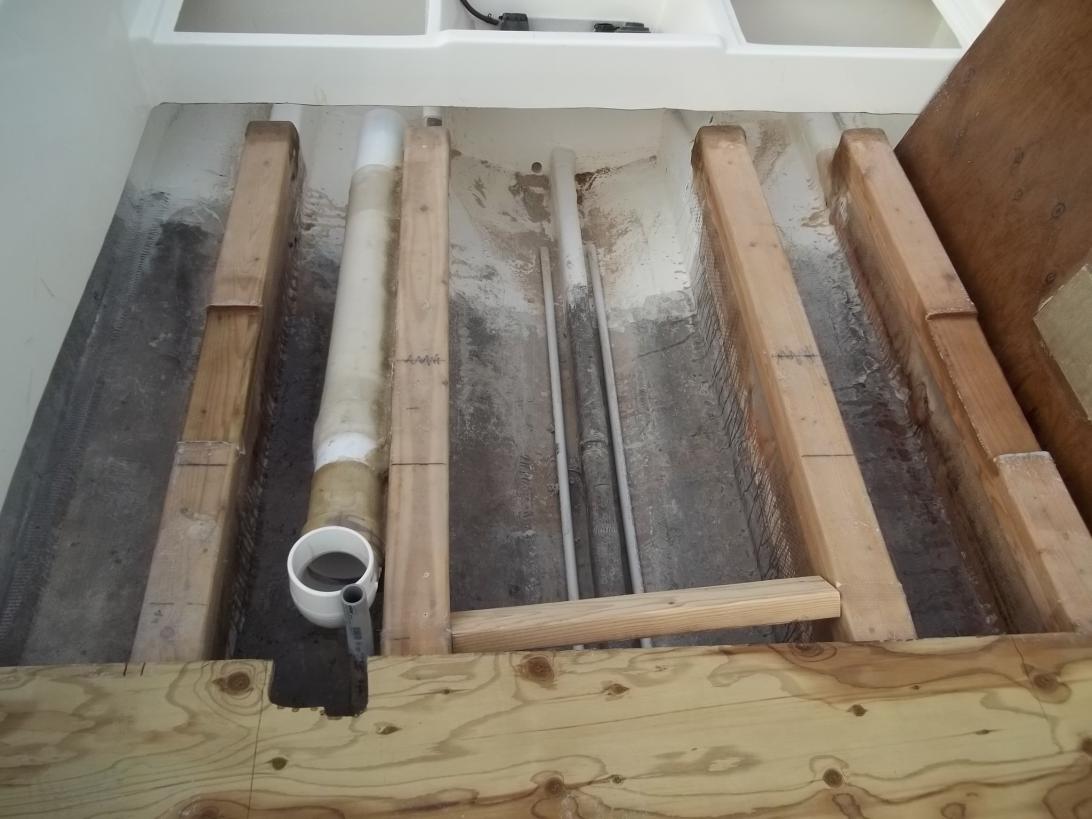

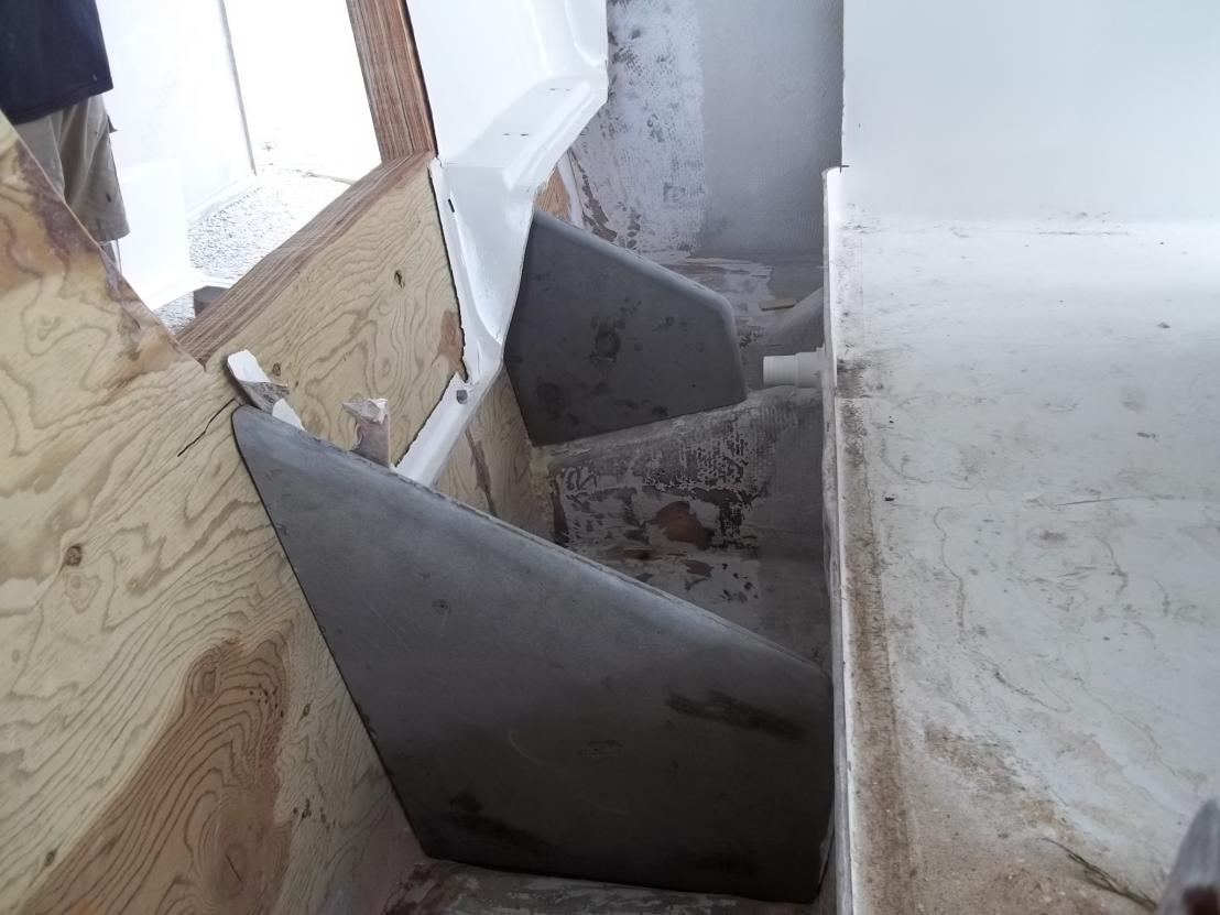

The boat is getting closer to being done. I had the transom rebuilt with Aqua Tech plywood. Stringers looked good. Raised the floor up 3 inches. Removed the casting deck. Foamed the outer 2 sections of the hull. Installed new floor. Had the outer hull sanded and gel coated. They are working on the inner cap now.
Can you look at the pictures to see if it looks like they are doing things correctly?
Also any opinions on time and cost. It has been 14 months to get it to the stage it is at and about $14k.
