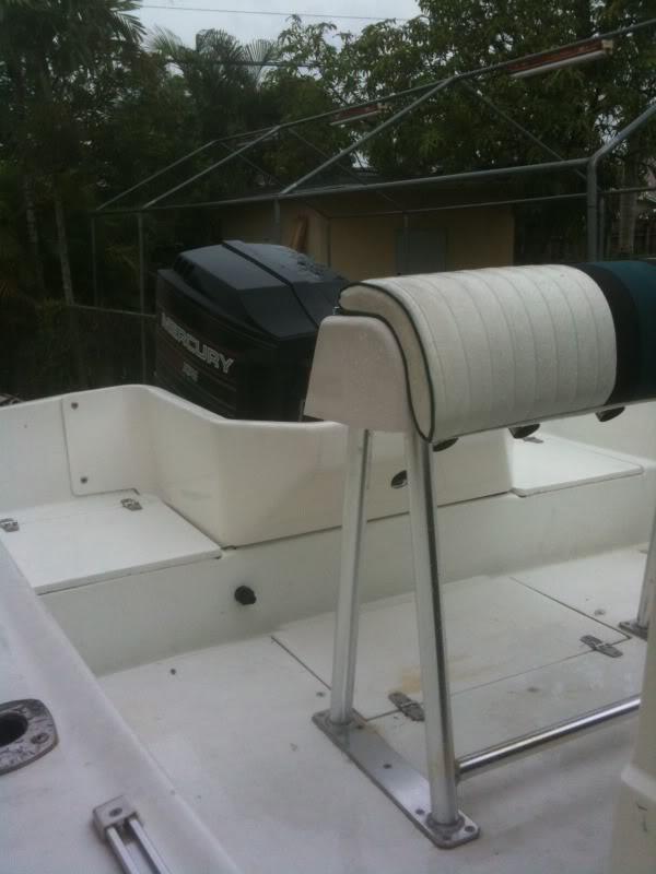

Mentalfloss, with all due respect, you (and anyone else running a similar motor, or even a V-6 E-Tec or Optimax on a 20 sf or Seafari) should seriously consider adding a raised splashwell. The one in picture below in Kevin's 78 20sf would be a MAJOR safety improvement! This is the OEM raised splashwell option that Potter came out with in the late 70’s. Suggest you send a PM to Pianewman (Ed Newman) who is looking at having Don Herman build a batch of them. Check out this thread (http://www.classicseacraft.com/commu...ad.php?t=23137) that Ed started for more pictures. The more guys that sign up, the cheaper they’ll be!

When Carl Moesly designed the 19/20’ hulls in the mid 60’s, the biggest outboards were less than 300 lbs and the boats were easily self bailing with those motors. I believe he actually designed them for the I-6 Merc, which was very light (weighing something like 260 lbs?!) The much heavier V-6 motors came out in the late 70’s, and Potter raised the decks and came out with this raised splashwell accessory about the same time. He deserves credit for evidently recognizing the potential problems with the heavier motors! However I believe those early V-6’s were still under 400 lbs, and folks are now installing motors weighing 450-500 lbs, so the self-bailing issue is changing to one of self-sinking! Notice that all the 18's, 20 MA's, and O/B 23's which Potter designed in the 70's also have a full height splashwell!
