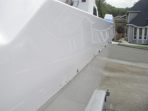

I use DuraTech to reduce it, it comes out much nicer. 1.8 at 55 psi lays down better than you would expect. Depending on your needs, you may call it done. This is just sprayed...
If you want it perfect, I use a DA w/ 220 to knock off the peel then 400 600 800 1000 on the DA. All dry. The compound, then polish. The finer grits on a 6 inch DA go fast.
It will come out like this...

That looks very nice. Thanks for the info.
I don't even see any orange peel on that, if mine comes out like that it is staying like that.
