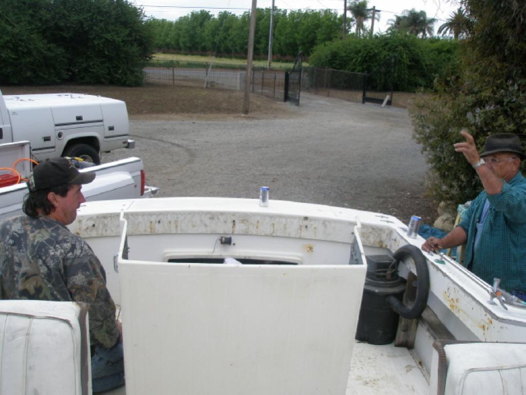

I have not looked into our Tsunami but I'm fairly sure that you could cut the cap and remove it to replace the transom. See the beer can in the picture on the right just aft of Bucks hand? Cut there, remove the rub rail, drill out the rivets and pop off the cap. The cap can then be glassed back in place and your good to go. Personally I dont like doing the transom from the out side as it is a lot of work fairing it out. In the long run I think it is easier, faster, and as you eluded maybe even a little "stronger" to do it from the inside. We are going to be restoring out 23 Tsunami very soon!

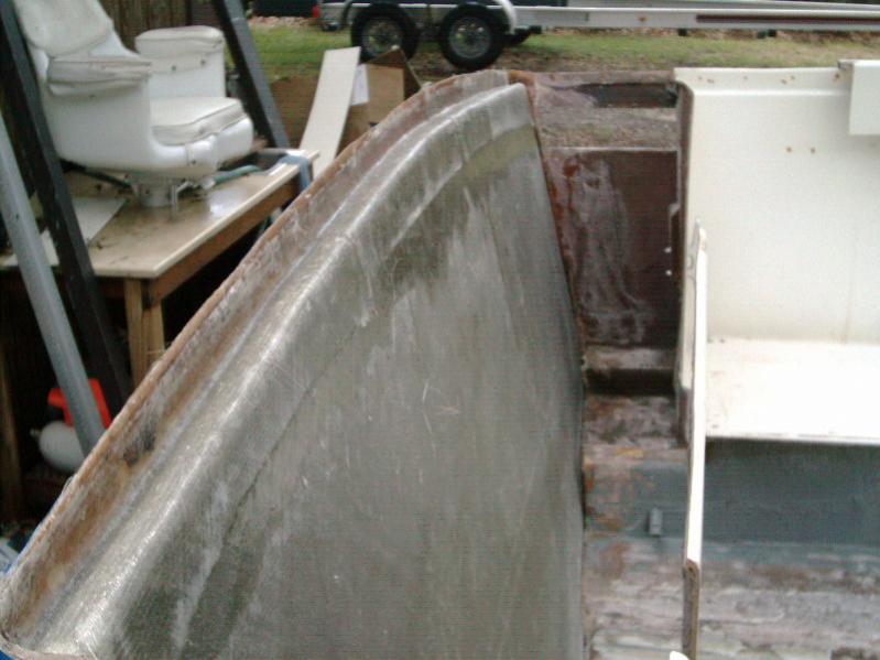

Look at my '78 transom redo in the photo section. I'm not a glass guru at all but even thou it's an outboard, The pics will give you a idea of the transom from the inside and cutting the cap like Strick recommends. The 16" wrap space should be sufficient.

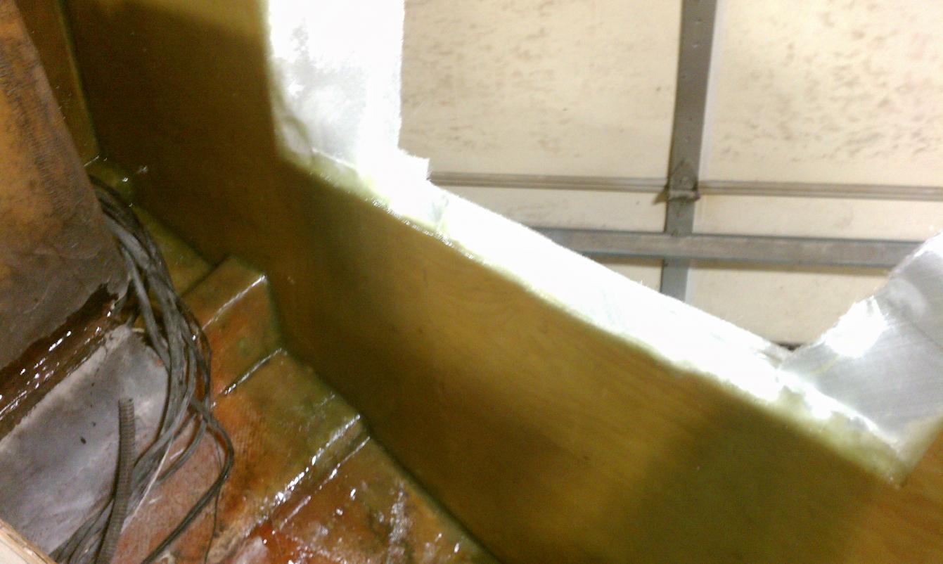

i removed the hawse plate and made my cut in the center of the hole.
