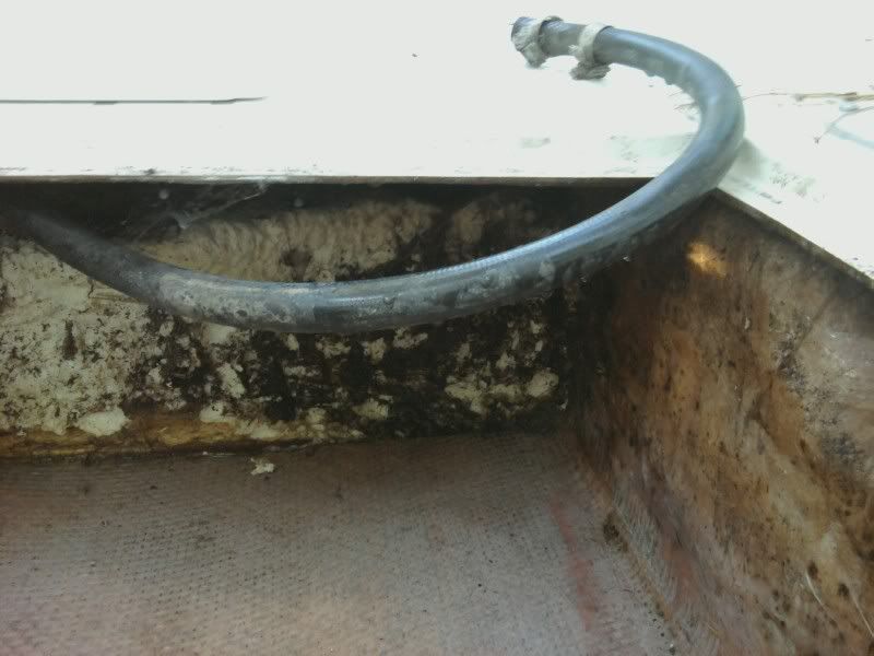

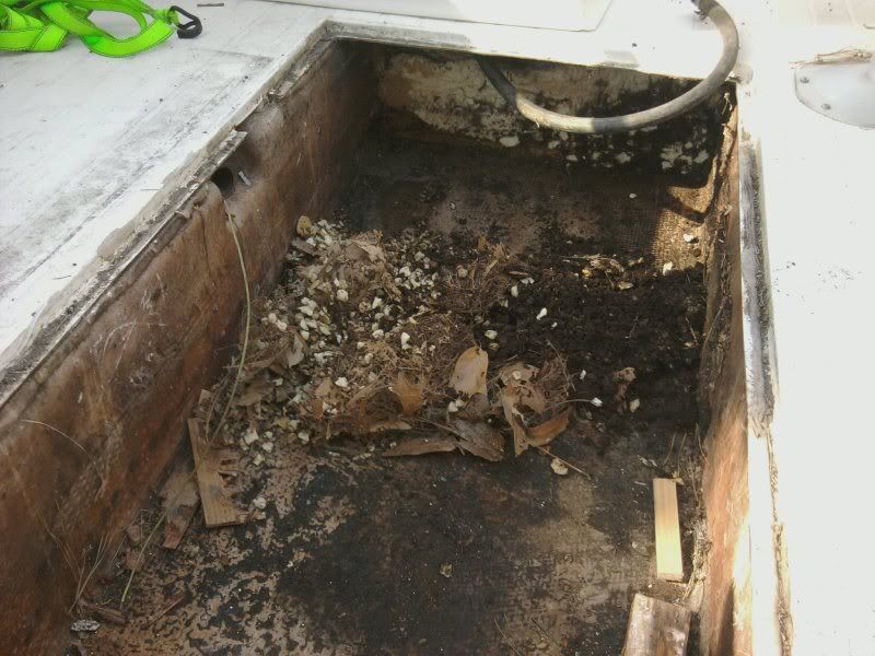

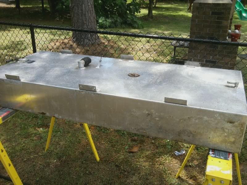

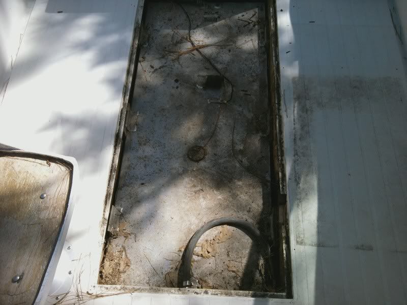

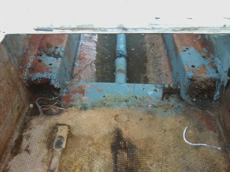

Messed around with the boat today. The first thing i wanted to do was get the fuel tank out. It wasn't that bad. Had my neighbor help me out which helped alot. Took maybe an hour to get it out and another 30 mins cleaning up the foam. Here is some pics. I measured the tank it came out to 60' long x 24 1/4' wide x 8 1/4' deep. Does anyone know how many gallons that would be?

Right about 50 gallons if you subtract the .25". Hope that's not the boat someone was going to convert to CC.
Old 06-16-2012, 11:41 PM
Originally Posted by Back Sound View Post
. . . Does anyone know how many gallons that would be?
The density of gasoline is 44.9 lbs/cu. ft and specific wt is 5.87 lb/gal, so that works out to 7.65 gal/cu. ft if I did the math right. If the sides of your tank are perfectly rectangular, that would work out to about 6.93 cu. ft. using outside dimensions, or 53 gallons. Per the '79 brochure (http://www.classicseacraft.com/broch...ure/index.html), it may have a 47 gallon tank in it, but that may be for the O/B model. The tank in the Seafari is about 5 gallons smaller in the I/O model because of shorter length due to engine space. The top of my Seafari tank tapers down at the rear on top and the bottom tapers up at the front to allow for removal, so the sides are not perfectly rectangular. It holds about 34 gallons. Later Seafaris with a smaller step down into the cabin, starting about '74, supposedly had a 50 gallon tank.
You might consider having it pressure tested to check for leaks. That could save you the cost of a new tank!

length x width x depth (in inches)
60" x 24" x 8" = 11520 sq inches divided by 231 = 49.870 gallons

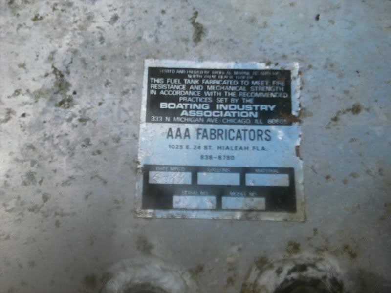

Cleaned the tank a little bit today. Was looking to possible re use this tank but after flipping it over i heard a bunch of something inside the tank move around. Not water or fuel but whatever it is clumps of rust i guess it is alot of it.
The tank actually looks in good shape from the outside for a 38 year old tank.
It had three rubber strips on the bottom that i took off. What are those strips called?
The only thing that i could make out is the date of 6-74 on the tank.
