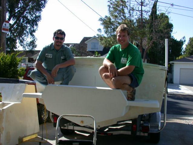

Old 10-20-2012, 04:37 PM
Holy smokes . . . that was 2004 . . . where did the time go????
Like Strick said . . . use poly . . . cause it takes about 10 - 12 gallons of resin to make one with a swim platform.
This one hasn't had much use and there is not a stress crack in it. This boxy design takes less material and less brain power to build.
The red one I made is still kicking around on a seacraft.
The one I made for Hermits Heron has had some problems, cause I added too much beer and used some experimental fabric (which wasn't a good choice). Hermit has to do some repairs to one section, but it's still holding up after a full bass season 225 ficht. Stringer design is important . . . I like one big thick stringer down the middle to the top of the tub.

There is a bit of a stress concentration at the ~90 degree angle between the side of the engine mounting surface and the aft face of the swim platform (right where rub rail stops in picture below). A 45 degree fillet in that area would significantly reduce the stress there. Or it might be easier to just extend the swim platform out to the AFT surface of the engine mount/flotation tub. This would also eliminate the stress concentration and create a slightly larger swim platform for same motor setback distance. AND consider putting a rub rail around edge of bracket - trust me, you will be glad you have that when docking around barnacle encrusted pilings!
