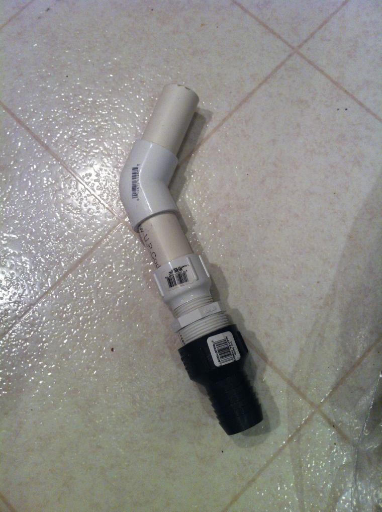

My home depot plan goes from 1" drains thru to 1-1/4" hose. I really should have just turned the PVC down to make hose barbs on the lathe at work, but this is easier. And I think the socket welded 45 degree bend will be nice.

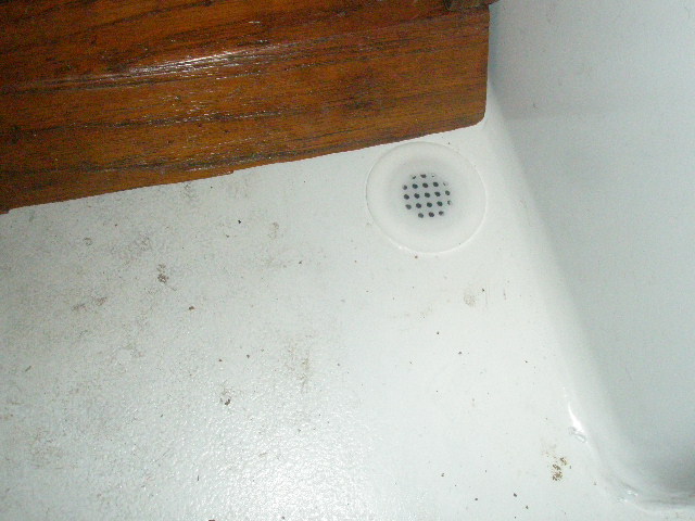

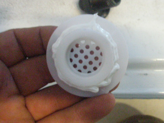

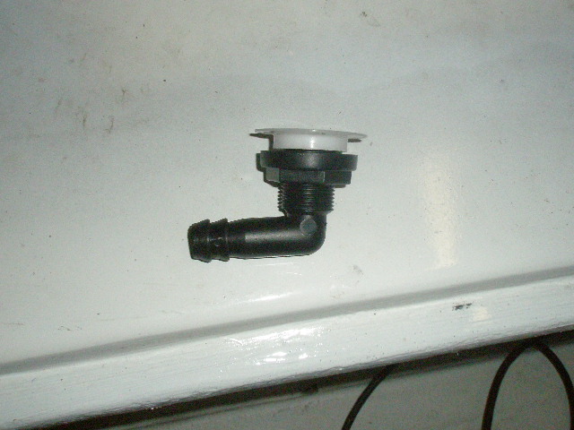

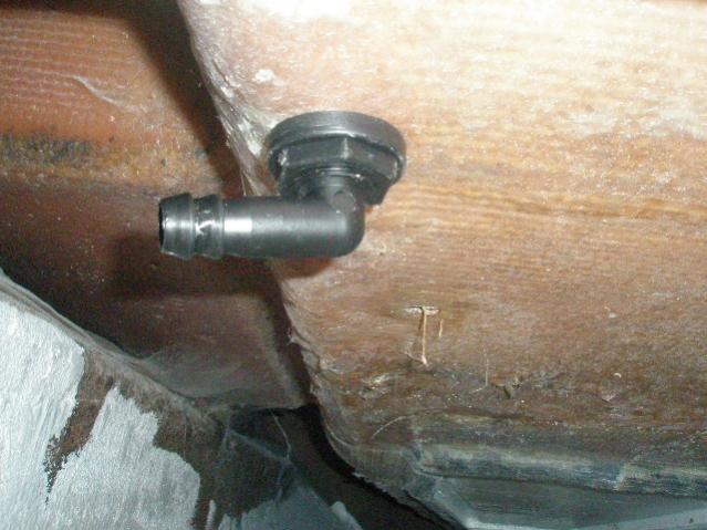

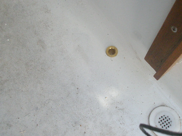

Her is what I did on mine. The two that sit on the outside of the cabin door threshold have screens. The two that are inside the cabin are bronze fittings epoxied flush with the deck. The balsa core was in good shape on my boat.
  #57

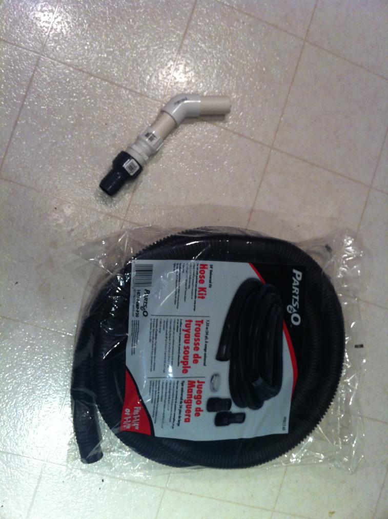

I would stay away from that corrugated hose. It gets brittle with age and breaks. Any solids that find their way down the drain will hang up in the corrugation. It will be difficult to support in a way that consistently drains. If it holds water, your arctic winters are going to freeze it and break it. Just sayin'.

You have a good point about freezing the corrugated hose, I hadn't thought past the $11 a roll , vs. $3 a foot part.
I am of two minds on the strainers. I hadn't thought a lot about debris, more about the ability to drain away water quickly- hence the 1" diameter. If they do go to a small "settling tank" (and the debris sinks- it might not), then the settling tank has a slightly elevated bilge pump, then that might work without a screen. But a topside screen fixes most of this straight away. Except for leaves. Which both are vulnerable to.
I think I will keep looking. Or buy some schedule 80 PVC and make a deck fitting with a shoulder on it in the lathe.
Dave
And never use it on your bilge pumps.

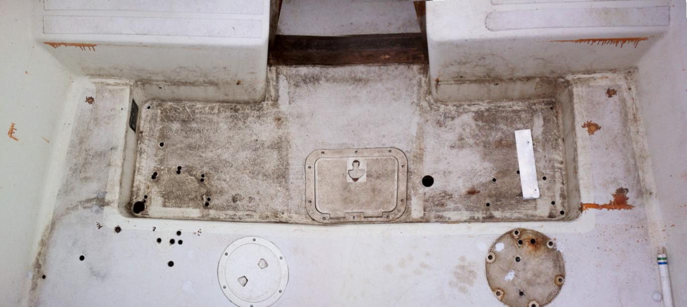

This is the cockpit- (I stitched together 2 cell phone photos so it is warped)
I need to remove some wet balsa and fill holes. I drilled them out to get rid of cracked glass and get access to soaked balsa core. I plan to foam fill and put "water putty", then vinyl ester, then gel coat.
You can see the track of the bilge hose out of the left corner, across the deck and out the port side. The 1-1/4" hose was reduced and put thru a 5/8" thru-hull!
Oh yeah, and they couldn't be bothered to remove the wood decking they put in the cockpit before splashing it with stain...
