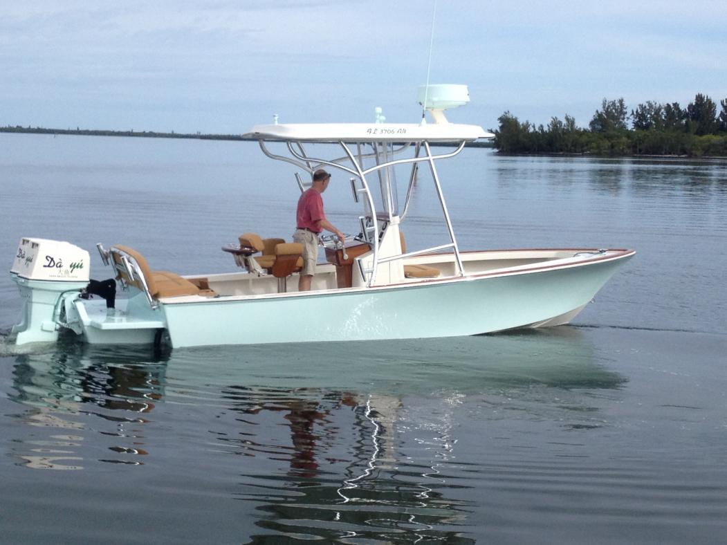

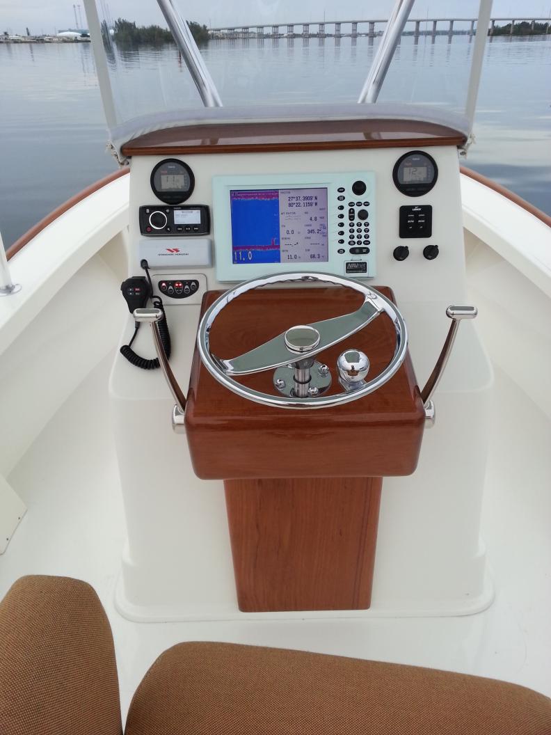

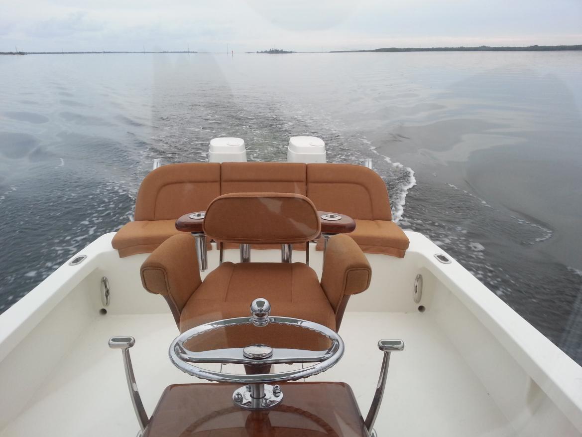

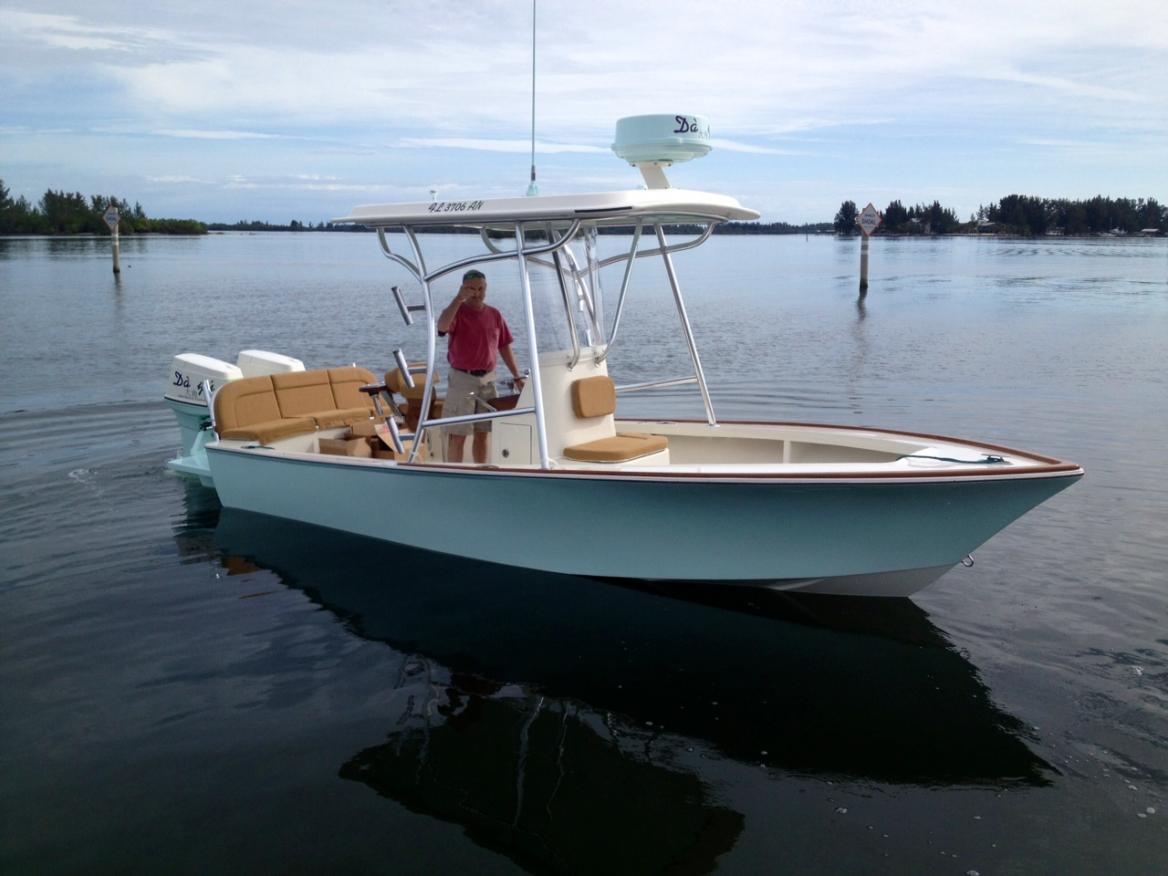

I posted shots of my 2 year project after completion. The boat was completely stripped, nidacor decks, foam core transom, new hermco bracket, custom fiberglass top and aluminum frame, custom console, painted with awlcraft 2000, installed two stroke 90hp yamaha's with bay mfg 5" extensions, custom painted the engines, glendinning electronic controls with palm beach handles, bluewater chairs helmchair and custom rocket launcher, navnet vx2 custom painted, lenco trim tabs, etc.

Old 04-23-2013, 03:34 PM
Oh yeah, it's time for another 'Gucci Stamp' Award
OUTSTANDING job Sir! I like the custom hull color duplicated on the Navnet frame, Antenae & Radar !!! The Nav Lights built-in to the hardtop is Very Cool also! Saaaaaweet

Old 04-23-2013, 03:54 PM
WOW!! Utterly stunning! Great work...
Old 04-23-2013, 04:06 PM
Nice project, Are those twin 70's johnsons from around the late 80's-early 90's??? and if so what kind of proformance numbers do you get with those??? Love the wood helm, boat looks good I like the how it turn out. Dont see many twins on the 20' moddels but I think many came from the dealer like this back in the early 70's.

the engines are Yamaha 90TLR's,with bay mfg 5" extenders to make them 25". the boat trimmed out does 30kts (34mph). I decided early on in the project to put twins because I am planning to tow the boat to the islands and wanted the redundancy but you sacrifice performance. It will plane and hit 22kts on one engine with the other trimmed out.
