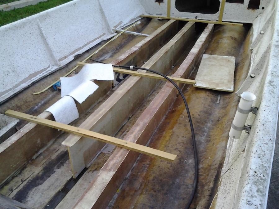

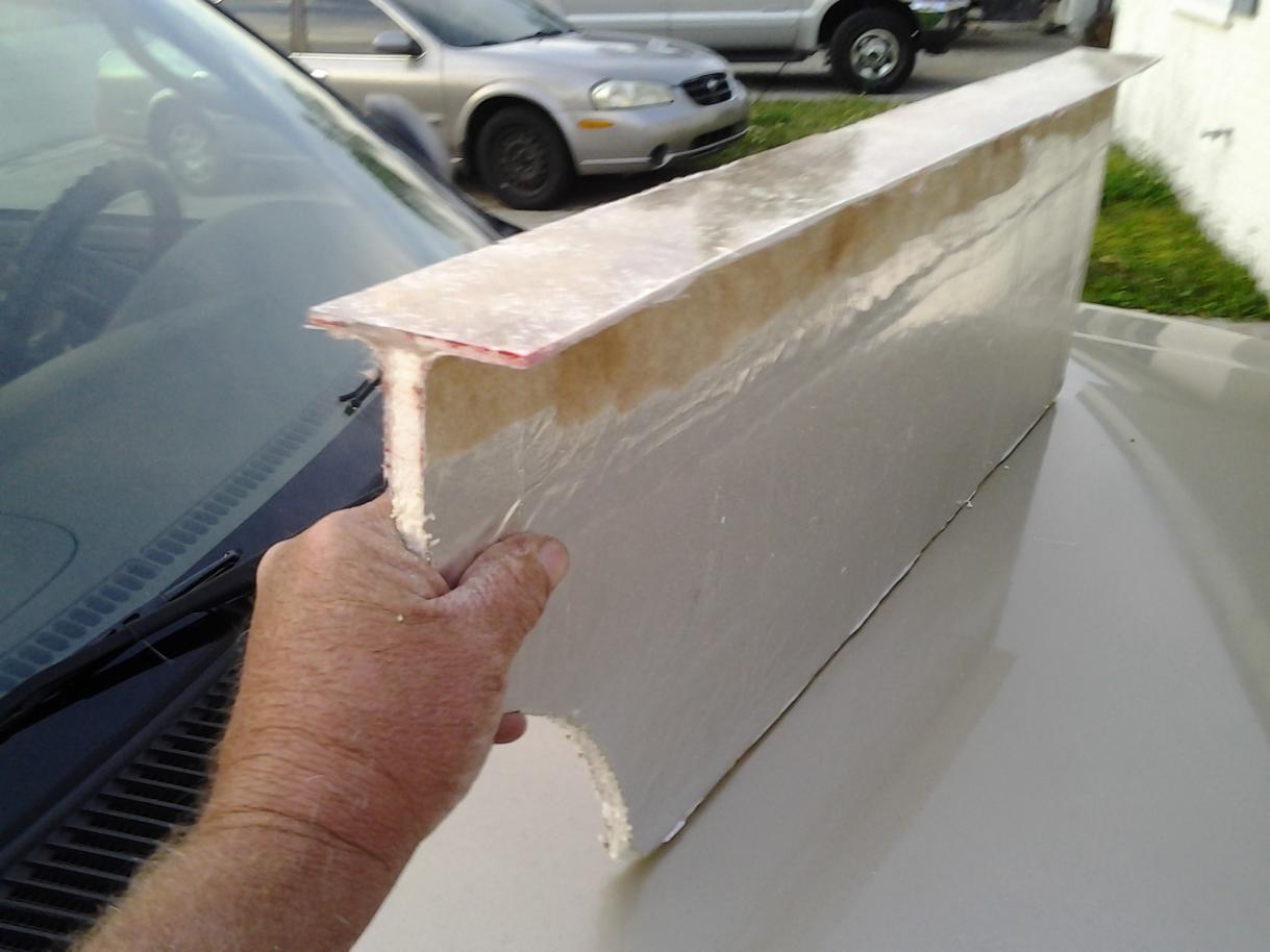

This is how im doing a small boat I have. First I made strips of glass. Then I stood the foam on them and tabbed them to the foam, I suspended them in place glassed the sides and tabbed them to the hull. The foam is simply a mold, the strength comes from the glassed sides. Seems to be strong enough for this small boat.
