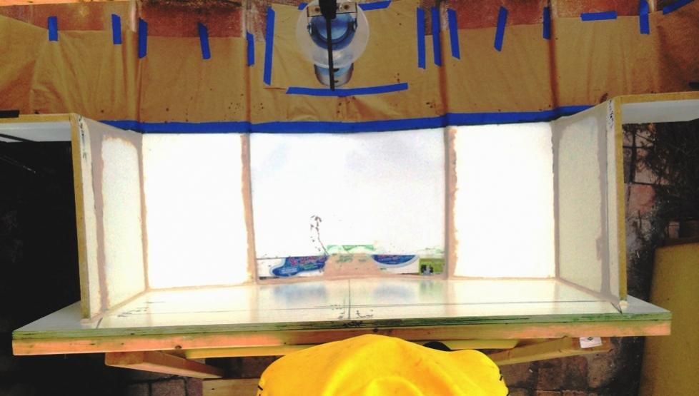

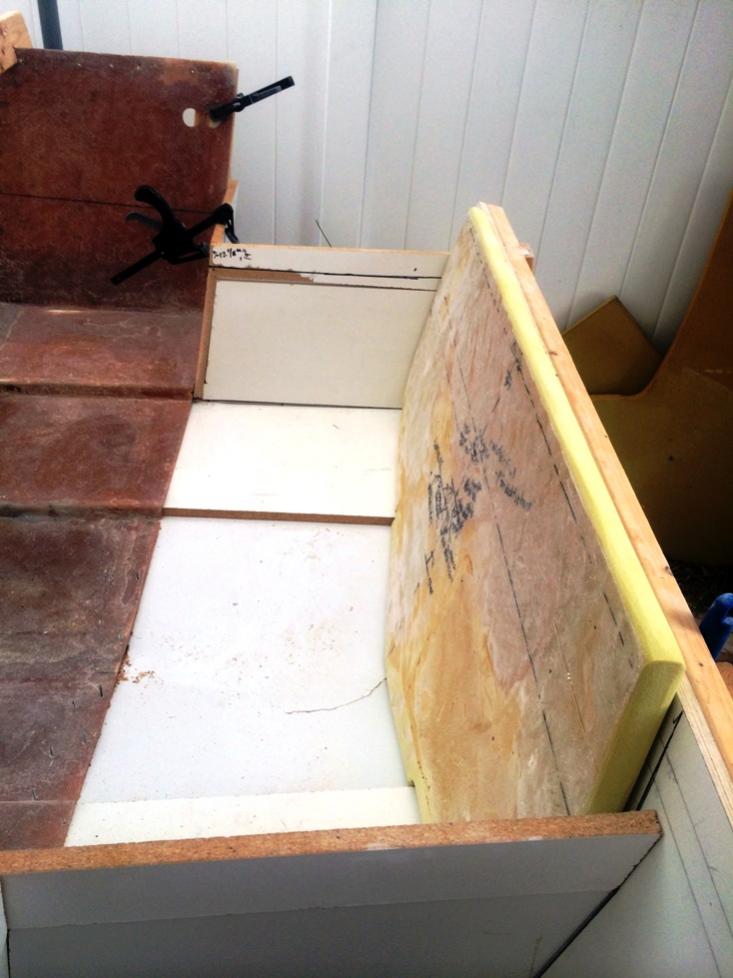

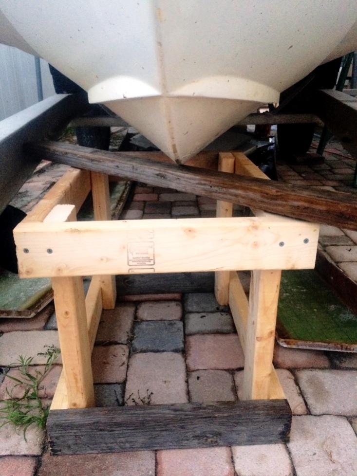

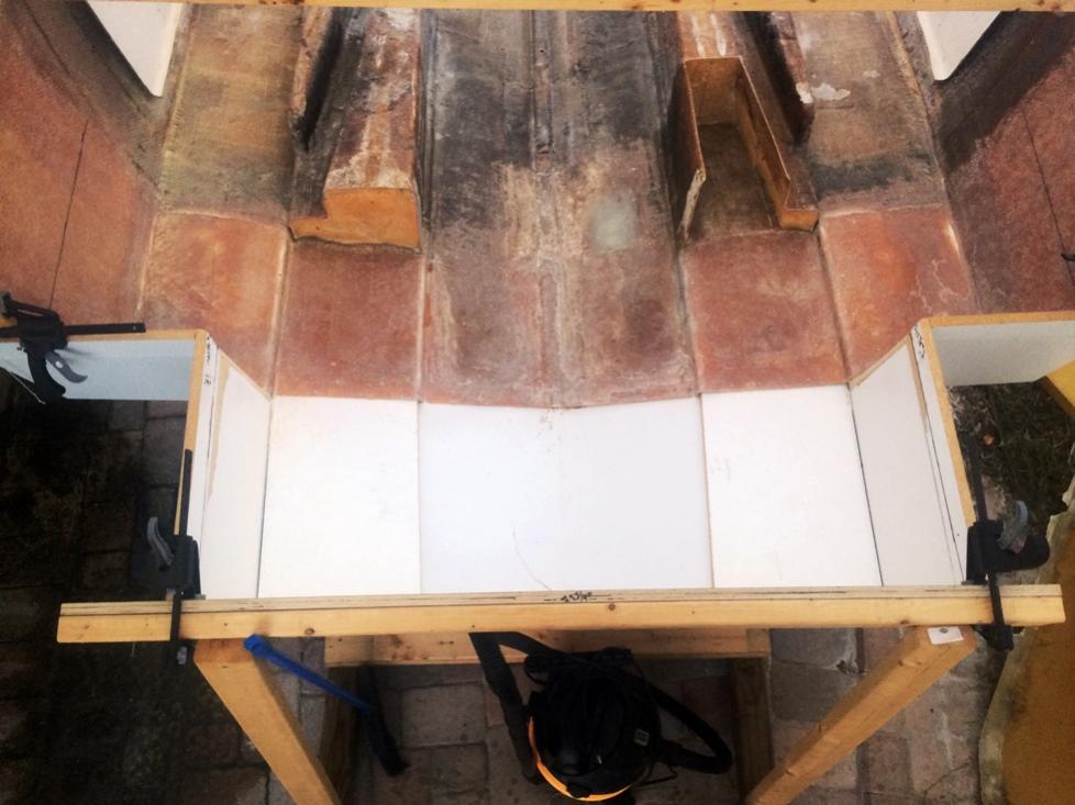

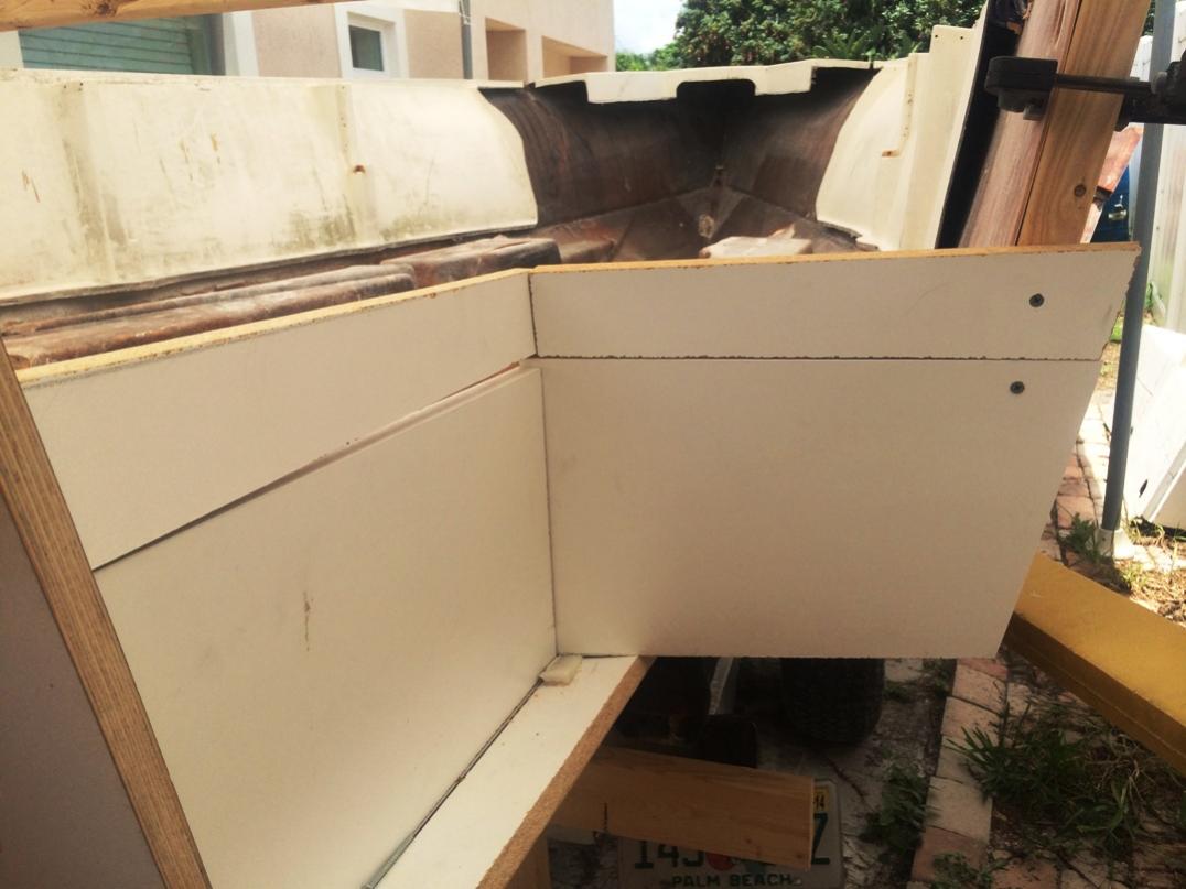

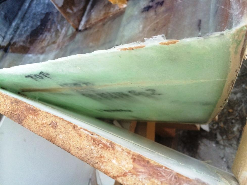

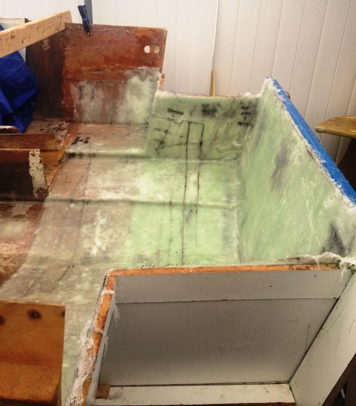

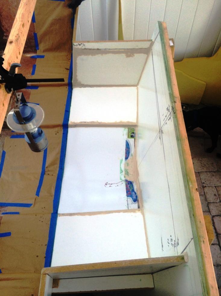

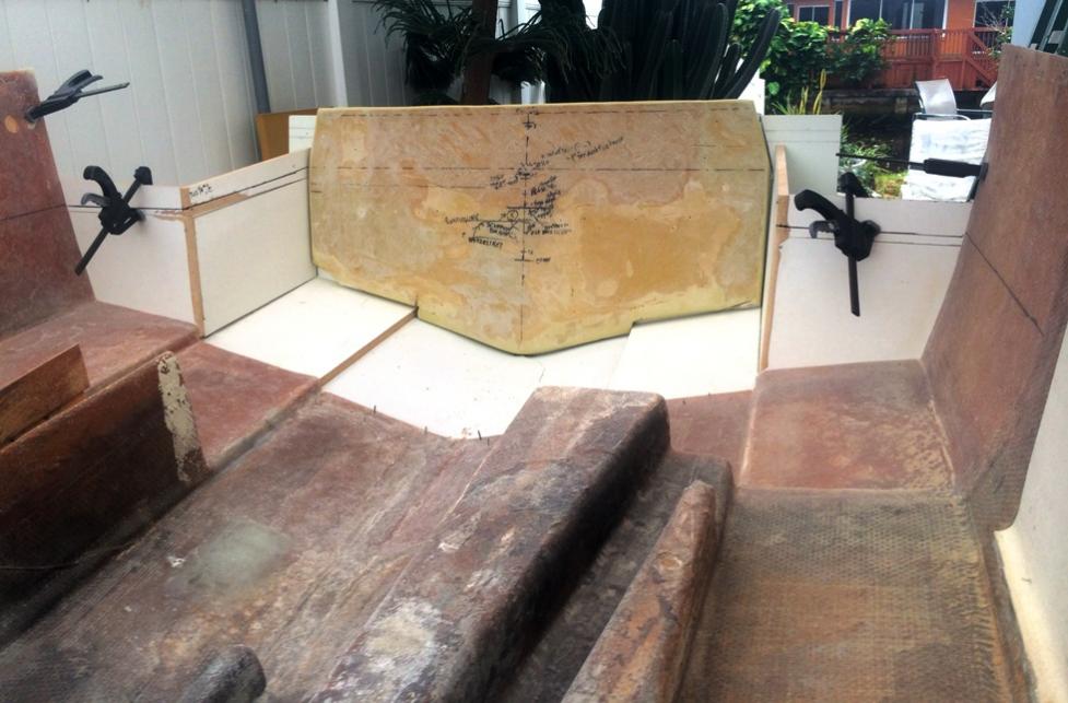

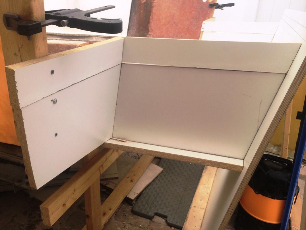

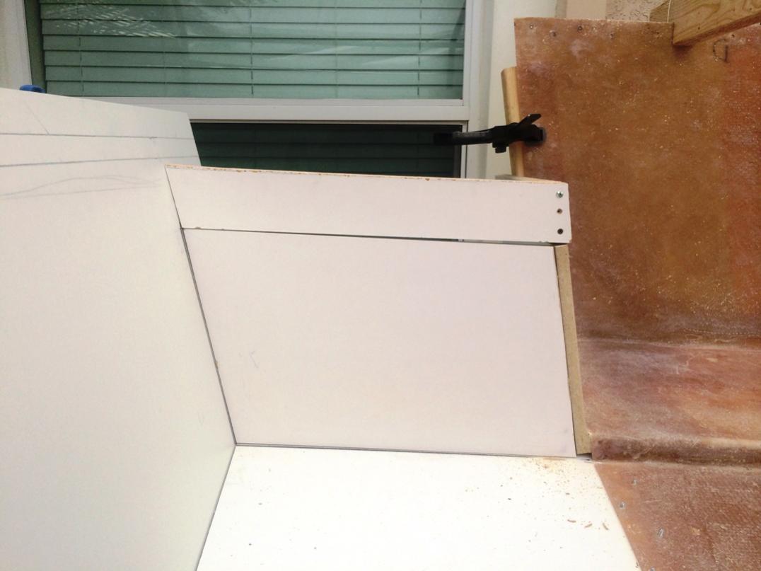

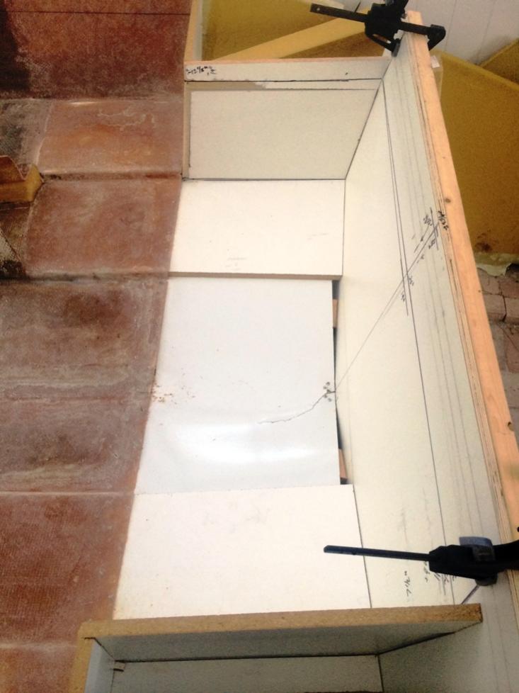

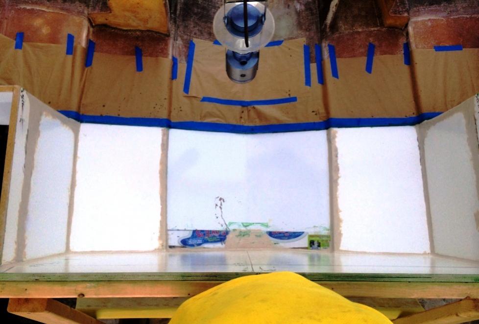

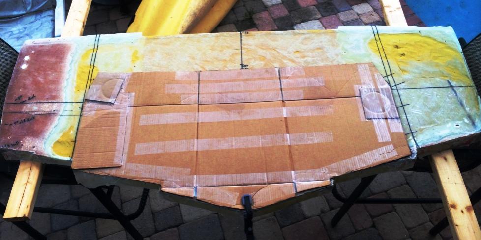

Finally got the extension/bracket mold finished; with all the rain and mess ups it took me a lot longer than I thought.
It is definitely a ton more work than closing the transom and making a separate mold for the bracket.
You can't see in the pics but I had to fully support the mold and hull, so there would be no movement between them. Every time I got in the hull or leaned on the mold it would separate!
Oh well, I wanted a project and of course picked a most difficult one!
I learned a lot esp. what to do differently and simpler- next time!
Waxed the mold three times and tried to spray Pva with PreVail sprayer- well that didn't work, so I brushed on the Pva. It came up with lots of fish eyes and streaks. It was ugly, which I could have lived with, even with a bit more fairing work, but there were areas that weren't coated. And finally with all this rain , the layer of Pva just lifted off by itself!
So reading on the West Systems site, they used hairspray as a mold release! Which is water based and the aerosol spray can made it easy to get an even coat on the mold. Two cans covered about 8 coats; trick is to spray light coats, esp. the first tack coat.
After using the stuff, I recommend the extra hold, unscented! Too bad it's clear- makes it harder to see the coats.
Decided to do a test batch first before committing to glassing the mold; sprayed some hairspray on the outside of the melamine board and brushed on some plain epoxy, CSM matt, and 1708 samples to see if it will separate cleanly.
Will see tomorrow if it's a go for glassing or I may have to add wax- again!
Lots of pics, in case it helps anyone else.

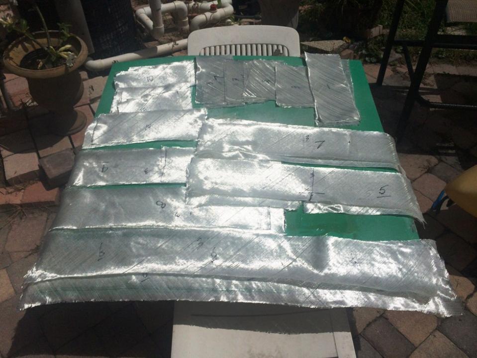

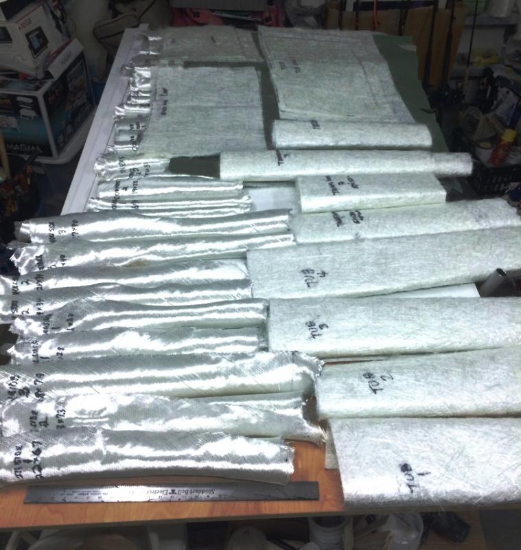

It took a lot of time to measure and cut all the Matt and Biax and way longer to lay it on.
And of course had to cleanup mold and hairspray/PVA it again.
Three layers of Matt and three of Biax, but with the overlaps, some areas, esp. the corners, have 6-9 layers.
7 gallons of epoxy including the thickened putty for the transom.
Finally with no rain, started the layup Sat. afternoon, continued through the night and got all the way up to installing the core and it didn't fit!

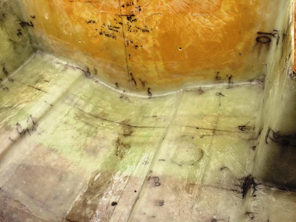

Next day checked it out; looks like I'll have to grind and repair in the corners, but overall the tub looks good.

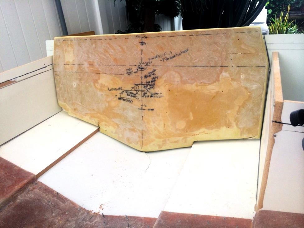

The transom has a nice layer of thickened epoxy and fibers that I'll have to grind flat to attach the core, but at least it won't be so messy.
My concerns are I have some white areas; small bubbles in the last layer of Biax, mostly in the hull forward of the tub; it looks solid underneath. I'll fill in the small holes with epoxy and grind the larger ones out and glass them.
There are some bigger areas, between the strakes and going up the sides, that I'll also grind out and lay Biax.

Most epoxies that I've used won't dissolve the binder that is used to hold straight matt together, the polyester family works best for this. Biax is not an issue with epoxy because it is stitched together. Your white spots most likely are the results of the incompatibility. I have been in the boat repair/restoration business for 30 plus years and learned this the hard way as well.

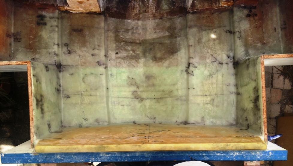

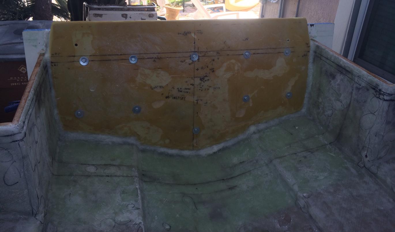

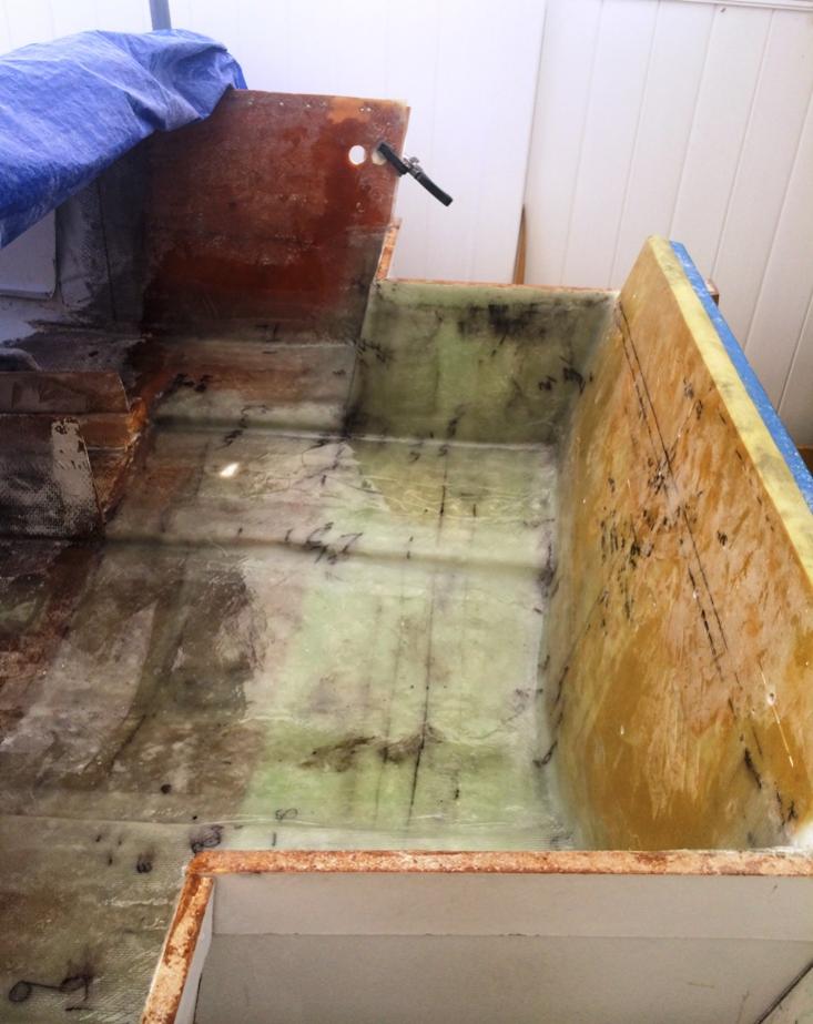

Transom core is in; at least that came out good.
Ground out all the white spots since and repairing them.
Removed a lot of the Biax, and the underlying Matt was good, so laying in fillets and Biax tape on the edges and then glassing again.

Removed the white areas: chiseled out the big areas and drilled/ground out the smaller ones, then grinded and sanded it; ended up removing a lot of the Biax. Filled in the holes with 1708. The underlying Matt looked good; probably soaked up a lot more resin than the Biax.
Then more grinding/sanding. I hate wearing the full suit in this heat and humidity; lose 5 lbs every time.
First troweled on thickened epoxy with Cabosil and chopped glass fibers, onto the edges to make my filets, and filled in some small areas that weren't level; this is what looks white under the Biax and not air bubbles like last time!
This time I rolled out the epoxy on the Biax tape on a wetout board, rather than pouring it in and using a large squeegee; I fileted and triple taped all edges. It went a lot faster- only 5 hours and one gallon of epoxy.
Came out a lot nicer than last time. It's now about 3/16" thick at the flat sections, 1/4'"at the edges/overlaps and 3/8" at the transom corners.
Going to fill in the middle sections where there's no overlap and even up the surfaces.
Seeing that the mold separated from the hull a bit in the outside corners, I took a peek and it looks smooth- way less fairing!
The center of the corner panels are only about 1/8" thick, so I'll build that up with 1708 and probably another layer over everything.

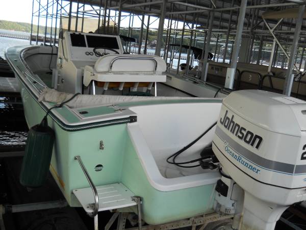

Theres a 23 for sale in chicago craigslist with a similar setup. Newer model but neat setup.
  #50
Old 09-16-2014, 11:35 PM
dave s dave s is offline
Join Date: Feb 2014
Posts: 137
I could have saved a lot of work, buying this!
Interesting tub design; doesn't go all the way down to the keel.
Reminds me of an Intrepid.
I have a similar Euro style transom on my 18' Sea Hunt; bilge access sucks and water loves to sit there, or leak past the deck plate.
I can't understand why manufacturers make the tub to hold water, rather than raising the transom to hold the motor and have enough room below it for the cables and steering, and make the tub flat.
I'm putting a level swim platform across the whole back.
