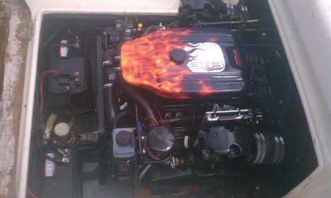

Here is the 383mpi stroker.

Decided to put a 383 stroker in my 73 Tsunami when I restored her last year when she turned 40. It is paired with a bravo one and will hit 52-53mph top end and cruises at 28knots. Had a 350mag prior and although it was more economical it is a totally different boat since dropping in the 383.
