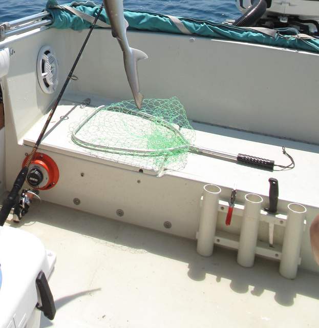

I thought you were gonna re-gelcoat the whole boat, but maybe that was just for the bottom and transom repair, so gel coat makes sense if that's the case. I haven't tried to spray Signature paint. Island Trader looked into it and if I remember correctly, the guy who painted his boat wasn't comfortable with the support he got from Tom for spraying it. It seems to be primarily made for roll & tip DIY applications and I think that's ok for the interior, as the finish there isn't as critical there as it is on the outer hull IMHO. I repainted my aft seats and inside of transom with it using a roller about a year ago, and frankly did a lousy job because I didn't apply it thick enough as I was trying to stretch some leftover paint! Pic below shows how it turned out . . . it's got some orange peel in it and I never did buff it, but it still looks better than it did before! It's tough paint and makes for an easily cleaned surface.

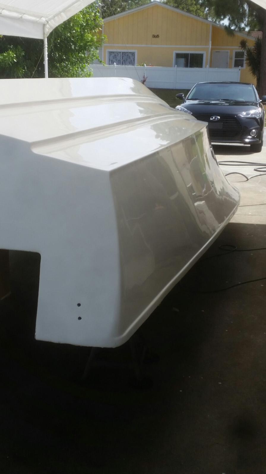

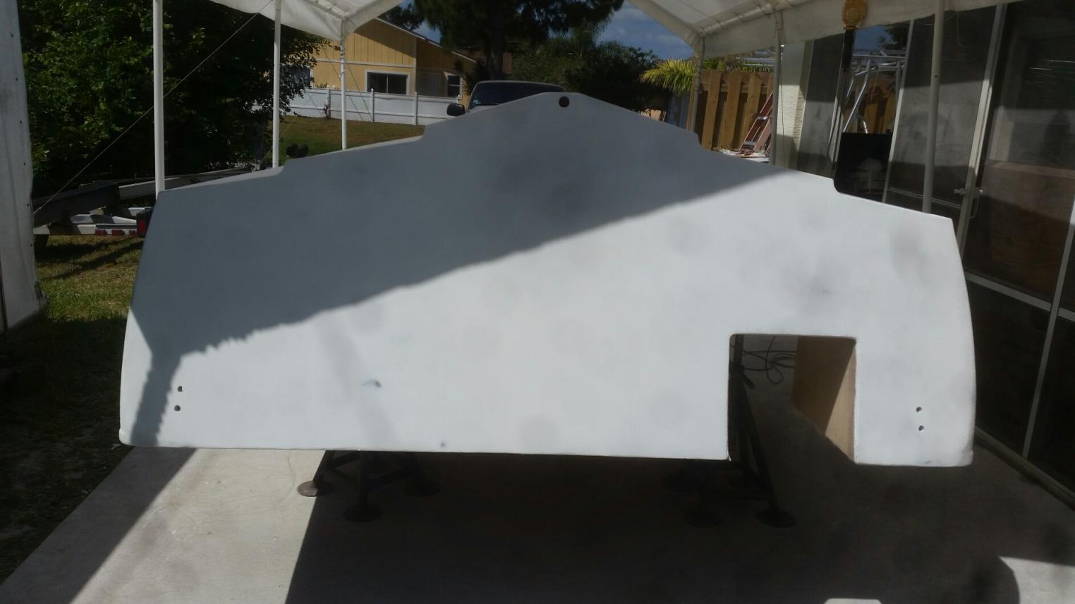

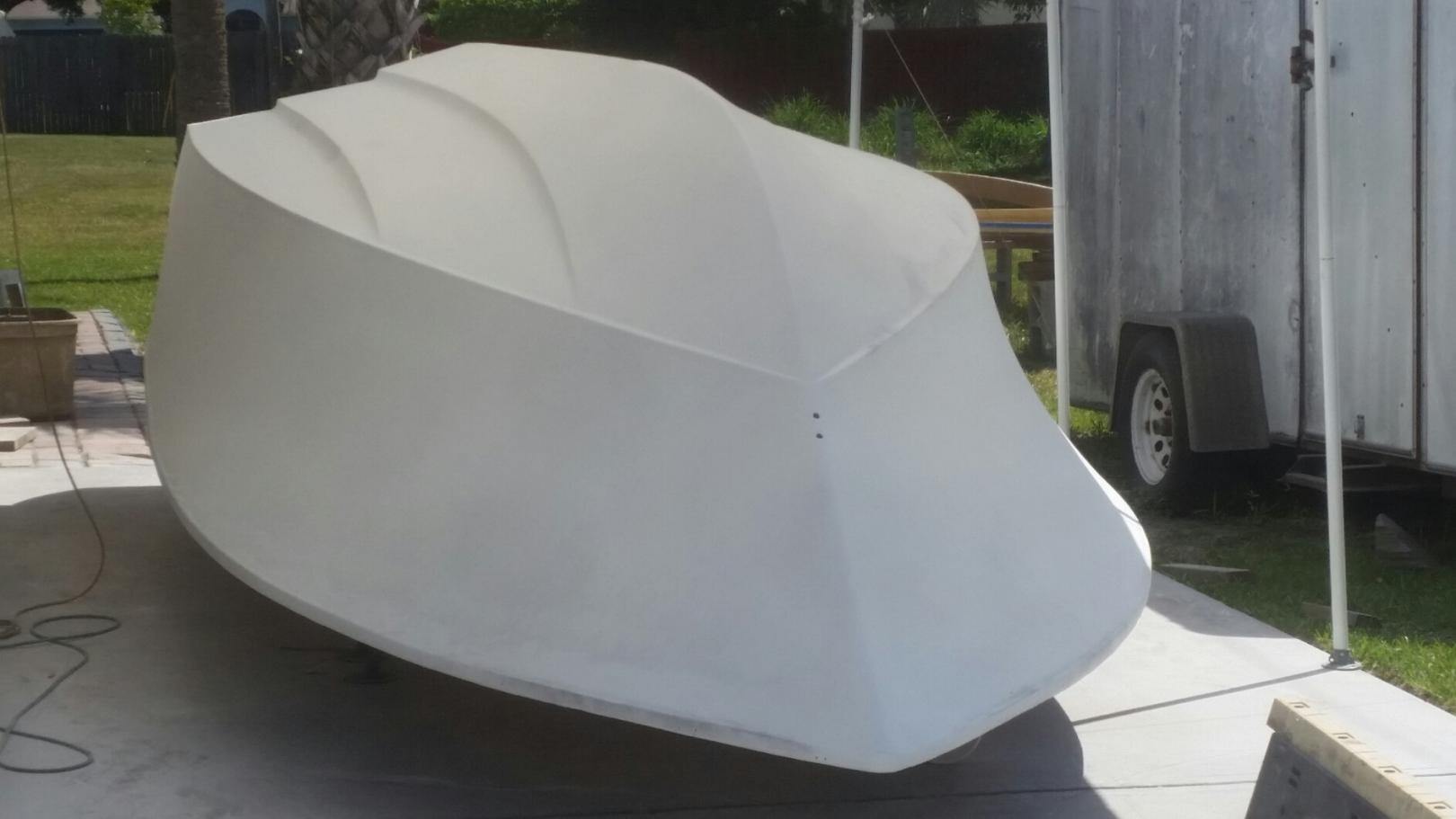

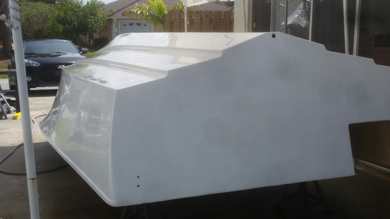

I really appreciate all the detailed advice! I ended up rolling poly gel and have started the sanding process. Burned through a couple spots on the transom repairs. Thought I had it faired good enough but guess I didnt. Nothing more gelcoat won't fix. I rolled 4 layers non waxed and the final layer waxed. Sanded the bulk off the orange peel with 40 grit hand sanded all the edges with 60 grit, and am in the middle of sanding with 80 now. The plan is 40g 80g 120g 180g 240g 400g 800g heavy duty compound and then some polishing. That first round with 40 was a bear but now it's going much easier.

Most of the spots in the pics are due to my broken camera lens but you can make out the couple spots where I sanded through on the transom.

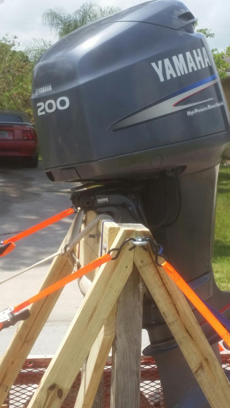

Oh and finally figured out the engine! Test drove it compression looked good and got a great deal so hope it works out!
