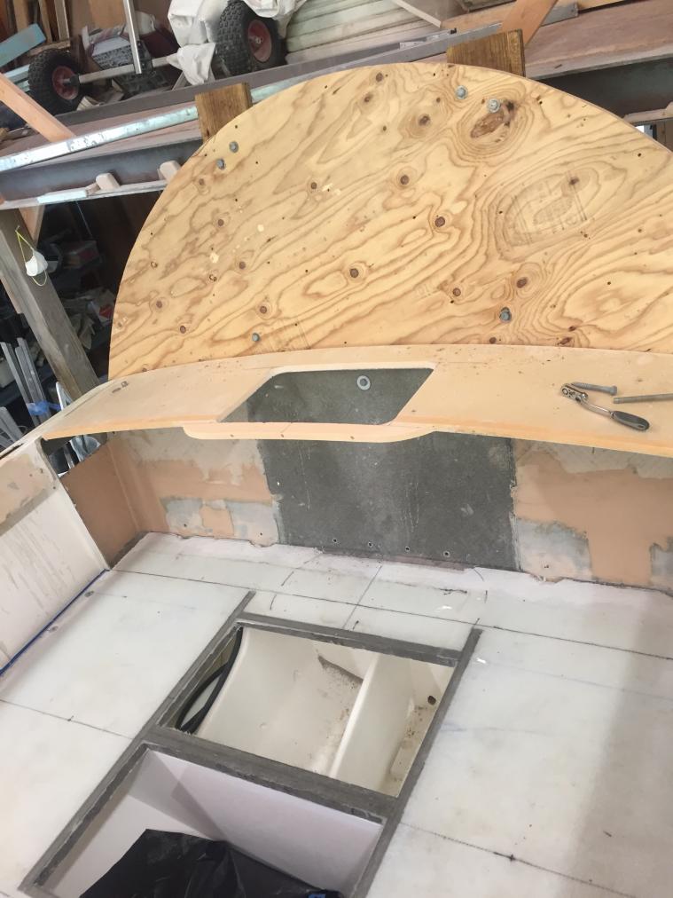

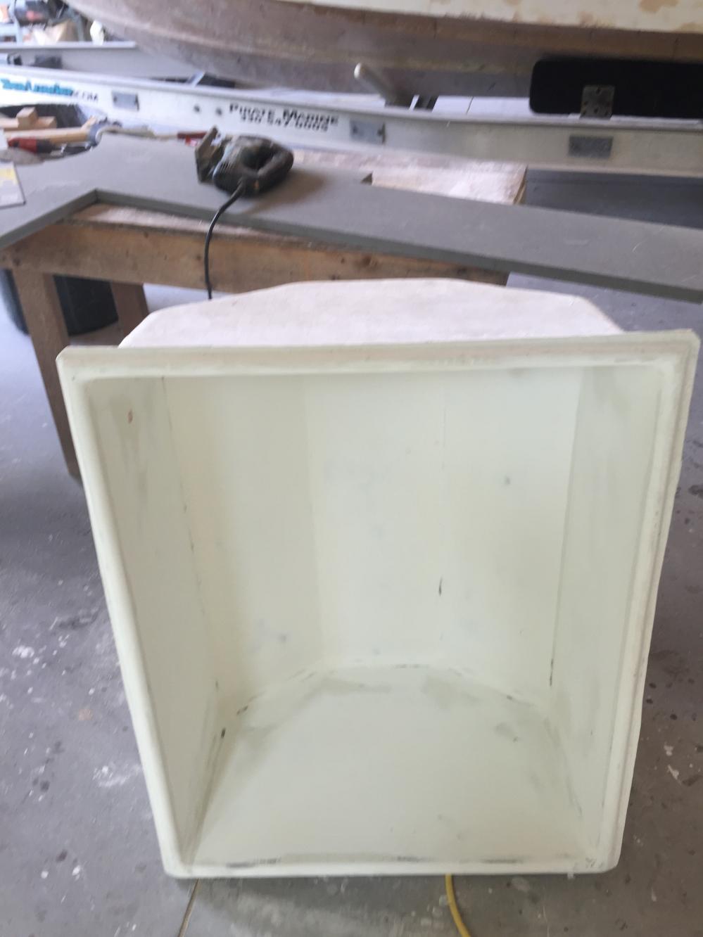

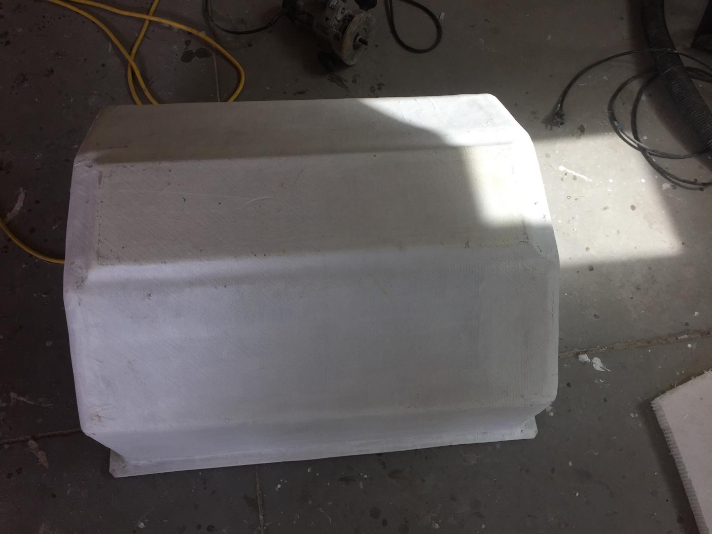

We are putting in a transom bait well, not a large one. We made plywood forms for bending the foam. If you recall, we have about a 13 degree angle, so we had to make the bottom form smaller front to back dimension, but the same curve as the top.
We scored the foam vertically on the corners where we wanted to bend about 2/3rds thru. At this stage you gotta be careful not to break. We screwed down the foam and glass the inside and out with two layers of 17 oz. Then we could remove it and it was solid. Then we cut the top and bottom from the plywood foams, tabbed, etc. Now just a lot of finish work. Note, we did round the back corners as we did not want to kill the pogies. The later pictures you can see Richard dry fitting the baitwell along the transom top, which he matched.

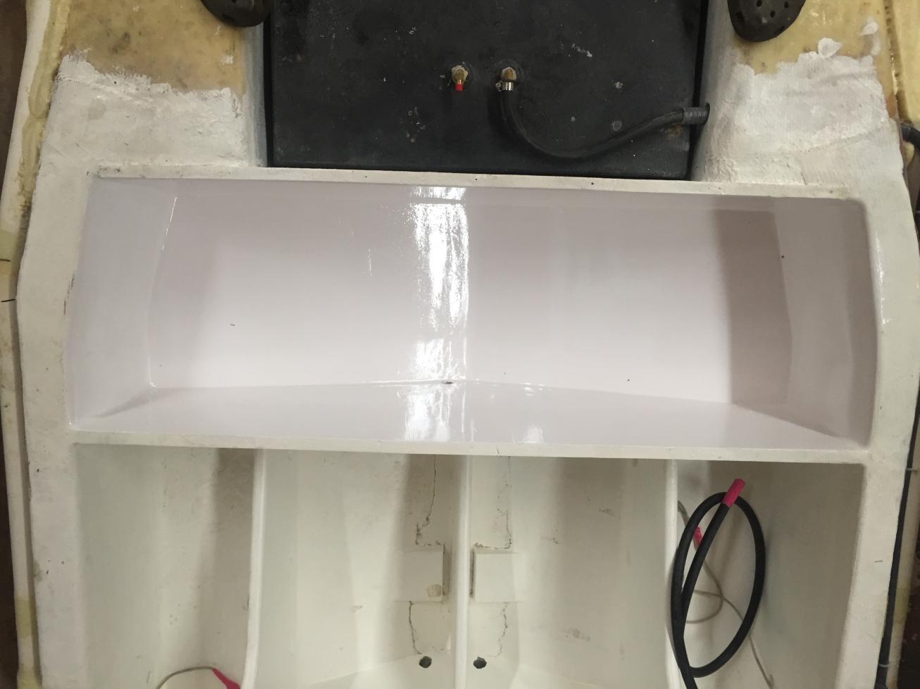

Forward locker we are reusing. We previously reinforced the forward tray/locker that held the aux tank. We put a piece of foam on the bottom and faired it.

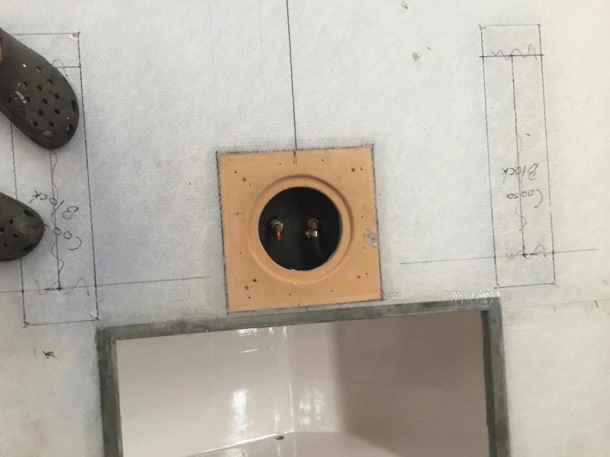

Since the deep V of the seacraft seems to collect quite bit of water forward, UNDER the forward locker, we installed a low profile bilge pump under it. The only problem is that there is no access to pump, wiring hose.
Solution. put a access hatch in the bottom. We cut out a panel just above the pump, large enough to install the pump, get to hose etc. We ran wire up the outside of the locker and made another cut out and mounted a electrical terminal block on the forward part of the fuel bulkhead. Thus, we can replace the pump by just swapping out the pump, reconnecting the hose and running the wires about 2 feet to the electrical terminal block. A round deck hatch of course covers the hole.

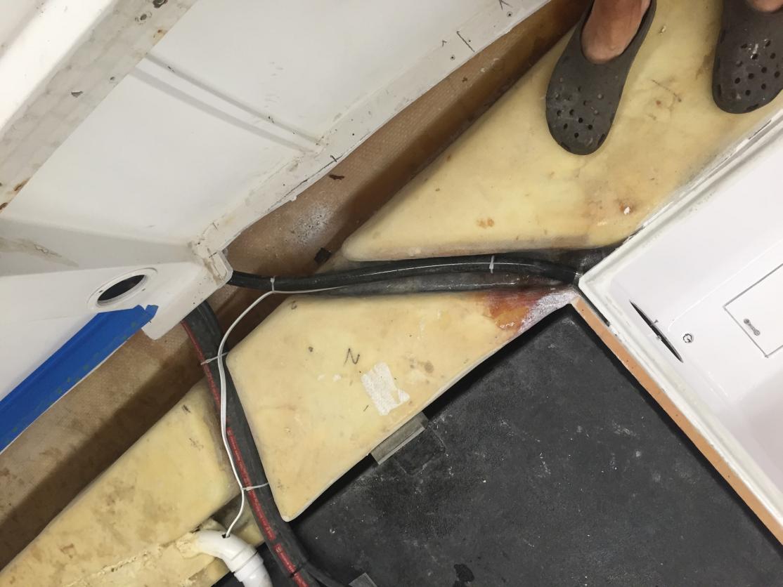

The last photos shows the routing of the bilge hose out the port side, using the track the old aux. fuel tank. Wired with three way wire of course to helm. We are not using that funky corregated bilge hose. We ordered reinforced 1 1/8 labeled as bilge hose. Did not wish to try and change that hose with deck on. Good stuff.

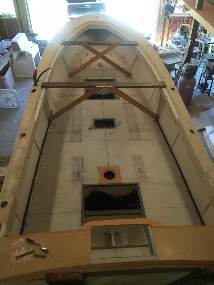

Default Some misc pictures of deck, hatches

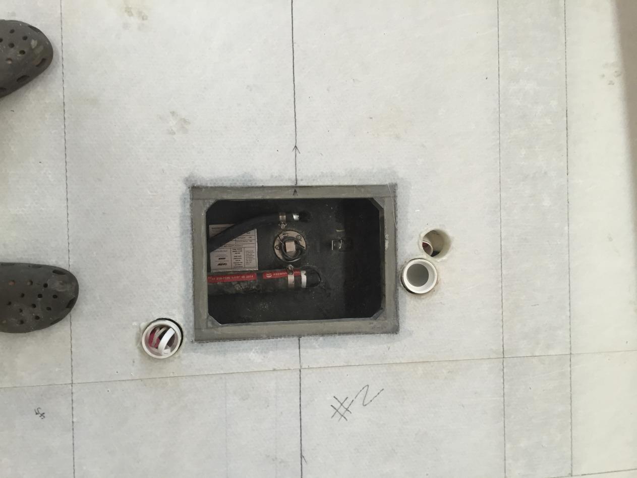

First picture is of insulated in floor fish box. Reminder to self, drill drain hole...
Second of bilge area with landing pads for bilge pumps and holes for bracket.

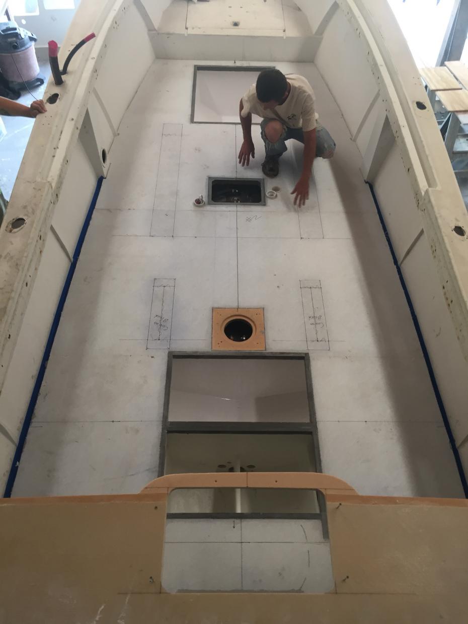

Default Test fitting deck and glueing on edging of coosa
The deck in this picture is screwed down to its final resting place, temporarily. The dark edging on the side is blue tape on what will be the gutter and to prevent epoxy from glueing down the deck prematurely. Richard had epoxied the half inch strip of coosa to finish off hexcell core. He used wedges to perfectly make the gap even. The epoxy was really to just tack the piece in place. Tomorrow we will remove the deck, finish filling in the epoxy and then we will glass the entire edge to make it solid.

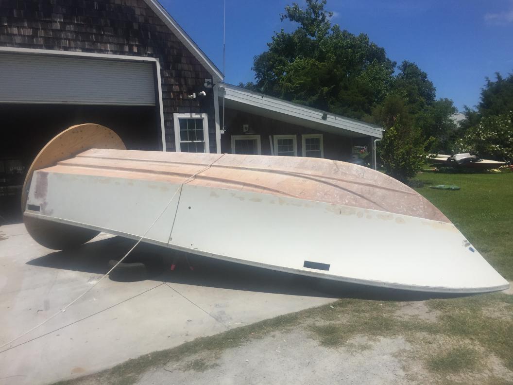

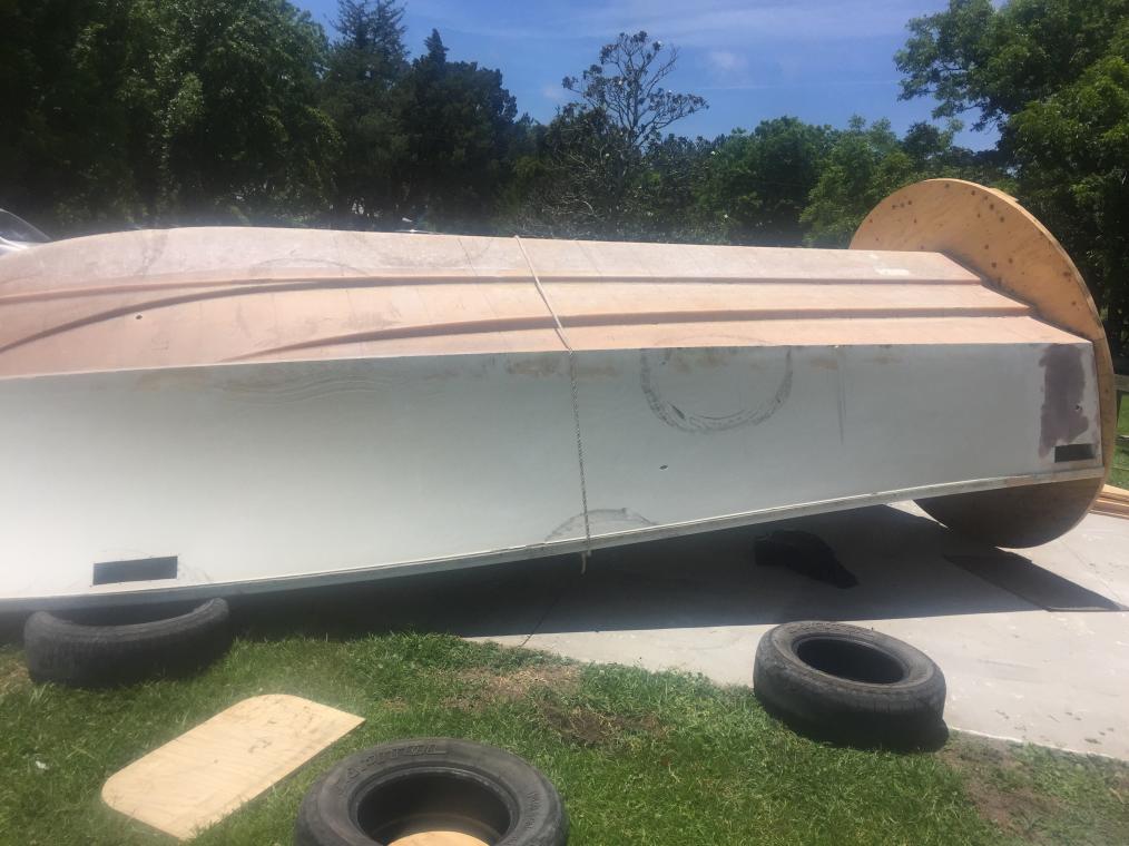

Default How to flip a 23 seacraft easily

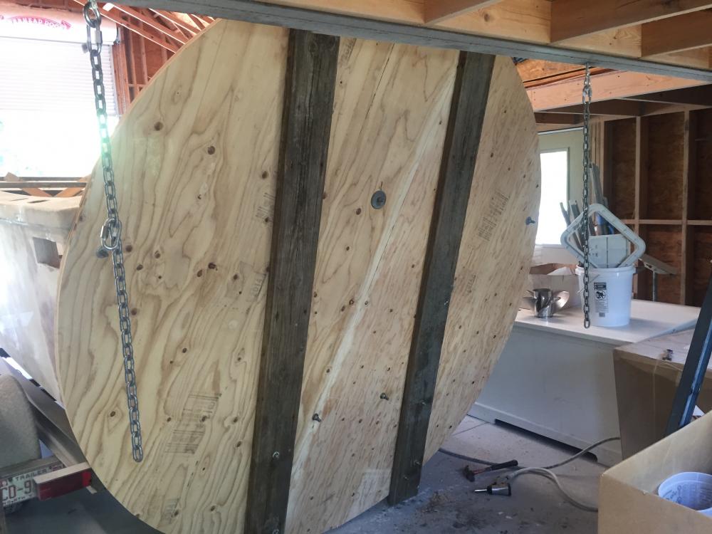

Well, we temporarily screwed the deck in place and put one layer of 17 oz on the top.
Now we wanted to flip it and fix the hull.
We put some reinforcements on the gunnels first.
To flip it, we screwed 4 sheets of plywood together overlapping 90 degrees. Then we cut an 8 foot circle. We reinforced with 2 2 x 6's. If you recall, we had already test mounted the bracket on the transom and had half in holes going thru. We drilled one more at the very top.
We thru bolted the "circle of death" to the transom. One thing to note that circle weighs about 200 lbs and could crush someone. To screw it on the transom with about 5 inches of clearance, we jacked the trailer up. Then when we hooked it up it would not scrap.
We found that to flip it, it was best if we ran the rope amidships.
