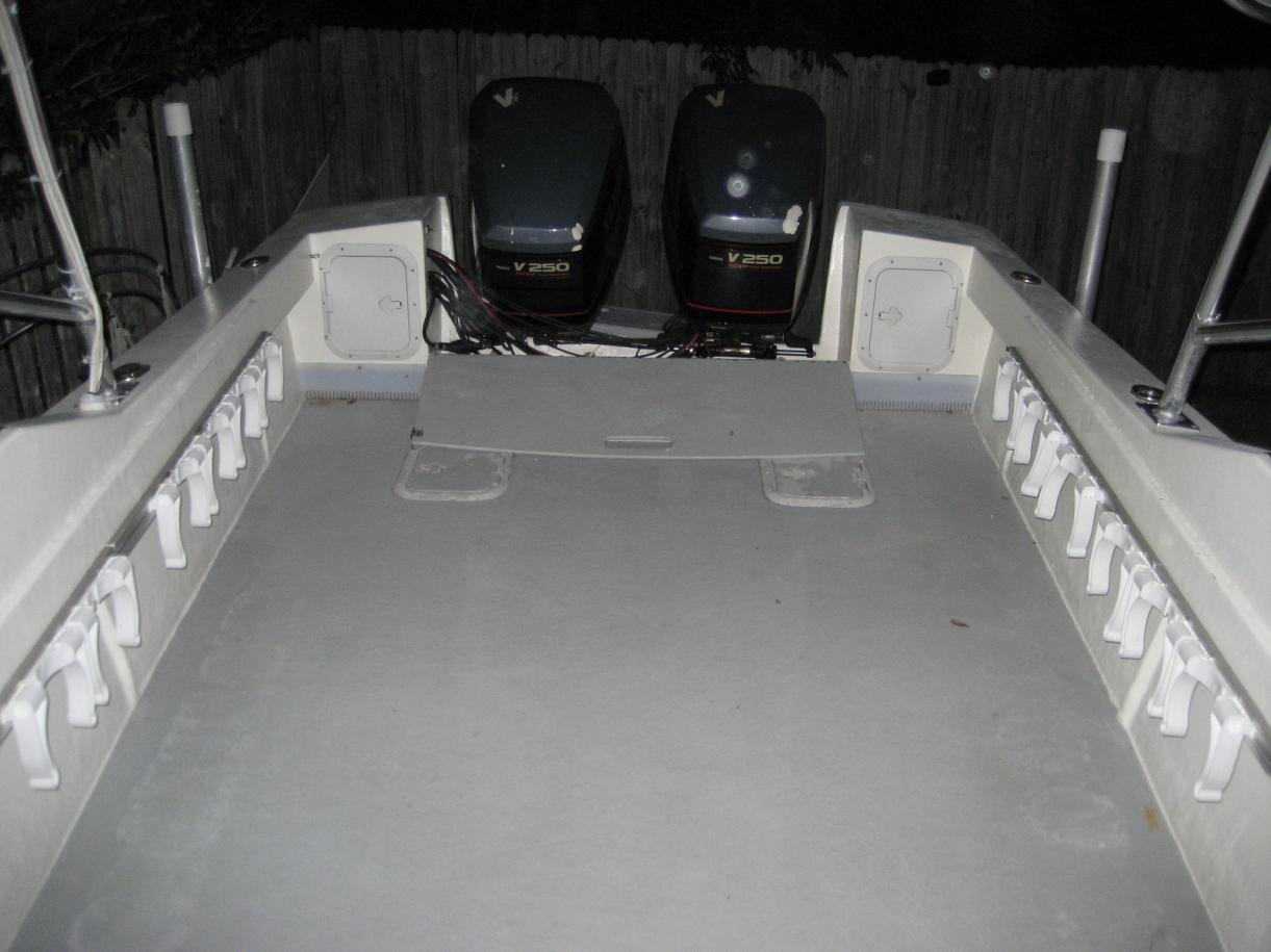

Mine had twin 250s on it with the previous owner. Not sure how fast it got as the chine walk was so bad you couldn't hold it to find out. Now I run half the HP and still get 40+ knots fully dressed.
Here's a pick of the twins.....

mine had twin 250s on it with the previous owner. Not sure how fast it got as the chine walk was so bad you couldn't hold it to find out. Now i run half the hp and still get 40+ knots fully dressed.
dayummmm........😱
