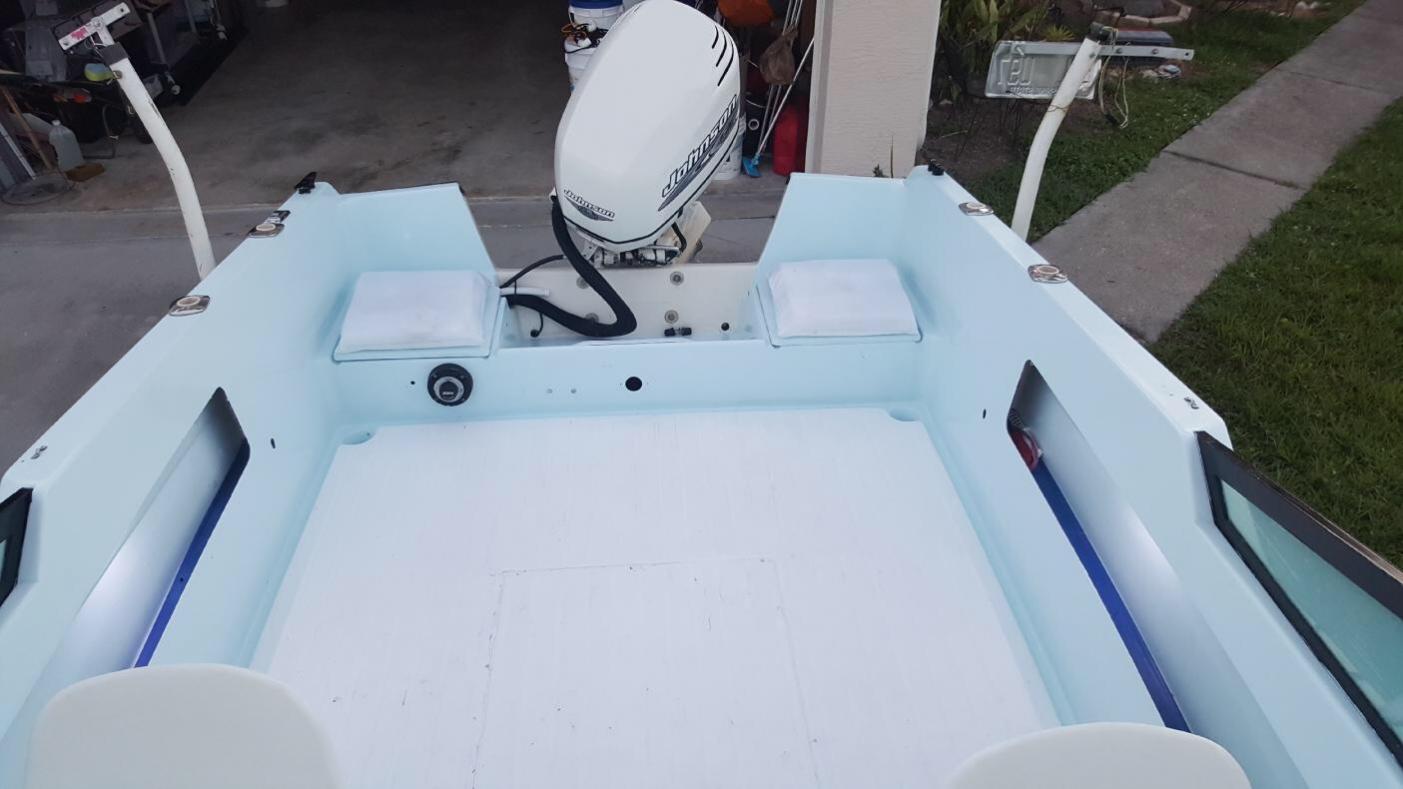

This looks similar to my conversion from I/O to outboard vision. I reached out to a member who did a one off engine cowl similar to a Sea Vee, but he did not have a mold. If I were very careful removing glass integrated portions of the original Dog Box, would anyone be interested in building a mold for reproduction. This one is really in great shape?!? Maybe Hermco?
Vezo, Part II
Old 09-18-2015, 12:31 PM
I guess it's time I learn to correctly size my pics.... Apologies.

Michael, glad you successfully removed the fuel tank and survived cutting it. Now you'll have another discussion topic for the fall gathering. My 1976 Seafari 20' is an outboard (from birth). The 1976 SeaCraft brochure shows the Seafari had a 47 gallon tank in the outboard version and 38 gallon in the I/O version. As for your ride on Denny's ETEC powered Seafari, yes they are torquey, particularly in the lower rpm range. There was a BRP video which showed identical boats in like a tractor-pulling contest; the only difference was ETEC vs Merc and ETEC vs Yamaha. The ETEC won hands down. This low end torque was actually a problem initially for me holding a constant wakeboard speed until I overcame it with a High Five prop and a PerfectPass speed control. I have been happy with my ETEC once I overcame this issue- the ETEC is quick starting, quiet, and thrifty on fuel.
