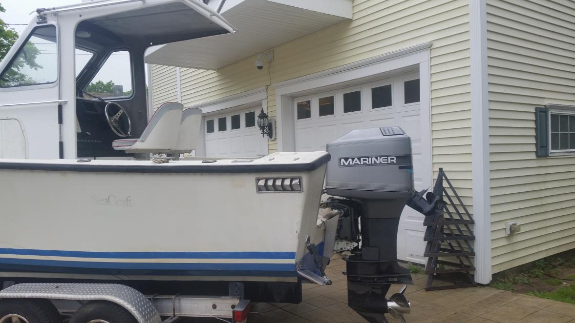

Hello, I have 1973 20CC with a 1998 225 EFI Merc. Put the boat in yesterday after installing a new garmin gps. The problem is, with 4 adults and 40 gallons of fuel i was only getting 48-49 miles an hour. The question i have is anyone running same boat with similar power and what numbers are you getting and full throttle? compression test today. thanks
