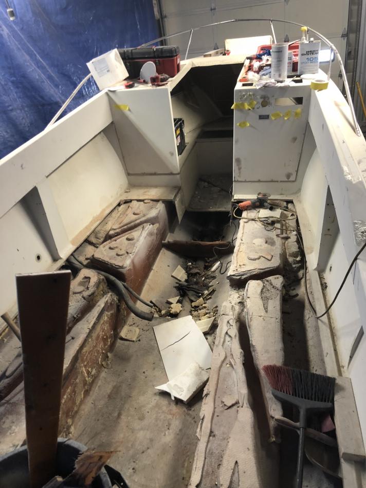

Got about half the floor out with a circ saw and crowbar before the batteries died. Will get back to that this weekend. Foam was not wet but the floor is mostly rotten. Looks to me like the original stringer grid. I will inspect the foam in the stringers this week.

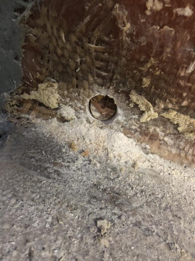

Got the transom cap and floor removed. That's the good news. Bad news is that the stringers are wet from about midship to stern. Transom is rotten but I figured that. I will be cutting off the tops of the stringers and putting new foam in. Question is- since the stringer foam is dry forward, do I need to replace that too, or just leave it and re-foam/re glass the wet part? The goal here for me is to NOT remove the cap.
Old 07-13-2018, 04:57 PM
Leave the dry ones alone. You might be able to dry out the wet without removing. Drill some limber holes and let it wick out. The center is PVC not structural so leave it alone.
