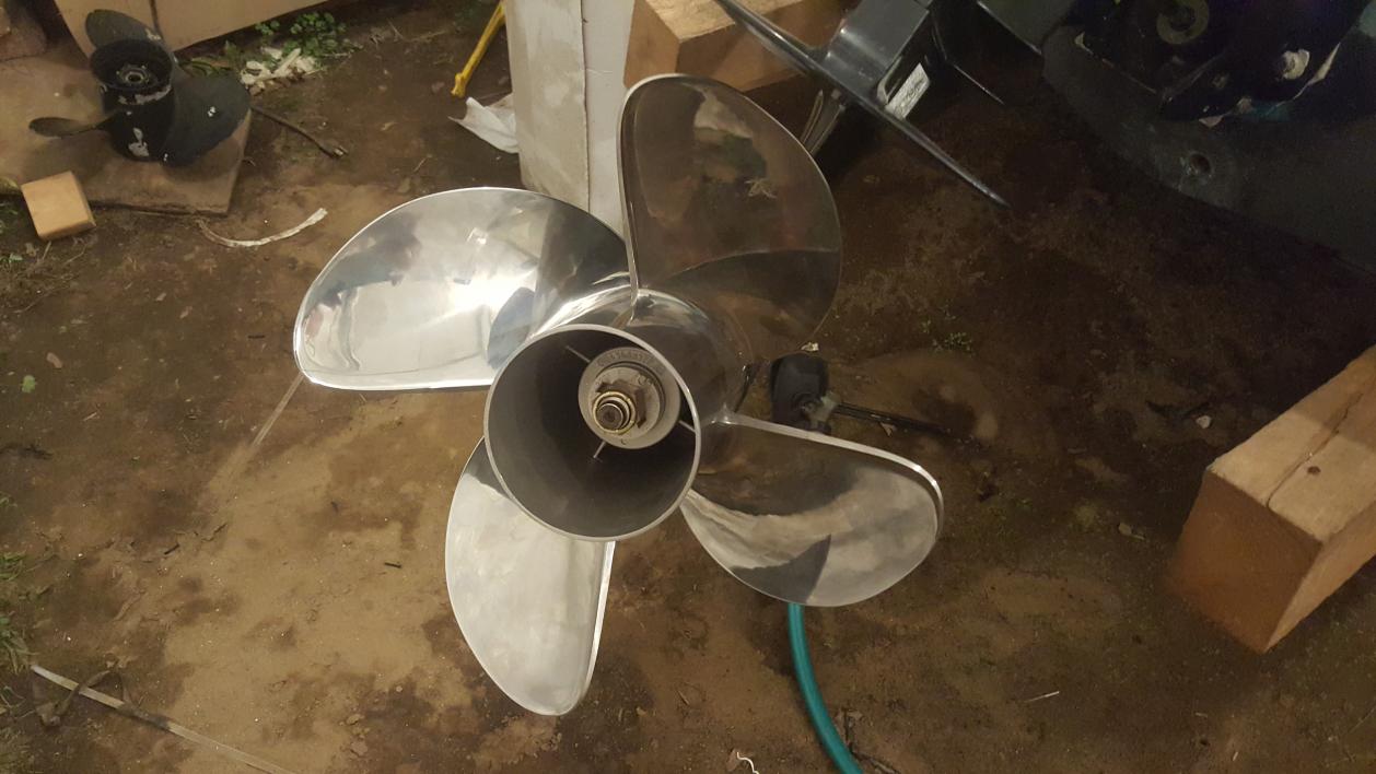

Here we go. Rev 4 17 pitch. Going to try it out tomorrow!
