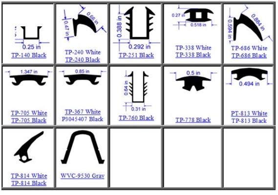

Interested in this too as mine will be needing replacements. Just John, sent you a PM. Bigeasy, are those all the same profile? Cant tell from the angles. big easy, yours look like the 686, can you take measurements to see if they are close. Thanks

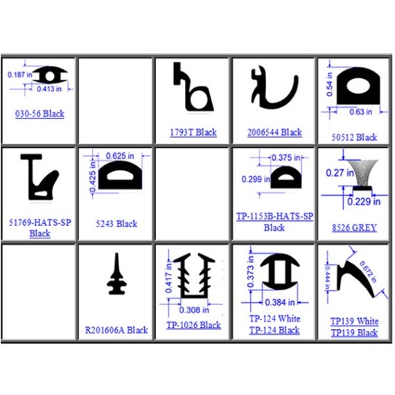

Here are the specs from the website.

I'd assumed TP-139 for the cuddy and TP-686 for the windshield, based off previous posts, but you know what they say about things you read on the internet!?!
I'm not sure I'll be taking the plexi out prematurely, but I'll take a caliper to the seals (outside lip) when I get a chance. My starboard side cubby window leaks (or corner of windshield?), leaving the cabin foam wet after rain/rinse, and causing rust stains, etc... so that's the priority. I still have the winter tarp over the boat for now so all's good at the moment. I'll be measuring lengths-needed also, as it's not posted here for my Seafari. Projects are stacking up, and overlapping. I have some glass repairs to do on the starboard side adjacent to the window frame (heat cracking... from our house fire in 1989).

So the dimensions for my cuddy window seals outside lip measure .4"-.43" wide, vs. the TP139's .672". One question I initially had was whether the shorter leg of the seal was the one "outboard", but based off the assembly pics strick posted, the larger seal leg does in fact goes outside while the shorter leg gets pressed into the aluminum track. Mine may have shrunk substantially over the 42 years. I am certain if I take the existing seals out, they will not go back in due to being hard and crunchy. Obviously the inner leg and inside profile are the critical ones, and the longer leg dimension may "shrink" as it curves/curls after assembly.
Sorry for the slow reply, all the glasswork in my Tsunami/Sceptre is the tp686 weatherstrip and the measurements are the same as in the picture on the top right in your picture of the catalog page that you posted of the American Marine web site
