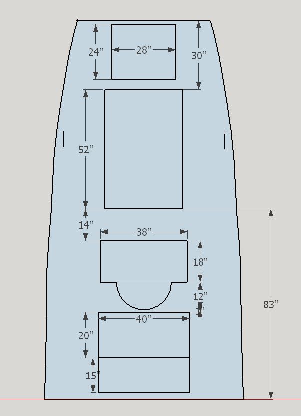

Look great,how many inch from transom bulk head to back console?,I like to know that dimension for my setup with live well leaning post... with the 30" shaft is rocking to much at drift or anchor it? thanks

83" give or take. i wouldn't know the difference at drift between the 25"/30" shaft but we are only talking about a 5" difference vertically. I would think a hard top vs soft top would change your vertical center of gravity and tippiness more than 5" of engine
