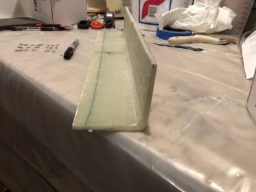

Or you could make your own. I wanted to get rid of the aluminum angle that holds the gunnel sections in place on my 18. I think this is 8 layers of 1708 with epoxy and it is solid. Made me feel much better about the strength of the things I was doing as a rookie.
