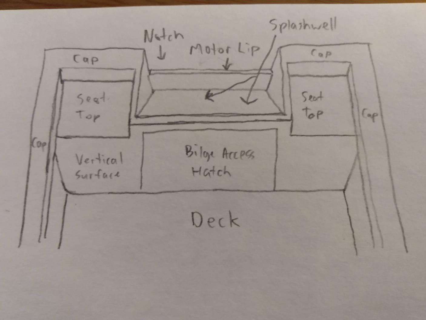

8. Motor splashwell and seats area made with the honeycomb. 25" in from transom to allow motor to full tilt up.
8.a. Splash area will have a panel at 45 degree angle up from transom 19.5" up from the deck still allowing full tilt. The angled panel is to allow bilge access.
8.b. Seating on either side of splashwell. Seat height will be around 14" to allow a 5" or so backrest and hip support on each side. Seats will be about 18" deep and 19" wide. This area is plan B for the batteries. I would prefer to keep these areas under the seats open for storage or coolers or one of each.
8.c The vertical panel in front of the seats and splashwell will have a hatch in the center for bilge access. The opening should be about 18" high and 24" wide to reach down in under the 45 degree panel between the seats in front of the motor.

My description of the splashwell sucks, but I cannot figure out how to explain it. Again the drawings for the motor show distances of 23.7" and 22.5" respectively for clearance from the transom when the motors get fully tilted up. I wanted to give it a little extra space so the cowling won't touch so figured 25" for the front splashwell wall from the transom. Pictures would be worth a thousand words here so maybe I will do a mockup with cardboard to show what I am thinking.

A quick drawing to help visualize the interior stern. Splashwell in the center with seats on either side. The double arrow pointing at the splashwell is the panel at 45 degrees coming from the transom to the top of the front of the seating/splashwell area.
