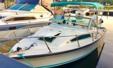

Here are some photos of how Bushwacker rigged his Seafari. I have keep it the same. Even when I have the family out I always seem to be single handing. There is always a line available no matter what corner you need one. The hawse pipe/anchor roller are good advice too. The rode and chain fall right in when I pull up and the anchor stows quickly so I can get back to the helm.

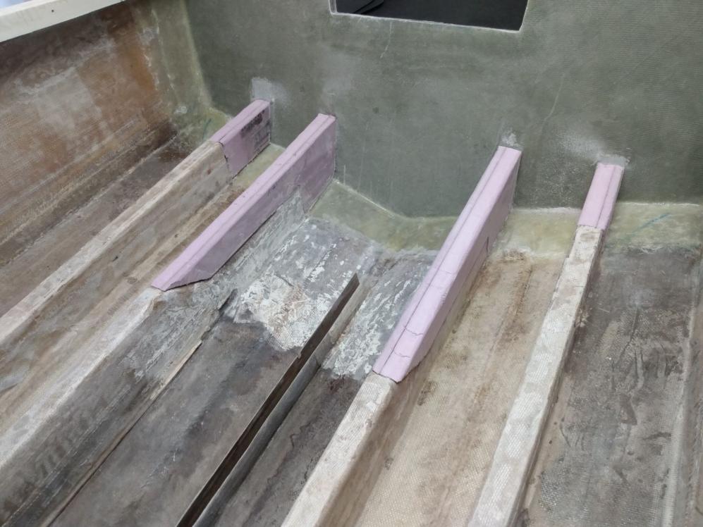

The stringers have the foam insulation inserts and vinyl downspouts epoxied in place and fillets done. Tomorrow starts the glassing. Hopefully, I will have pics of the completed stringers by the weekend. Then it is time to work on getting the tank in.

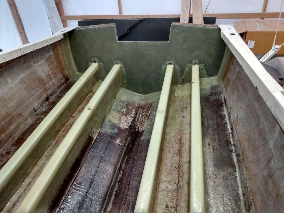

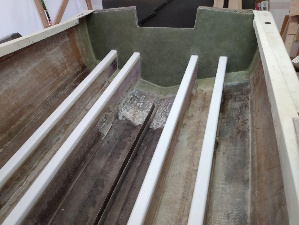

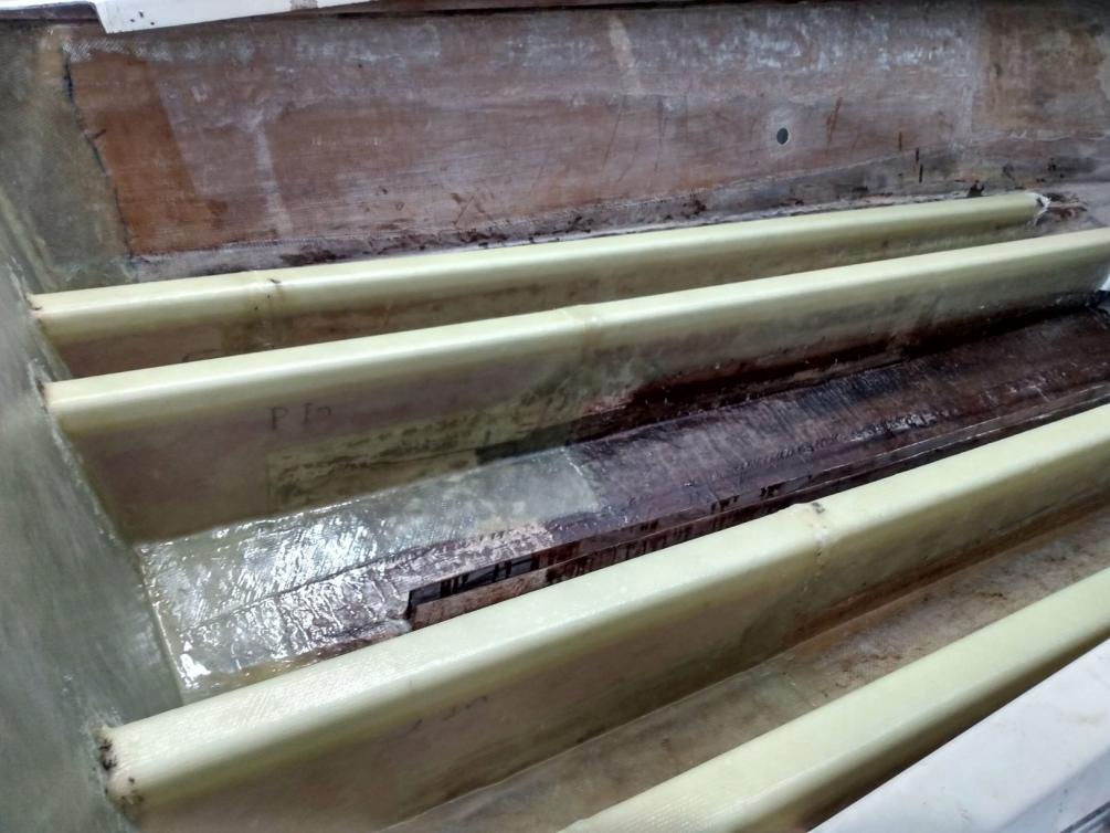

It took longer than anticipated, but that seems to be par for the course for me and working on the boat. The stringers are done with the foam insulation inserts to extend them to the transom, vinyl gutter downspouts on top to raise them 2" and add a conduit for wiring and 3 layers of glass covering. Very sturdy as I can stand on them with no flex.
I think my next task will be getting the cuddy squared away by filling in the existing one through hull hole and putting the original deck piece back in.
