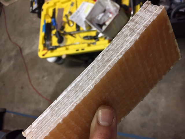

If you still have any scraps of demoed boat(the original side of the deck liner work great) you can stack them and use thickened epoxy to stick them together to make cheap G10.

Image to go with my last description.

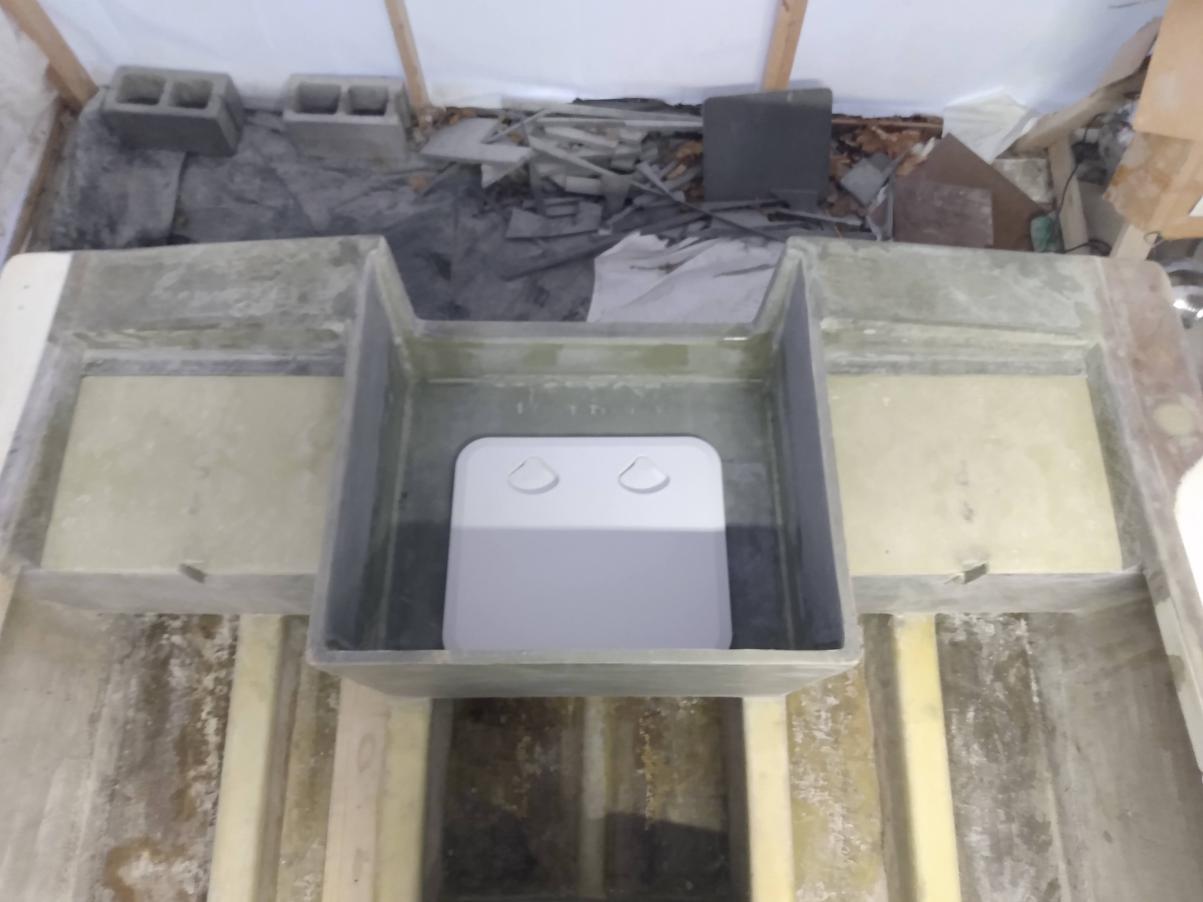

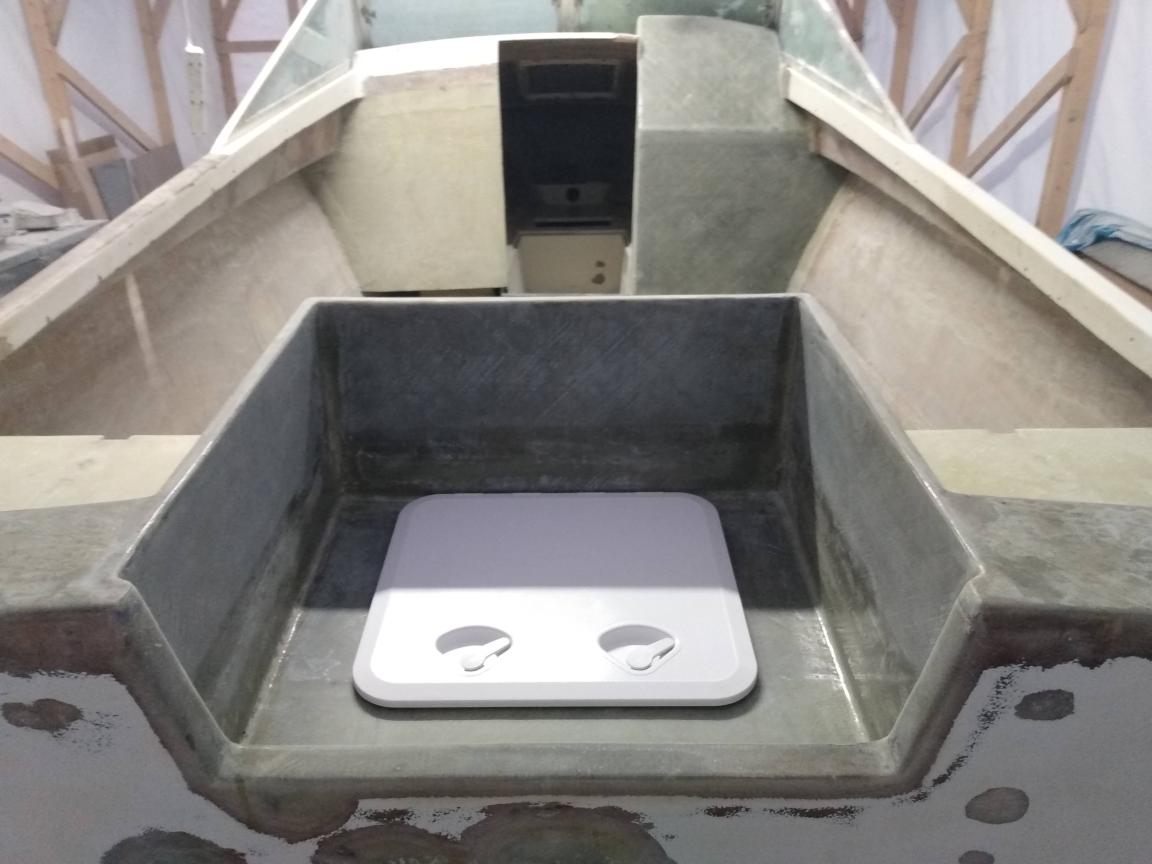

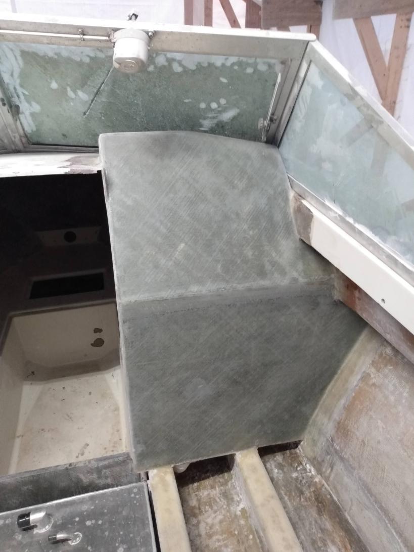

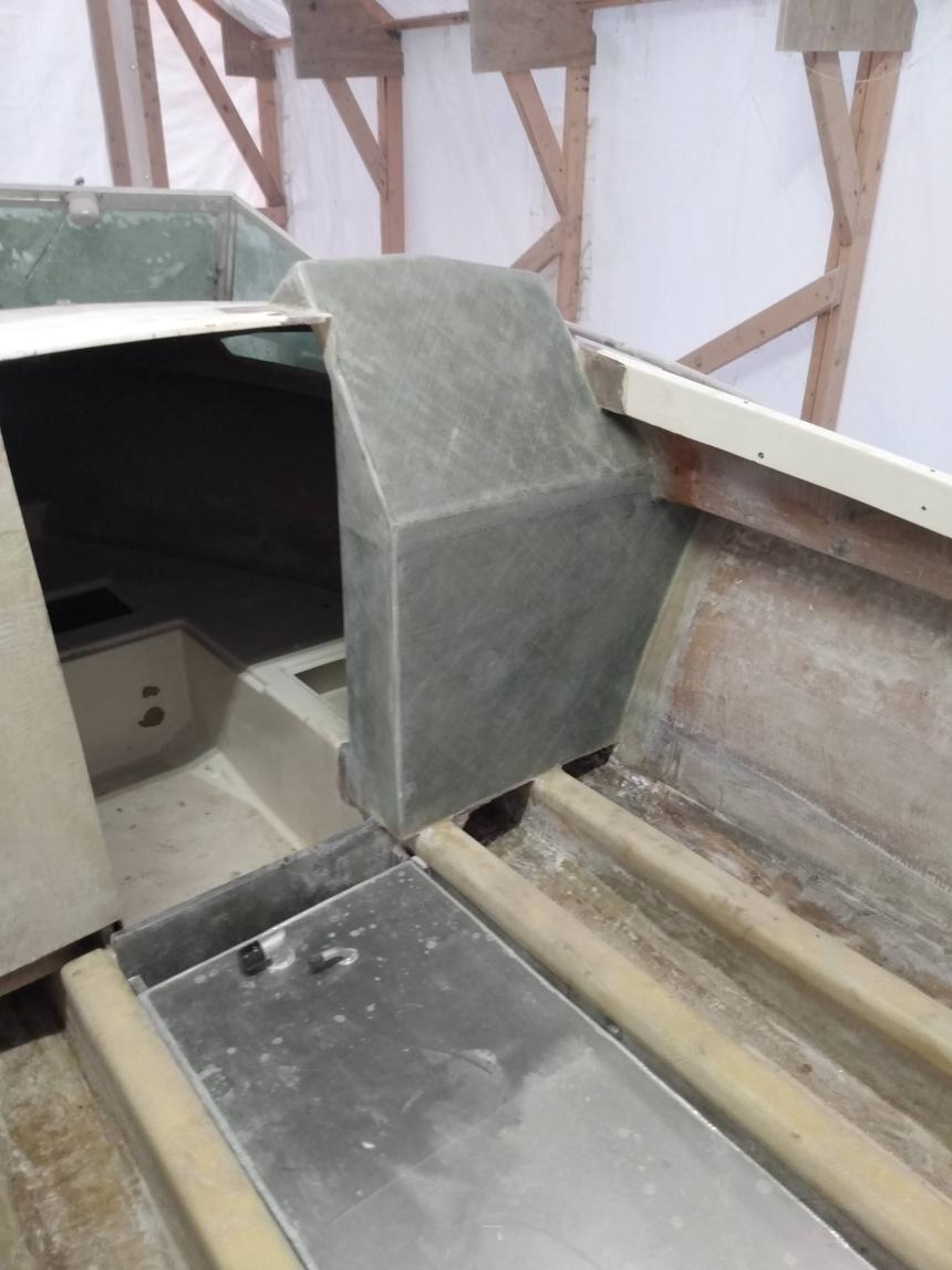

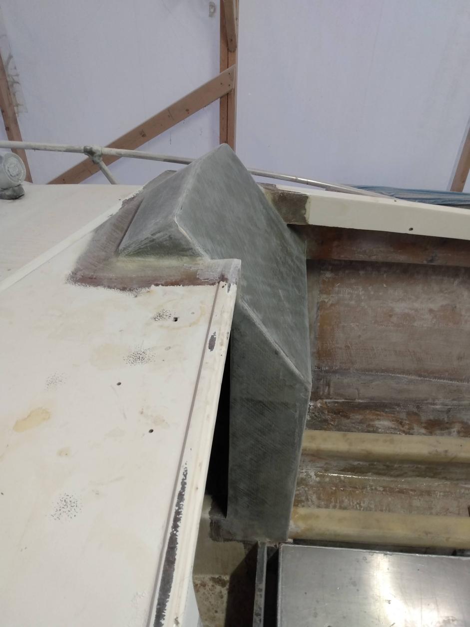

Some photos of my latest work now that winter is here and I won't be out there for a few months. The helm is a clean sheet ready for fairing, painting and components to be installed. Same for the splashwell as the purchased hatch cover is just sitting there. Seating is nice and tall making space for a 5 gallon bucket inside.

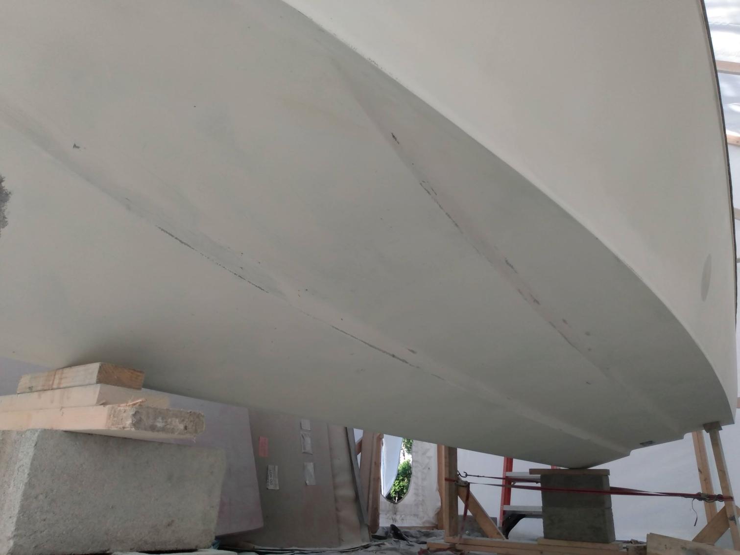

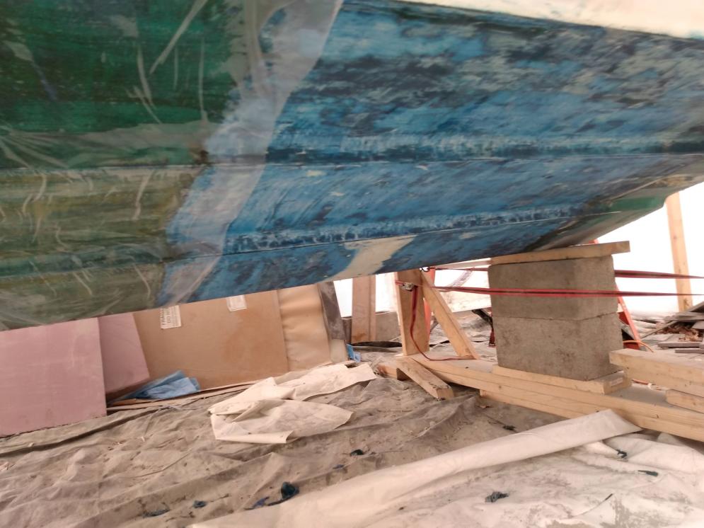

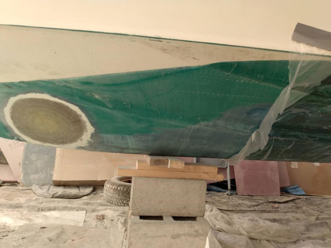

I am so happy winter is over and I have been able to get back to work. The last week and a half has been spent removing the bottom paint. I used the lye-corn starch method and was able to get 90% of the paint off this way. The rest was good ole sanding.
