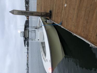

2008 Mercury Mag MPI 350 with 2008 Borg Warner transmission. *pictures below*

Default Photos
72’ sf
