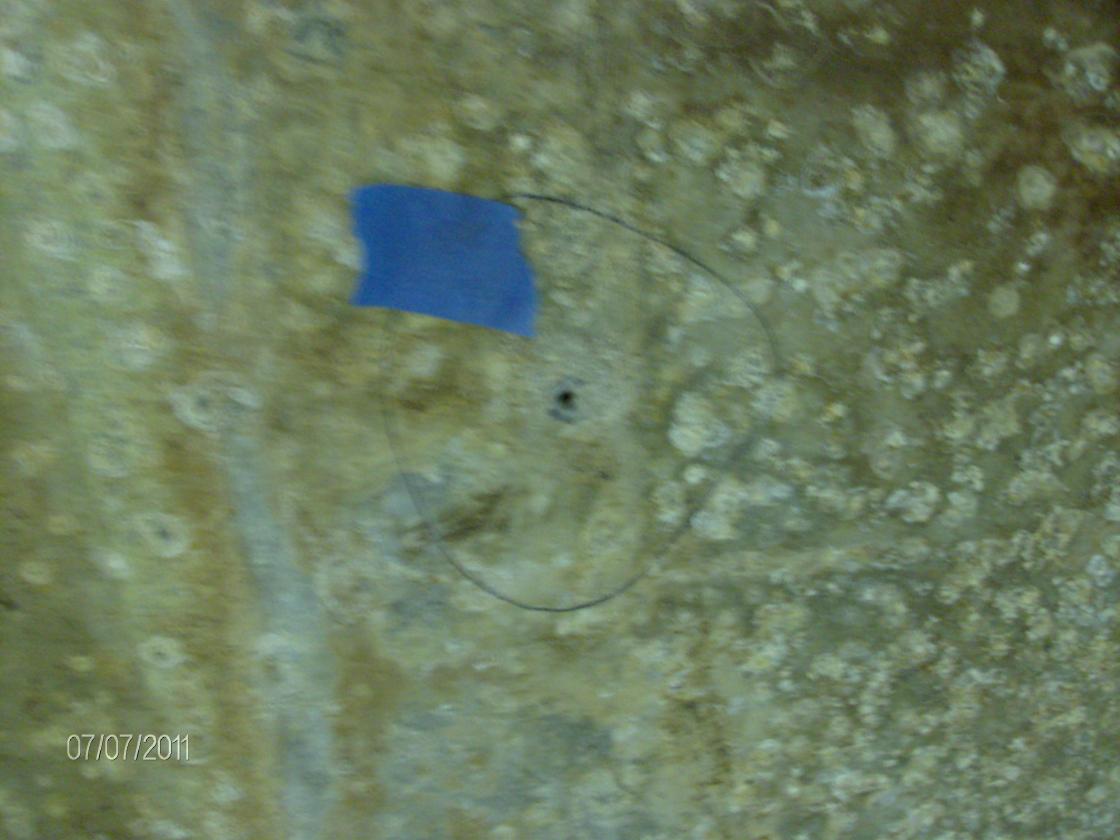

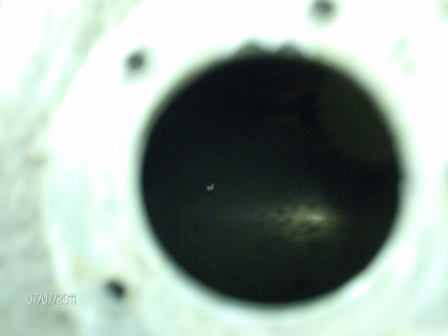

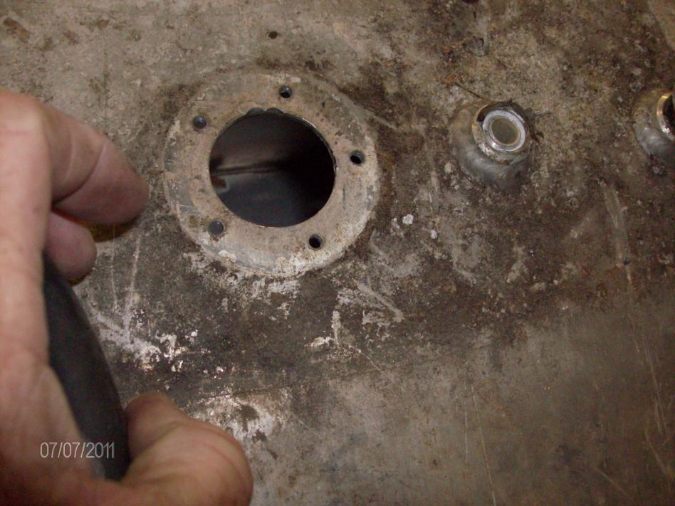

check out these pictures - this tank had 12 holes in the bottom - the client's complaint was a faint odor of fuel...
the pictures through the opening for the sender - that's not a spec - it's a hole,that's directly inline with the sender...
