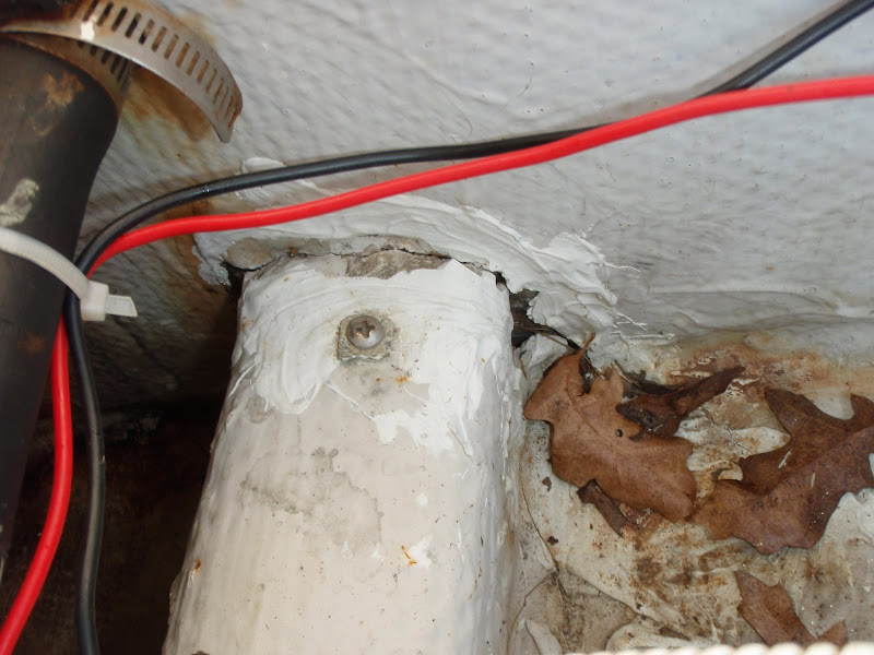

Thanks for all the input. An update. I haven't been able to do anything as far as getting her checked out yet since I have been traveling this whole month for work & commitments and won't have any time till after the 20th. I did have a buddy look at the transom and he thinks its solid for now, however, Im still goina have her checked out.
I think my plan of attack for now is to repair the separation in the stringer/transom with some fiberglass matte. Here is a photo. Any recommendations on the materials and procedures to make the repair? I have been following most of the rebuild threads in this forum and have a pretty good idea...

that does not look too good to me. i am no expert by any means but it looks like that stringer is completly seperaed from the transom.

5200 is amazing, but it has its limits!

....yea that 5200 repair job is courtesy of a previous owner.

Looks like a job for HERMCO!!
