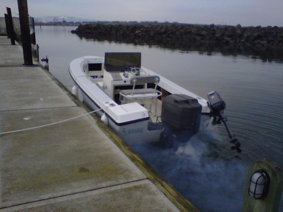

Old 06-02-2012, 10:09 PM
Chaser Chaser is offline
Join Date: Nov 2011
Posts: 64
Some low res pics with the Blackberry.
